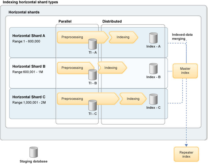

Indexing only horizontal shard types
Indexing only horizontal shard types results in all of the shards preprocessing at the same start time. They are run in parallel, independently of each other. After any of the shards completes preprocessing, it can immediately start indexing its preprocessed data into its own index core.
After all shards are indexed, an index merge command is triggered to merge all shard indexes into a single master index. Since all horizontal shards produce indexed data, the resulting merge works with indexed data for the master index.
The following diagram shows the process for indexing only horizontal shard types:Where:
  1. Shards, A, B, and C process different range sizes.
  2. All shards start preprocessing at the same time.
  3. Each of the shards writes into its own temporary tables. Due to the different range values, each preprocess completes at different time.
  4. Indexing of each shard starts immediately after its preprocessing task completes. Therefore, the indexing starts and ends at different times.
  5. After all the shards complete their indexing, a merge command is sent to merge the three different shards indexed data into the master index. Then, the data is replicated into the repeater index.

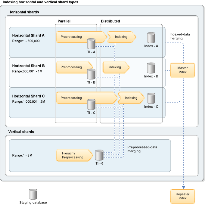

Indexing horizontal and vertical shard types
Indexing a mix of horizontal and vertical shards type is slightly different from indexing horizontal shards only. While the preprocessing of all shards can start at the same time, the horizontal shards indexing can begin only after all the vertical shards complete their preprocessing. The horizontal shards indexing scripts read data from both its own shard’s temporary table, and the vertical shard's temporary table.
The following diagram shows the process for indexing horizontal and vertical shard types:Where:
  • All shards' preprocessing tasks begin at the same time.
  • Horizontal shard B completes its preprocessing task, however remains idle until the vertical shard preprocessing completes.
  • After the vertical shard preprocessing completes, the indexing can begin.
  • The vertical shard has only a preprocess task, results in preprocessed data to be merged by the horizontal shards, in addition to their own preprocessed data. After the indexing tasks are complete, a merge command is sent to merge the horizontal shard's indexed data into the master index, then replicated into the repeater index.
