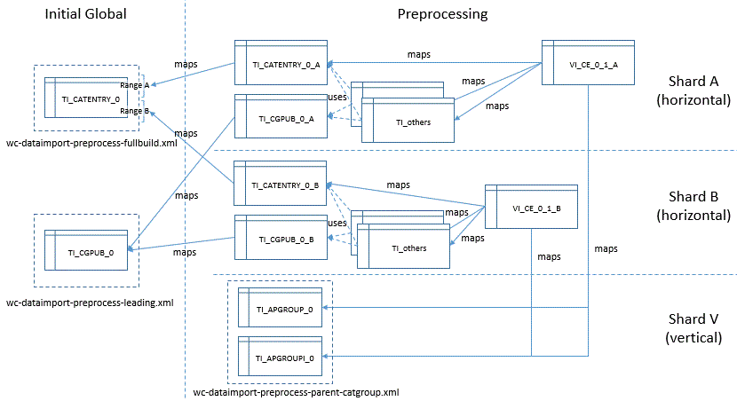

Using the example file, you can construct a sharding regime that works as follows:
In this example, two phases happen in the preprocessing run. In the first Initial Global phase, you process the TI_CATENTRY_0 and TI_CGPUB_0 database tables once, before any shards are processed. In the second, Preprocessing phase, Shards A, B, and V start their processing in parallel.
  • Before you perform the first Initial Global phase, ensure that the InitialGlobal directory referenced by Global.preprocessing-initial-global-table-dir contains the files wc-dataimport-preprocess-fullbuild.xml and wc-dataimport-preprocess-leading.xml. By default this is the directory /opt/WebSphere/AppServer/profiles/default/installedApps/localhost/ts.ear/xml/search/dataImport/v3/db2/InitialGlobal. It contains the files wc-dataimport-preprocess-fullbuild.xml.vertical and wc-dataimport-preprocess-leading.xml.vertical. Remove the .vertical extension from each file and ensure that they both contain CREATE TABLE statements for the TI_CATENTRY_0 and TI_CGPUB_0 database tables.
  • The TI_CATENTRY_0_A and TI_CATENTRY_0_B views use the FinalViewDataPreProcessor function to map to range A or B of TI_CATENTRY_0.
  • TI_CGPUB_0_A and TI_CGPUB_0_B are views that map to TI_CGPUB_0 (two aliases of it). Other temporary tables use TI_CATENTRY and TI_CGPUB in the normal way in each shard.
  • Both TI_APGROUP_0 and TI_APGROUPI_0 are processed in the vertical shard, so their names have no shard suffix.
  • The VI_CE_0_1_A and VI_CE_0_1_B definitions require the TI_APGROUP_#INDEX_SCOPE_NO_SHARD_TAG# and TI_APGROUPI_#INDEX_SCOPE_NO_SHARD_TAG# to refer to both the TI_APGROUP_0 and TI_APGROUPI_0 tables.
