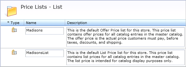

  5. View the two default price lists in Lab:
    1. Return to the Catalog Filter and Pricing tool.
    2. In the explorer view on the left, click the Price Lists folder.
      The two default price lists for the store display. For example, for the Madisons starter store, the two default price lists are shown here:
      Default price lists
    3. Read the information in the Description column.
      The prices you see on starter store pages are pulled from these two price lists using price rules. For example, for the Madisons starter store:
      • In the default Offer Price list named Madisons, the offer price for the Steamer Pot is $99.99.
      • In the default List Price list named MadisonsList, the list price for the Steamer Pot is $109.95.

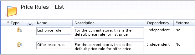

  6. View the two default price rules in Lab:
    1. In the explorer view, click the Price Rules folder.
      The two default price rules for the store display. For example, for the Madisons starter store, the two default price rules are shown here:
      Default price lists
    2. Read the information in the Description column.
    3. Double-click the row containing the Offer price rule.
      For example, here is the Offer price rule from Madisons:
      Offer price rule
    4. Notice that the price rule uses a Get Price From Price List action that specifies the name of the default Offer Price list you viewed earlier.
