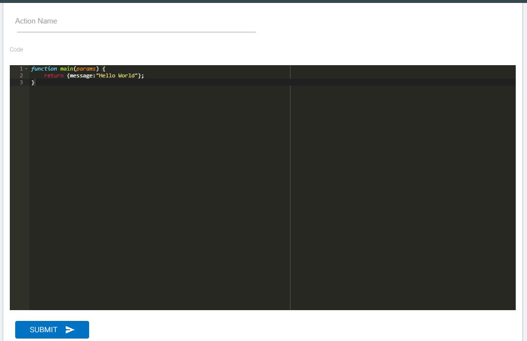

Create OpenWhisk Action
- Click the edit icon
at the bottom right of the
screen to bring up the create a New OpenWhisk Action page.
- Fill the Action Name and Code fields.
- Click the Submit button to save and create the action in IBM Cloud OpenWhisk space associated with your BigFix AEX Instance.
