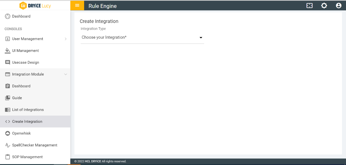

Create Integrations
- Click Create Integrations from the left navigation.
- This opens the Create Integration page.
Figure 2. Figure 22 – Integration Creation

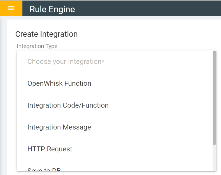

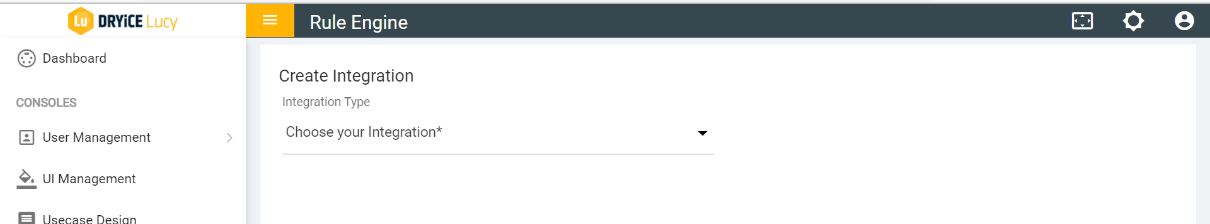

- Select Integration Type from the pull-down list.
Figure 3. Figure 23 – Integration Type Selection
The following type of Integrations are available for configuration.
Table 1. Table 2 Integration Types Integration Type Integration Purpose OpenWhisk Function With this Integration type, you can call an OpenWhisk function. Please see the section on OpenWhisk in this document to understand how to create functions in OpenWhisk. Integration Code/ Function In this Integration type, you can create custom internal functions. The function can be written in Node JS and the Integration Management back-end will execute it when you need the function. Your function should return a string as output to make the Integration work. See Output Type and various Output Styles to design the internal function. Integration Message In this Integration type, you can configure any custom message or response for an Integration Management response to provide the user with a fixed or pre-defined response. See Output Type and various Output Styles to design the correct response. HTTP Request In this Integration type, you can make HTTP requests, API calls, or HTTP request calls to an URL or endpoint. Sometimes, the use case requires integration with a third party or a customer enterprise system, which requires calling an API or endpoint with certain parameters or values to get relevant data as a response. Save to DB In this Integration type, you can create an Integration to save data in JSON format in the database, considering the database to be a NoSQL database. Any document you would like to save can be designed and saved using the parameters in the Parameters and Session Object fields. See Output Type and various Output Styles for more details. Read from DB In this Integration type, you can create an Integration to read or fetch information from the database by using the query parameters available in the Integration. See Output Type and various Output Styles for more details. - Selecting an Integration Type opens the Integration Creation form and populate fields based on the Integration Type selected.

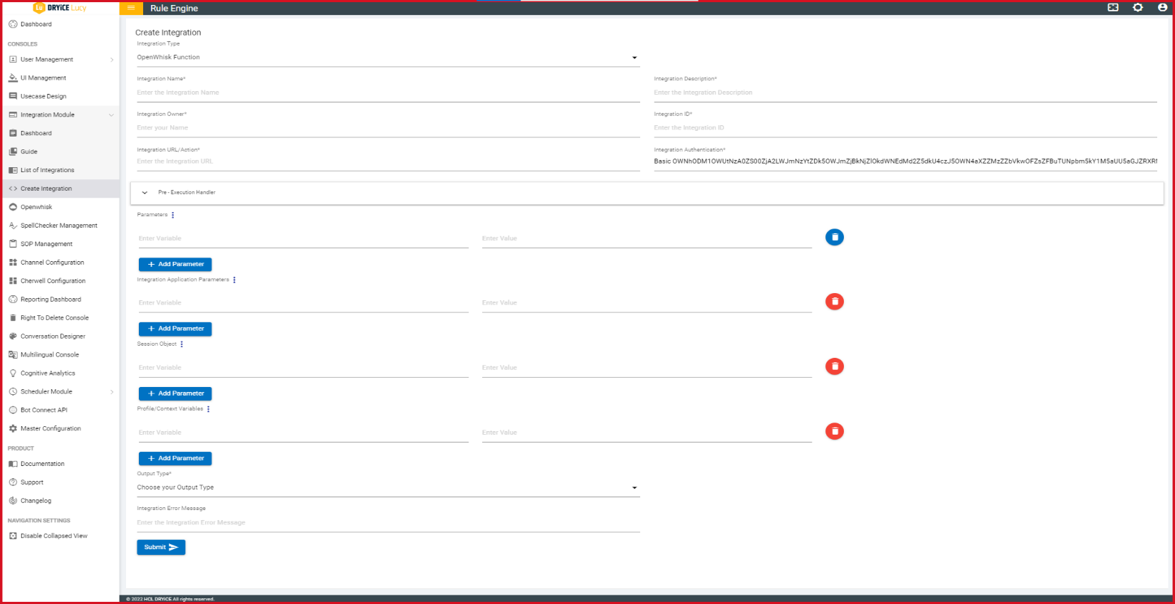

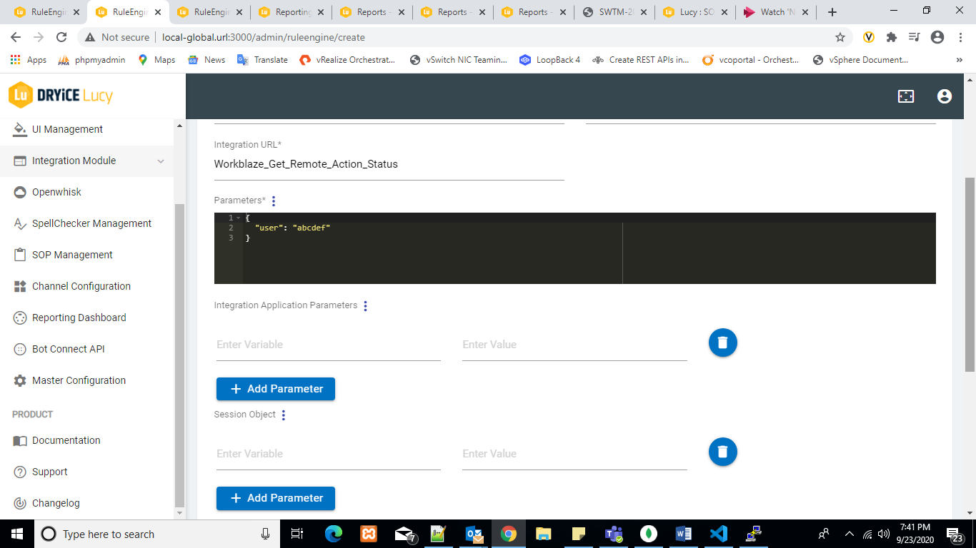

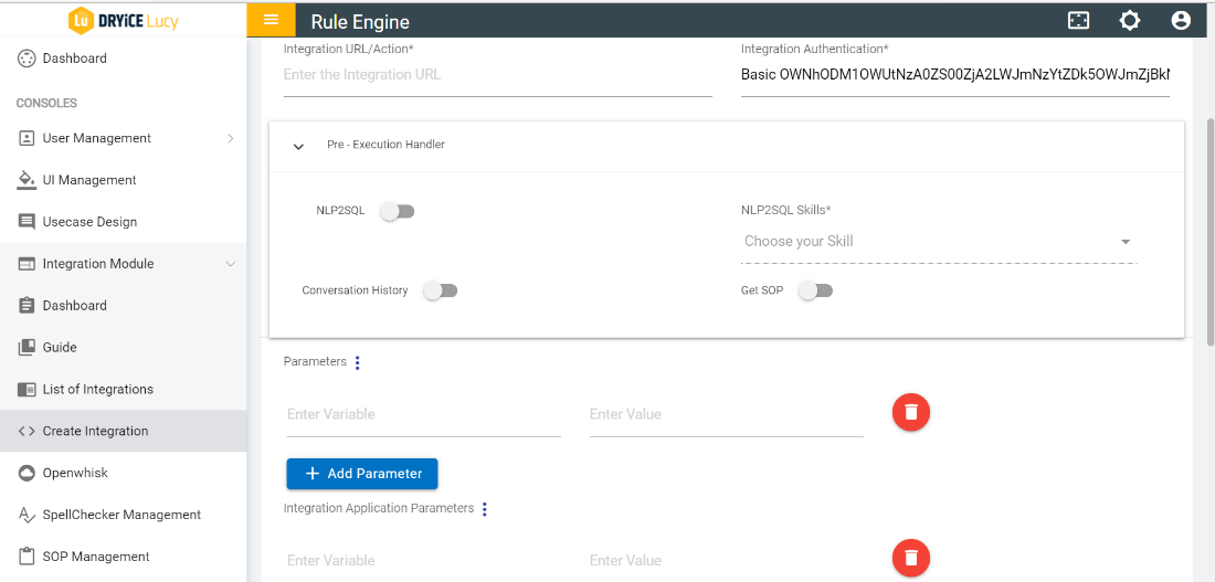

- A sample form containing the fields to be filled in is shown below.
Figure 4. Figure 24 – Sample Integration Creation Form
Refer to the table below to understand what to fill in the various fields based on the Integration Type.
Table 2. Table 3 Integration Fields Description Field Sub-Field Description Integration Name Name of the Integration that helps you remember the purpose of the Integration Integration Description Description of the Integration that provides some details on the Integration’s purpose and behavior Integration Owner Name of the user who is the owner of the Integration Integration ID Unique ID to identify the Integration. This ID is used while making a reference to the Integration in Watson Assistant. Integration URL URL that will be called by BigFix AEX to execute the Integration in case of OpenWhisk and HTTP Integration types. For OpenWhisk, you can get the URL from the OpenWhisk action list covered in OpenWhisk Module. Integration Authentication A unique basic AUTH token, which is a base 64 encoded string generated for OpenWhisk and HTTP Integration types by default to authorize a particular Integration. Please do not change the value generated in this field and use it as such. Parameter Any parameters you would like your Integration to possess or to send over to OpenWhisk or internal function, mention them as the Integration Parameters in Integration Creation page. The parameters should be in JSON or Object format with key value pairs.
For example: If you want to pass 2 parameters called URLStatus and URLCreate with their values, you can write the following in this field:
{“URLStatus”: “https://www.urlstatus.com”,
“URLCreate”: “https://www.urlcreate.com”}
If you would like to add any parameter whose value has to be fetched from the application like Session Value, then use '$' and then write the entire parameter you would like to access. You will have access to all parameters from Watson Assistant or session to use with. For example, to access the session variable username, you can use:
{'username: $session.username'} This will create a param called “username” and fill it with the value of username variable from the session.

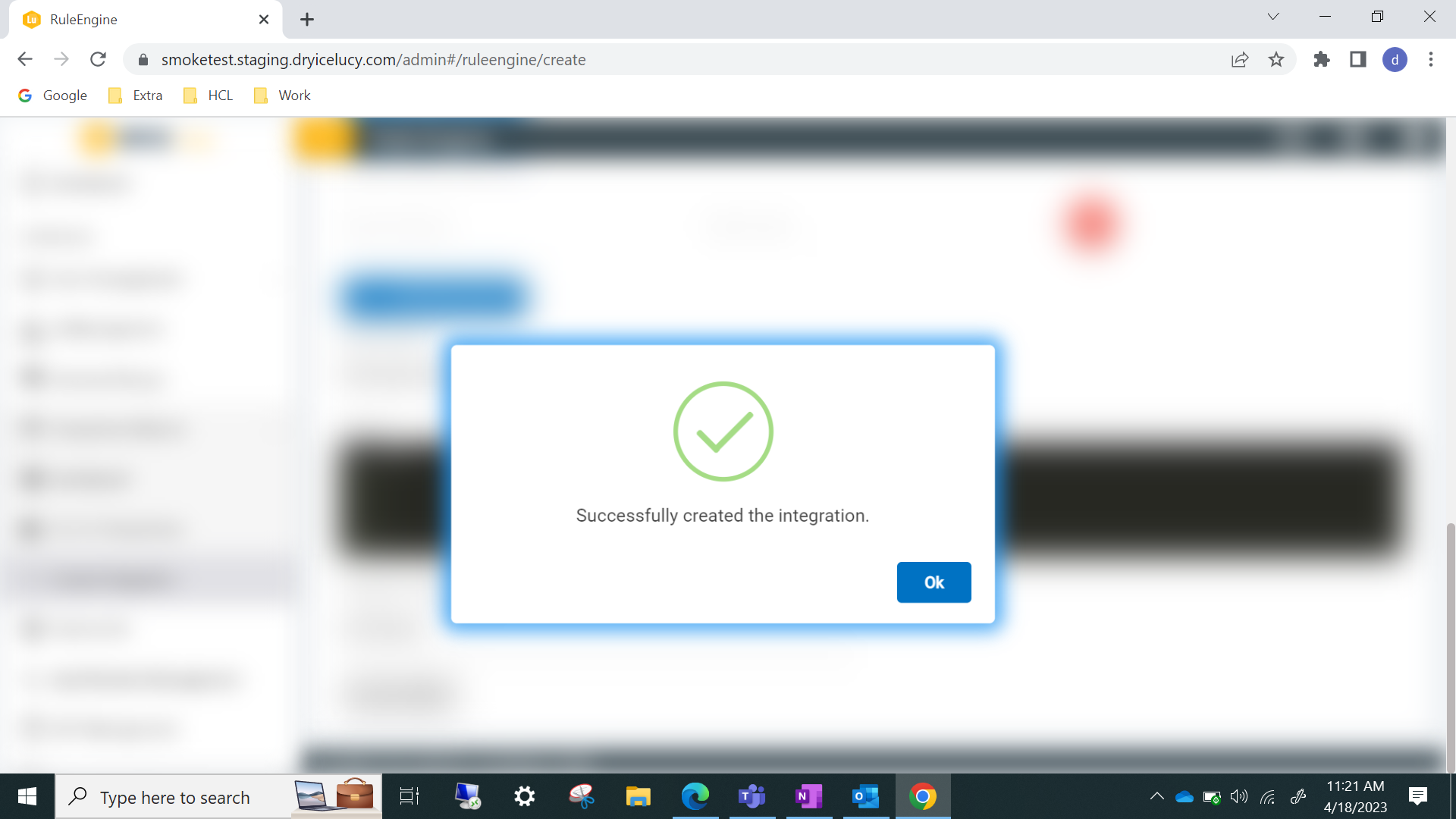

- Click Submit to add the Integration to the Integration repository of the Integration Management .
- The newly added Integration can be seen in the List of Integrations shown in Figure 23 – Integration Type Selection .

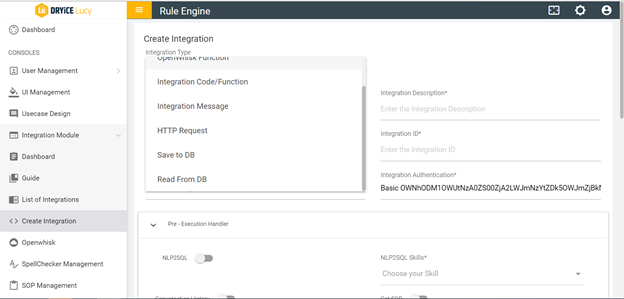

The form editor functionality on the Create and Edit page of Integration Module is to give a form like field apart from the json editor so that user can add data in the fields. Now there are two editors: JSON editor and Form editor, both are dependent of each other. Whenever there is any change on any of the editor, it will reflect on another.
On Create Integrations page when Openwhisk function is chosen, autocomplete has been implemented on Integration URL field which will get all the openwhishk functions available on a tenant and if anything is selected, Integration Authentication field becomes invisible.
After submitting the form successfully, it will route to the List of Integrations page.

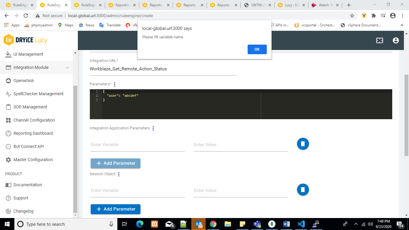

If add parameter button is clicked before adding a variable to the first row, then it gives an alert.
