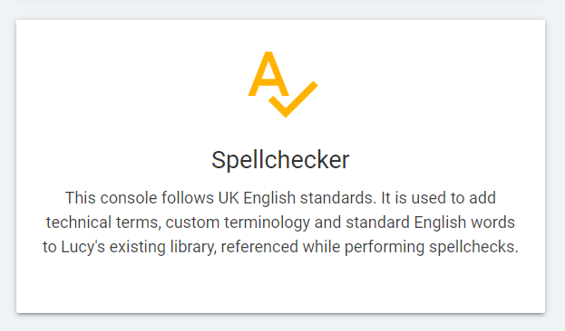

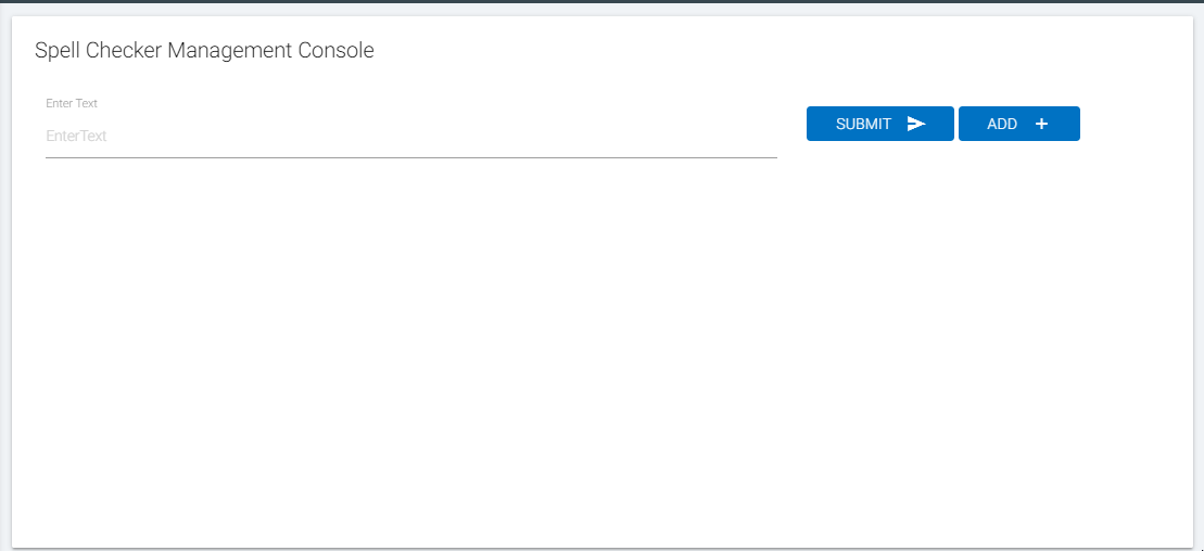

- From Cognitive Console home page, click the Spell Checker module.
- This opens the Spell Checker Management Console.
Figure 2. Figure 74 - Spell Checker Management Console
- To add or check words or phrases, use Enter Text input box.
- Click the SUBMIT button and the word or the phrase is checked against BigFix AEX’s repository.

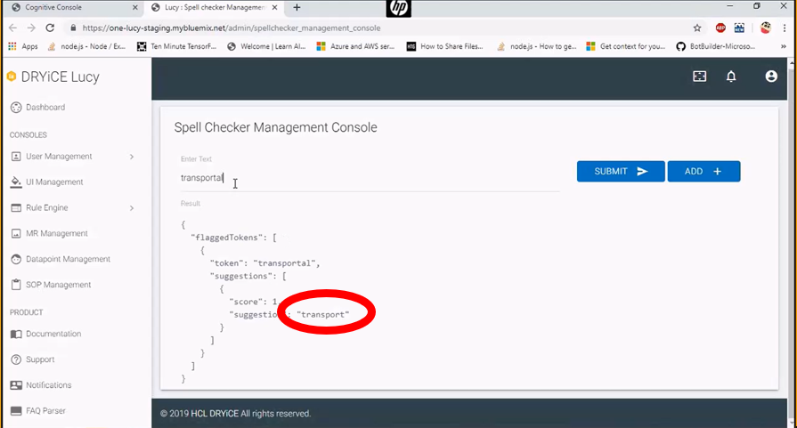

- If a word doesn’t exist in the repository, it would
suggest the most probable word.
Figure 4. Figure 76 - Spellchecker Management Console: Spell Check Test 2

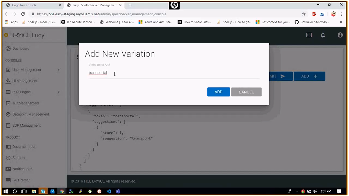

- To add it as an exception word (organization specific acronyms
or technical words) to the library, click
button.

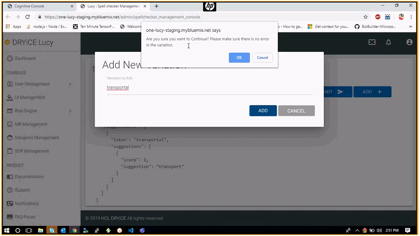

- The Add New Variation pop-up appears.
Figure 5. Figure 77 - Spellchecker Management Console: Add New Variation
- Enter the word that you want to add to the library (e.g. transportal) and click the ADD button.
Be careful while adding a new variation. You should not add the wrong word. If added, it may corrupt the library. Avoid adding proper names (John, Akash, Michael etc.) to the library.
- When prompted for the confirmation before adding a variation , click OK to commit or click CANCEL to discard changes.
Figure 6. Figure 78 - Spellchecker Management Console: Add New Variation Confirmation

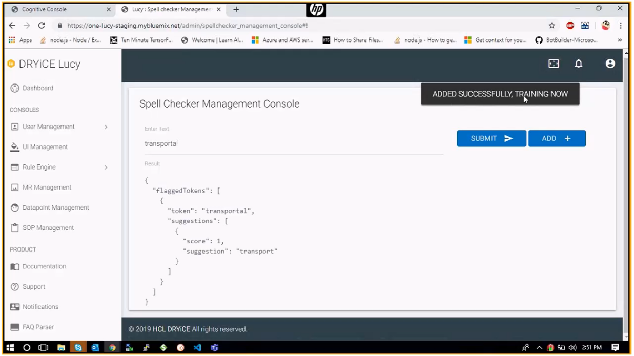

- After the successful addition of the word, the user gets a confirmation message.

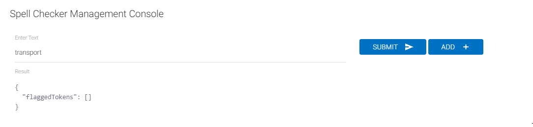

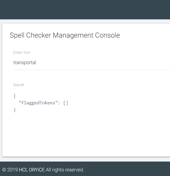

The system needs time (anywhere between 10 seconds to 1 minute) to train and disseminate on the new words or phrases.
- Now you can try if the word has been added or not. If successfully added, the system will not come up with any recommended words. This is depicted in the screenshot below.
