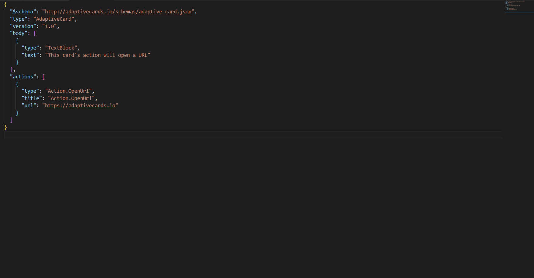

- Example:
Figure 1. Figure 374 – Example Code (Action.openURL)

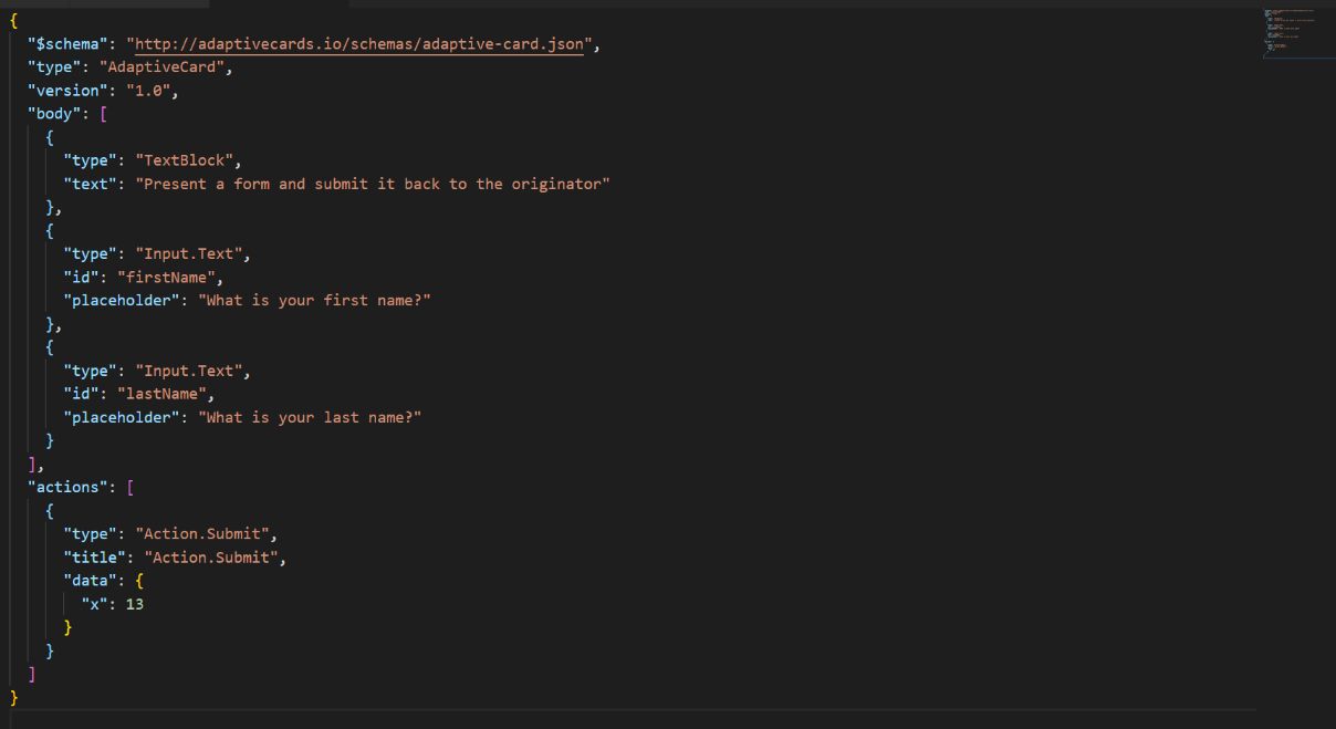

- Example:
Figure 2. Figure 375 - Example Code (Action.Submit)
Figure 3. Figure 376 - Example Code (Action.Submit) (Cont.)

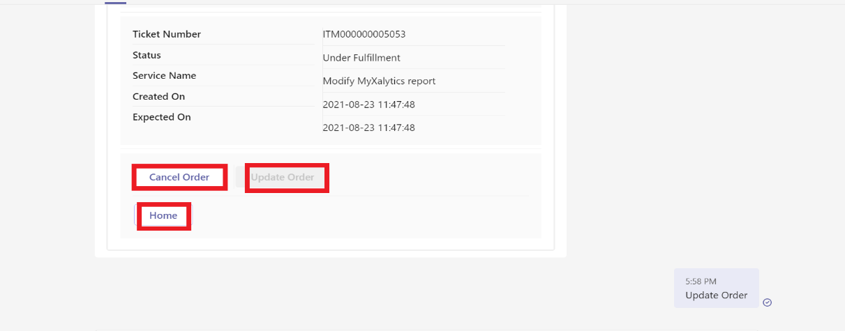

Figure 4. Figure 377 - Teams UI Action.Submit Example

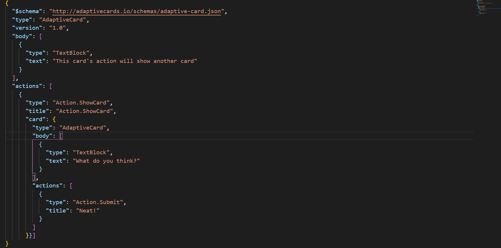

- Action.ShowCard – Properties:
- Card: The Adaptive Card to show. Inputs in ShowCards will not be submitted if the submit button is located on a parent card. It is of type AdaptiveCard. Allowed values are: Adaptive Card.
- Title: It is a label for button or link for action. It is not a required property and of type string.
- iconURL: It is the optional icon to be shown on the action in conjunction with the title. It is not a required field and of type uri.
- Id: A unique Identifier associated with the action. It is not a required property and of type string.
- Style: It controls the style of an action, which influences how the action is displayed, spoken, etc. It is of type ActionStyle. It is not a required property. Allowed values are default, positive and destructive.
- Fallback: It will tell what to do when an unknown element is encountered or the requires of this or any children can't be met. It is not a required value. It is of type Action and Fallback Option. It is supported in version 4.2. Allowed values are Action.Execute, Action.OpenUrl, Action.ShowCard, Action.Submit, Action.ToggleVisibility and drop (Causes this element to be dropped immediately when unknown elements are encountered.)
- Tooltip: It defines text that should be displayed to the end user as they hover the mouse over the action and read when using narration software. It is of type string and supported in version 1.5. It is not a required property.
- isEnabled: It determines whether the action should be enabled. It is of type Boolean and supported in version 1.5
- mode: It determines whether the action should be displayed as a button or in the overflow menu. It is of type ActionMode and supported in version 1.5. Allowed values are primary and secondary.
- Example:
Figure 5. Figure 378 – Example Code (Action.ShowCard)

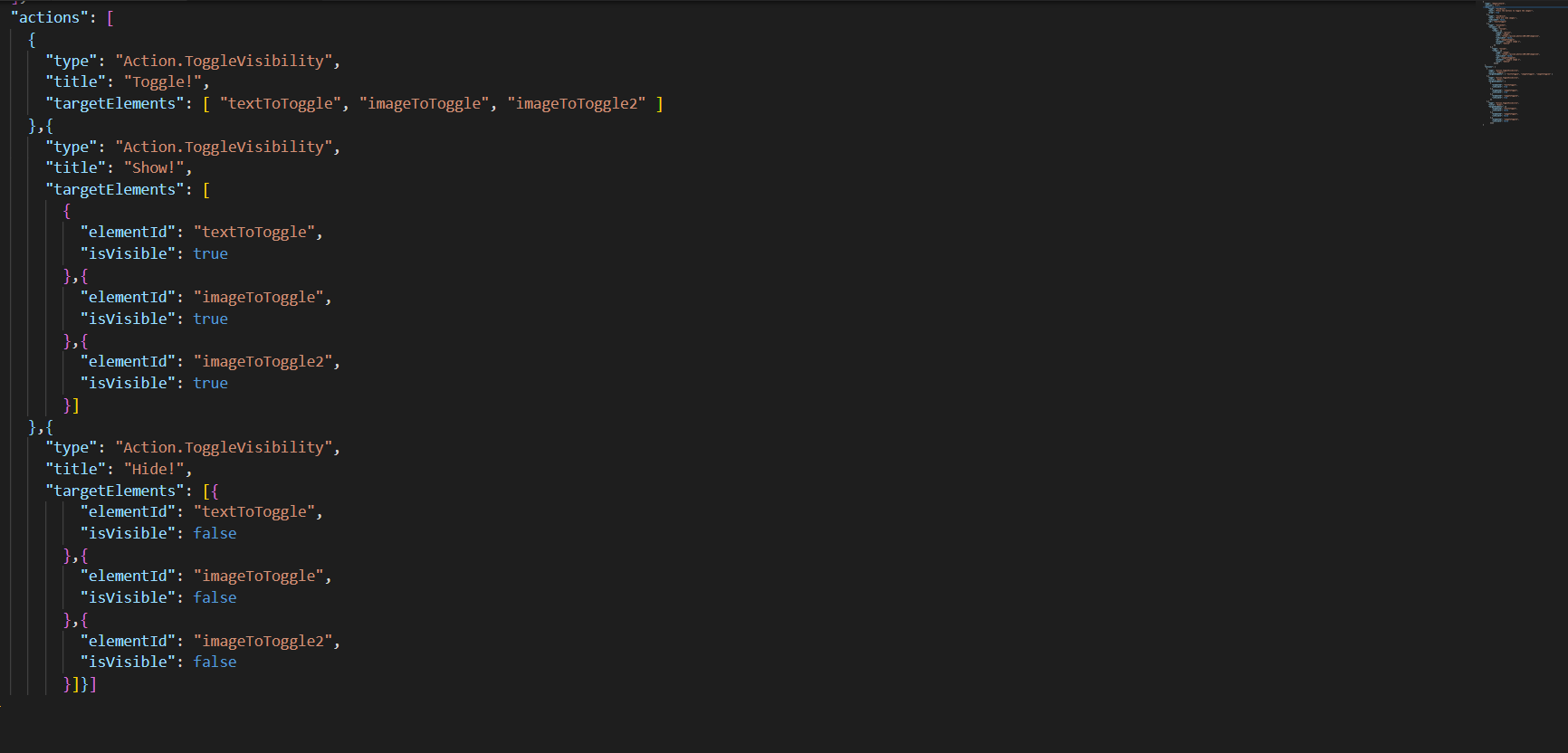

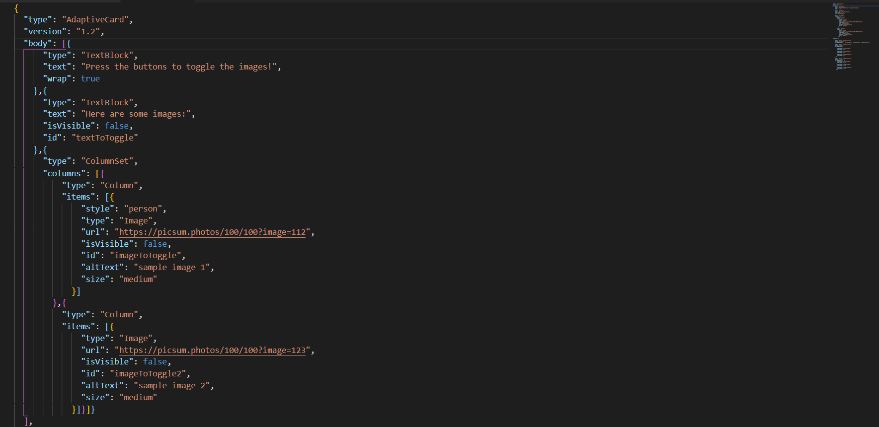

Figure 6. Figure 379 – Example Code (Action.ToggleVisibility)
Figure 7. Figure 380 – Example Code (Action.ToggleVisibility) (Cont.)

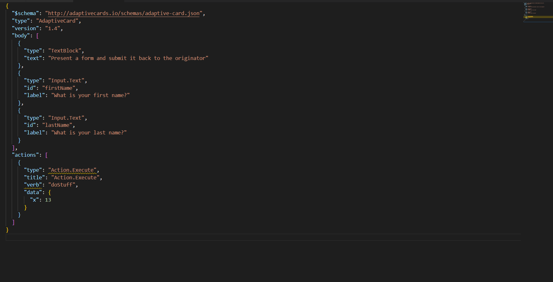

- Action.Execute – Properties:
- Verb: The card author can define verb associated with the action. It is of type string and not a required property.
- Data: Initial data that input fields will be combined with. These are essentially ‘hidden’ properties. It is of type string or object and not a required property.
- associatedInputs: It controls which inputs are associated with the submit action. It is of type AssociatedInputs and is not a required property. Allowed values are auto and none. Default one is auto.
- Example:
