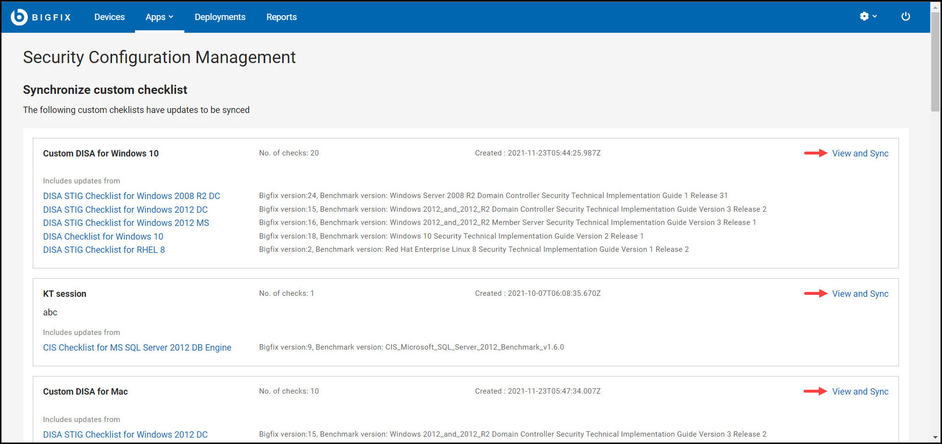

Navigate to the SCM App landing page and click
Sync.
Click View and sync on any checklist to sync.

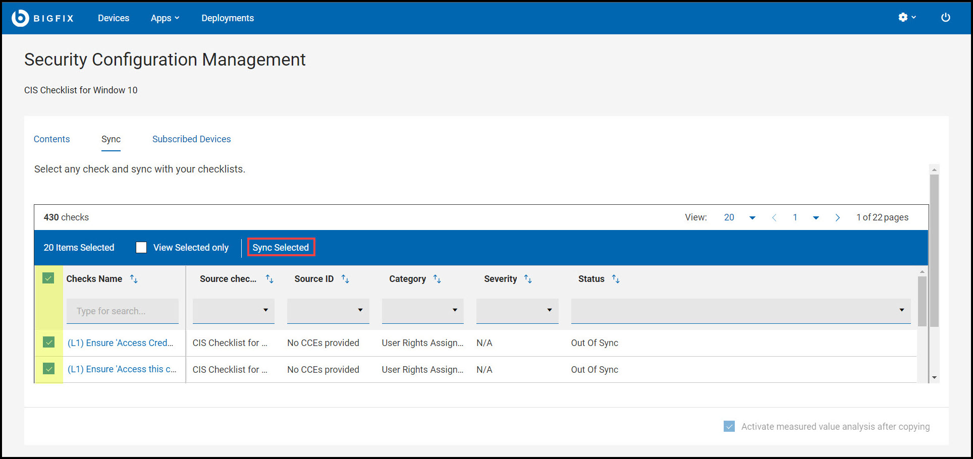

The Synchronize custom checklist page gives an overview of the checklists that are to be synchronized.
Select the required Check or use the select
all option to select all available checks and click
Sync Selected.
Attention: Currently you cannot synchronize checks of multiple status (Added, Removed, and Out of Sync) together. For example, if you synchronize checks with Added and Removed status, only checks with Added status will be synchronized. We recommend you to filter checks based on any one of the status and perform synchronisation. -

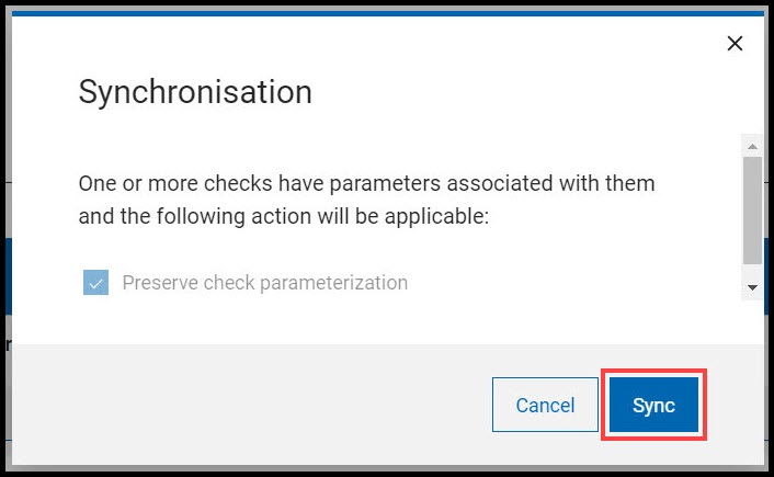

If a selected check has no associated parameters, the synchronisation starts.
If the checks have associated parameters, you are prompted with the following
dialog box:
- Click Sync.
