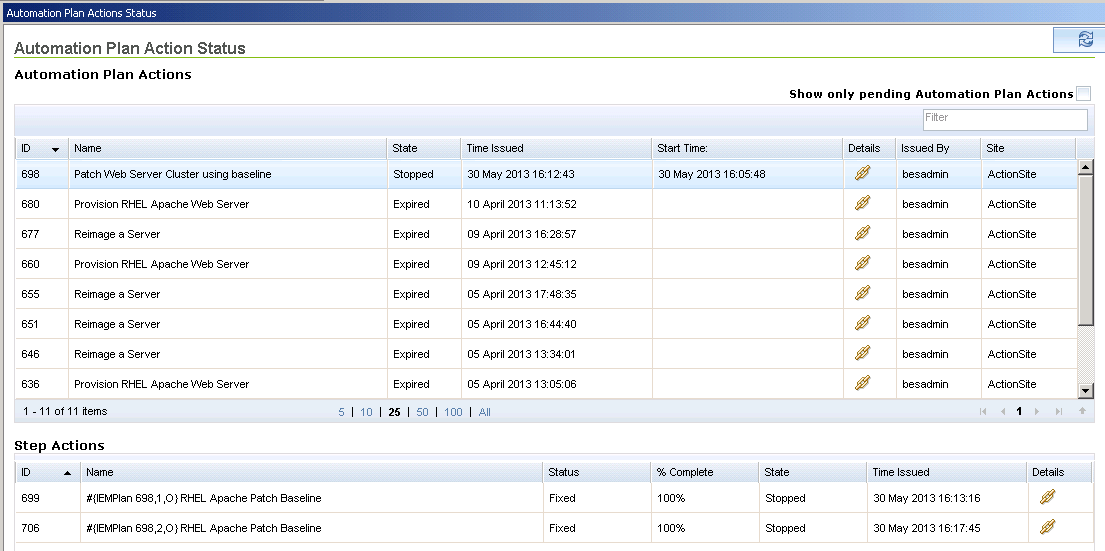

- Open the Server Automation domain.
- From the navigation tree in the Domain Panel, click Automation Plan Action Status. The Automation Plan Action Status panel is opened. A list of all Automation Plan actions, with the most recent Automation Plan action first, is displayed in the upper pane. To sort the list, click any column title. To filter all columns in the list, use the filter field.
- To view the IBM BigFix console Action panel for an Automation Plan action, click the Details value of the Automation Plan action in the list. To return to the Automation Plan Action Status panel, click Back in the menu bar.
- To display the step actions in an Automation Plan action, select the Automation Plan action in the list. The lower pane displays the step actions for the selected Automation Plan action.
for a step action, click
the Details value of the step action in
click Back in the menu bar. The following graphic
shows an example of the Automation Plan Action Status dashboard.
