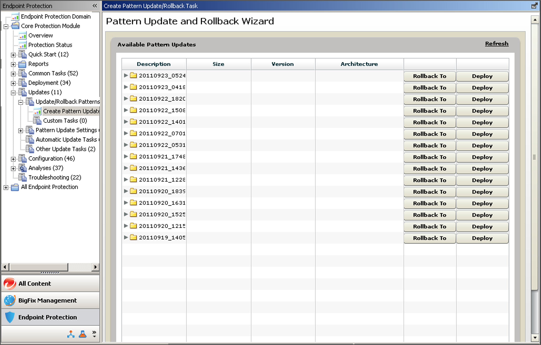

- From the IBM BigFix Console, click Endpoint Protection on the lower-left pane.
- From the upper-left navigation pane, go to Core Protection Module > Updates >
Update/Rollback Patterns > Create Pattern Update/Rollback Task. The Pattern
Update and Rollback Wizard opens.
- In the list of folders that appears, click the ">" icon to expand and display the pattern file version that you want to roll back to.
- Click the Rollback To button across from the folder. In the pop-up window
