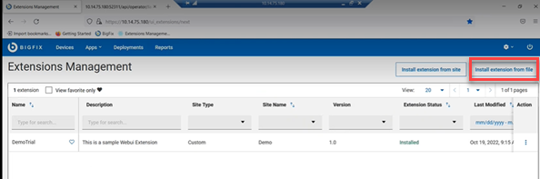

- Log in to WebUI with appropriate credentials.
- From the menu bar, click Extension Management.
Click Install extension from file.

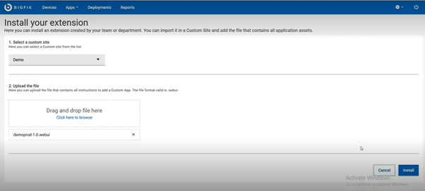

- Select a custom site where the extension will be installed.
Upload the file that contains all instructions to add a custom app. The valid
file format is .webui.
- Click Install.
- Once the extension is successfully installed, a success message is displayed and the extension is listed on the Extension Management grid.
