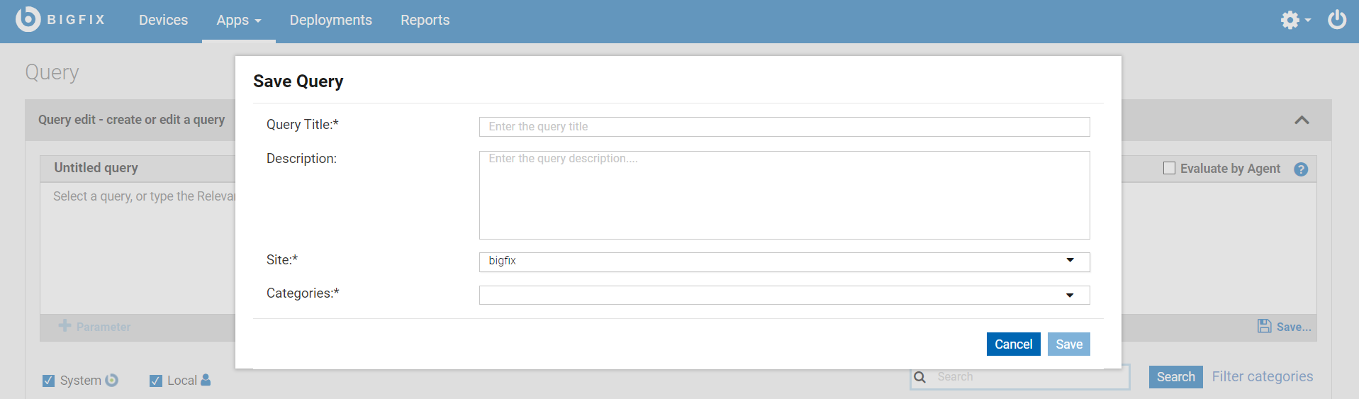

- Click Save.
- Enter a descriptive title for the query.Note: It is recommended to keep the query title short up to a maximum of 23 characters. If the query title is longer than that, the title is truncated on the title tab.
- Select a site that you are allowed to access and host the query on.
- Specify at least one category for the query.
- If you specify more than one category, the query appears in all the specified categories.
- If you enter a new name in the Categories field, a new category is created.
- Click Save.
