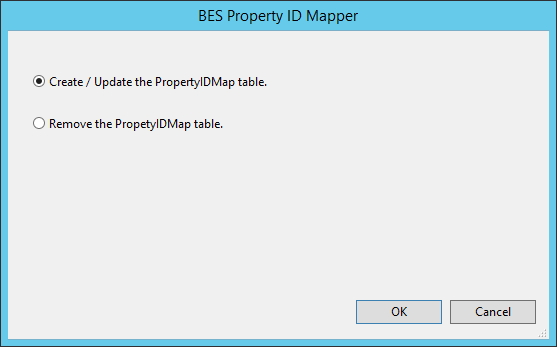

After creating or deleting a property, click Run Now in the
BES
Property ID Mapper section:
The following window is displayed to create, update, or remove the PropertyIDMap table:

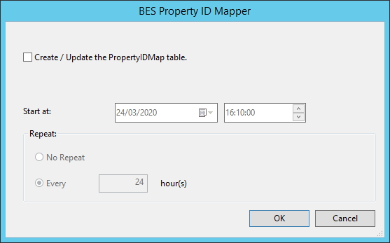

To automate the process of creating or updating the PropertyIDMap table, you can schedule the
process by clicking Schedule in the
BES Property ID Mapper section of the
BigFix Administration Tool.
