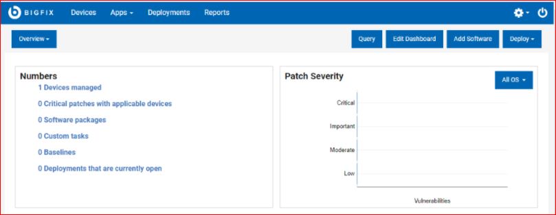

- Log in into WebUI by using your Master Operator
credentials.
The WebUI home page is displayed.

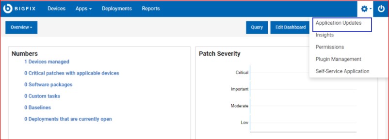

- Click the gear icon in the navigation bar and select
Application Updates.
The Application Updates page is displayed.

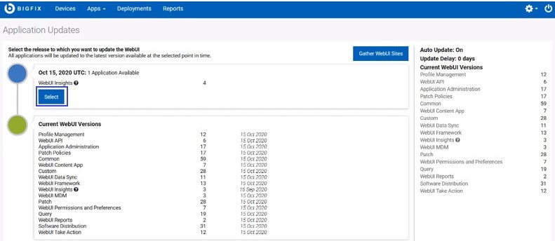

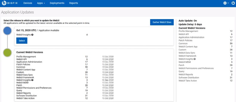

The Application Updates page notifies you about the available application updates. The version number of the available update in the update notification is different (and higher) than the current WebUI versions that are displayed under the Current WebUI Versions pane.
credentials.
Click Select.

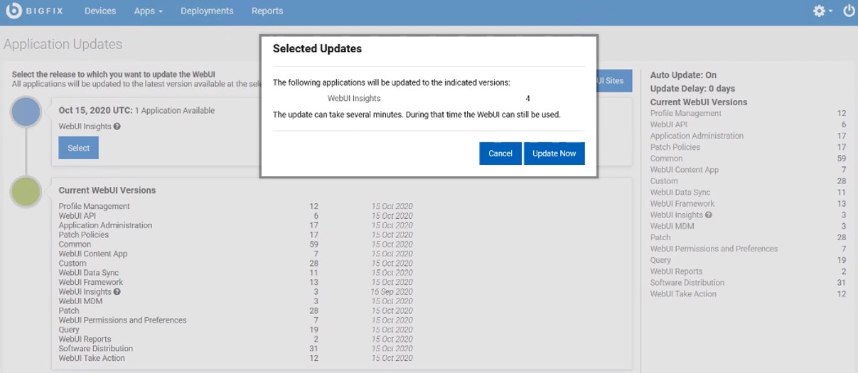

The Selected Updates dialog opens.
Click Update Now to confirm the update or click
Cancel to exit the update.
The update begins and is completed in the background. You can use the current WebUI interface during the update. After the update is completed, you will be using the latest version when you log in to the WebUI interface the next time.
