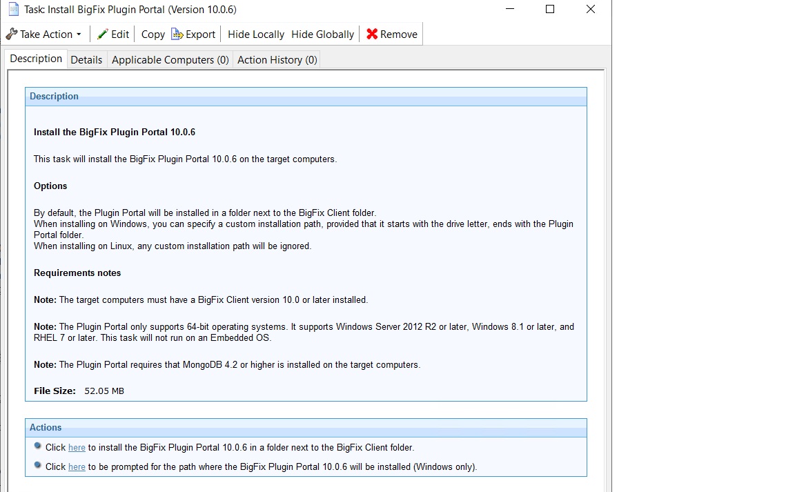

To install the Plugin Portal on a BigFix Agent, run the Task named Install BigFix Plugin Portal (Version x) from the BES Support site. This Task installs the BigFix Plugin Portal version x.x on the selected targets.

Starting from BigFix 10.0.5, when installing the Plugin Portal on Windows, you can specify a custom installation path that starts with a drive letter and ends with the Plugin Portal folder. When installing the Plugin Portal on Linux, any custom installation path is ignored.
Starting from BigFix 10.0.9, in the Plugin Portal Installation Fixlet, the MongoDB service is no longer checked as a prerequisite for the installation.
