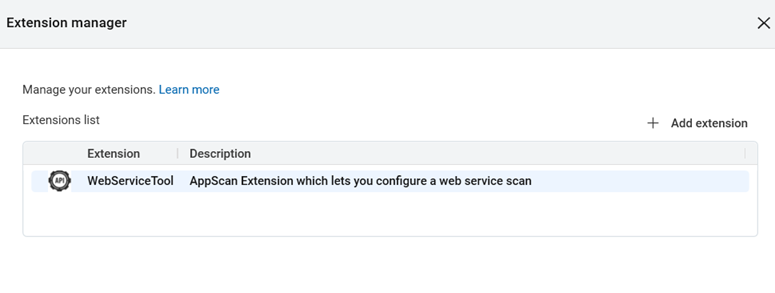

Extension manager window displaying the extensions list
