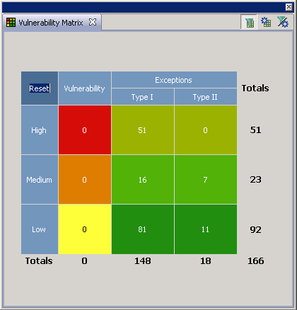

An example of these changes can be seen in the Vulnerability Matrix view.
Vulnerability Matrix view in versions of AppScan Source prior to Version 8.8

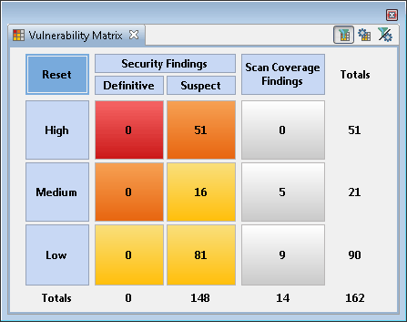

As of Version 8.8, the view looks like this:
Vulnerability Matrix view in AppScan Source Version 8.8
