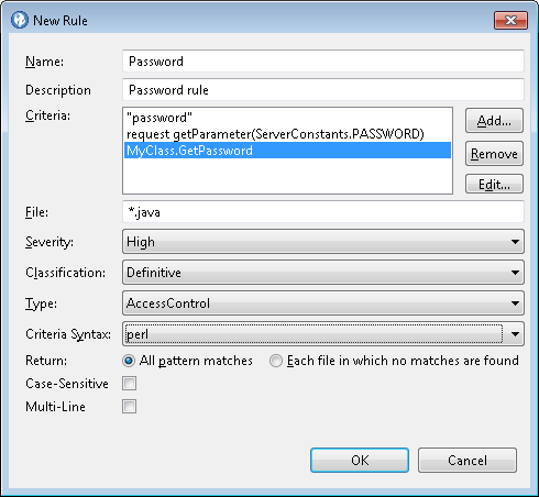

Rules are created in the New Rule dialog box:

  1. In the New Rule dialog box, Name the rule.
  2. Optional: Add a Description for the rule.
  3. Add the Criteria. Click Add and type the regular expression for each rule.
  4. Identify the file type, such as *.java or *.xml. You can type any file type with or without wildcard characters.
  5. Optional: Select the Severity:
    • High
    • Medium
    • Low
    • Info
  6. Optional: Select the Classification:
    • Definitive
    • Suspect
    • Scan Coverage
  7. Optional: Select the vulnerability type to search for in the scan. (For more details about vulnerability types, see the AppScan® Source Security Knowledgebase)New Rule dialog box
  8. Optional: Select the criteria syntax:
    • egrep
    • grep
    • perl
  9. Optional: Identify if the results returned include All pattern matches or Each file in which no matches are found. When no matches are found, the pattern is an absence rule.
  10. Optional: Select the Case-Sensitive check box if the pattern match should be case-sensitive.
  11. Optional: Select the Multi-Line check box if the rule should match a pattern that spans across multiple lines.
  12. Click OK to verify that the regular expressions in the rule are valid. The rule is then added to the pattern rule library.
