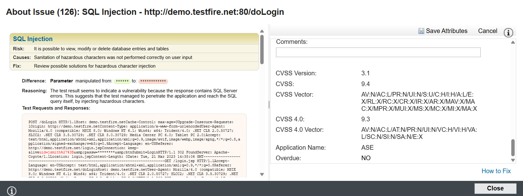

  2. Click Edit Attributes in the About this Issue dialog.
    If the Restrict access to modify Severity value and CVSS attributes permission is selected for your user type you cannot modify the Severity value and the CVSS attributes of an issue. Contact your product administrator.
  3. If the Base metrics (Attack Vector, Attack Complexity, Privileges Required, User Interaction, Scope, Confidentiality Impact, Integrity Impact, Availability Impact) display as unknown (blank), select a value for each of them.
    In this screen capture, the CVSS Base metrics are unknown, there is no CVSS score, and the issue severity is High.

    You can only modify CVSS 3.1 attributes. The CVSS 4.0 Score and CVSS 4.0 Vector attributes are read-only. When you change Base metrics or CVSS attributes, AppScan Enterprise recalculates both CVSS 3.1 and CVSS 4.0 scores. However, the Severity value (High, Medium, or Low) comes only from the CVSS 3.1 score. An information icon on the Issues page shows that the severity is based on CVSS 3.1.
    The About this Issue dialog for an issue.
  4. Change the Severity Value to Use CVSS.
    If you only change the Severity Value but you don't change the Base metrics, the issue is categorized in the issue list as Undetermined, which means that the severity formula cannot accurately calculate the severity because information that it uses in its calculation is missing.
