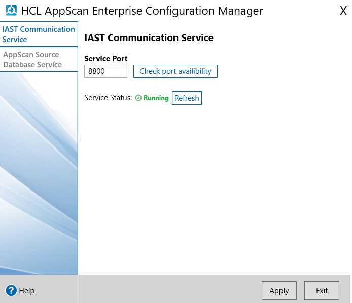

The
HCL AppScan Enterprise Configuration Manager dialog box
having the
IAST Communication Service section is displayed.
Configure the IAST service properties as described in the following table:
| Fields | Action |
| Service Port |
Enter the port number of the machine where you want to install IAST service. |
| Check port availability |
Click this option to validate whether the port is available for installing the IAST
service.Depending on the port availability, you can see the following options:
- Port available - Indicates the port is available for installing the IAST service.
- Port unavailable - Indicates port is not available. Hence, you must try entering another
available port number for IAST service.
- In use - Indicates a port number that is already utilized by an IAST service.
| Service Status |
Indicates whether the service installed on this port is Running or Not running. |
| Refresh |
Click Refresh to know the latest status service running on the port. |
| Apply |
Click to apply the configuration changes for running the IAST service and communicate with
AppScan Enterprise application. |
| Exit |
Click to exit the configuration manager. |
