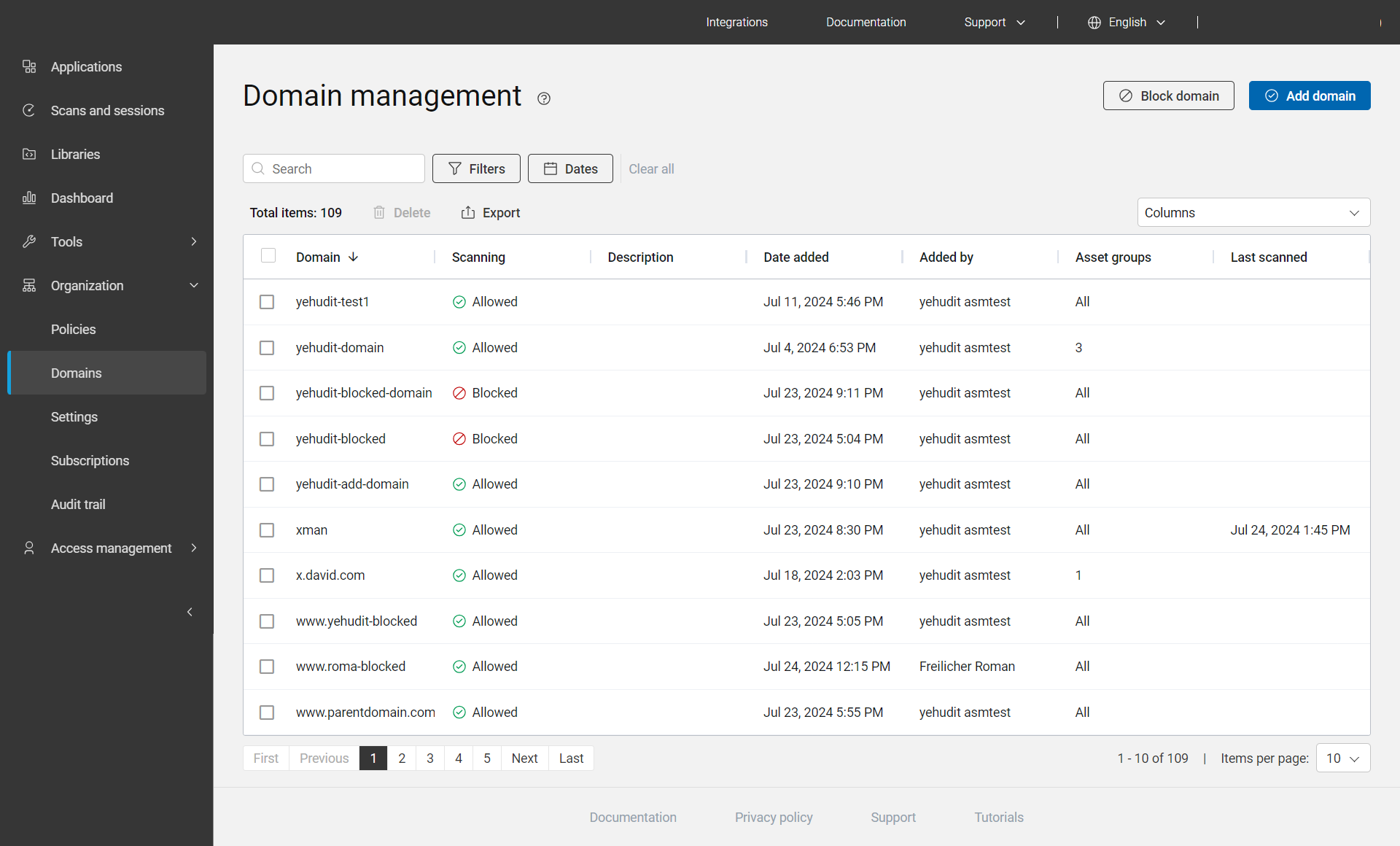

Domain management
Domain management allows organizations to manage their domains, control permissions for various asset groups, and authorize domains without verification.
Note: Administrators can view and manage all domains and templates on the management screens. However, an administrator, like any other user, can scan a domain or use a template only if they are associated with the target application's asset groups.
Table 1. Domain page items and options
Item or option Description
Add domain Click to add a domain to the allowed list.
Block domain Click to block a domain.
Search Search all table content for strings.
Filters To filter the list of domains displayed, click Filters and filter by: Scanning or Asset groups or both.
To remove all applied filters, click Clear all.
Dates Select a date range for the list by Last scanned or Date added.
Columns
  • Click a column header to order entries.
  • Drag-and-drop column headers to change the order of the columns shown.
  • Add columns by clicking the Columns drop-down list.
  • Remove columns by clearing the checkboxes in the Columns drop-down list.
Domain name Name of the domain or IP address added to either allow or block for scanning. By default, the table is sorted based on Domain name in descending order, displaying subdomains under the parent domain.
Scanning Indicates whether scanning is allowed or blocked for the domain.
Description Description of the domain.
Date added Date when the domain was added.
Added by Name of the user who added this domain to the list.
Asset groups Indicates the number of asset groups assigned to the domain. If "All" is displayed, it means the domain is assigned to all asset groups in your organization; if a number is shown, it means only specific asset groups are assigned to the domain.
Last scanned Date when the domain was last scanned. The date is not populated for existing organizations, until a new scan is run.
Export Export the full or filtered table as a CSV or JSON file. Only users with the appropriate permissions can export.
Delete Delete the selected domains from the list. Once deleted, these domains cannot be scanned anymore, and any scheduled scans using these domains will fail. Only users with the appropriate permissions can delete a domain. To resume scanning, the domain must be re-added to the allowed list.
