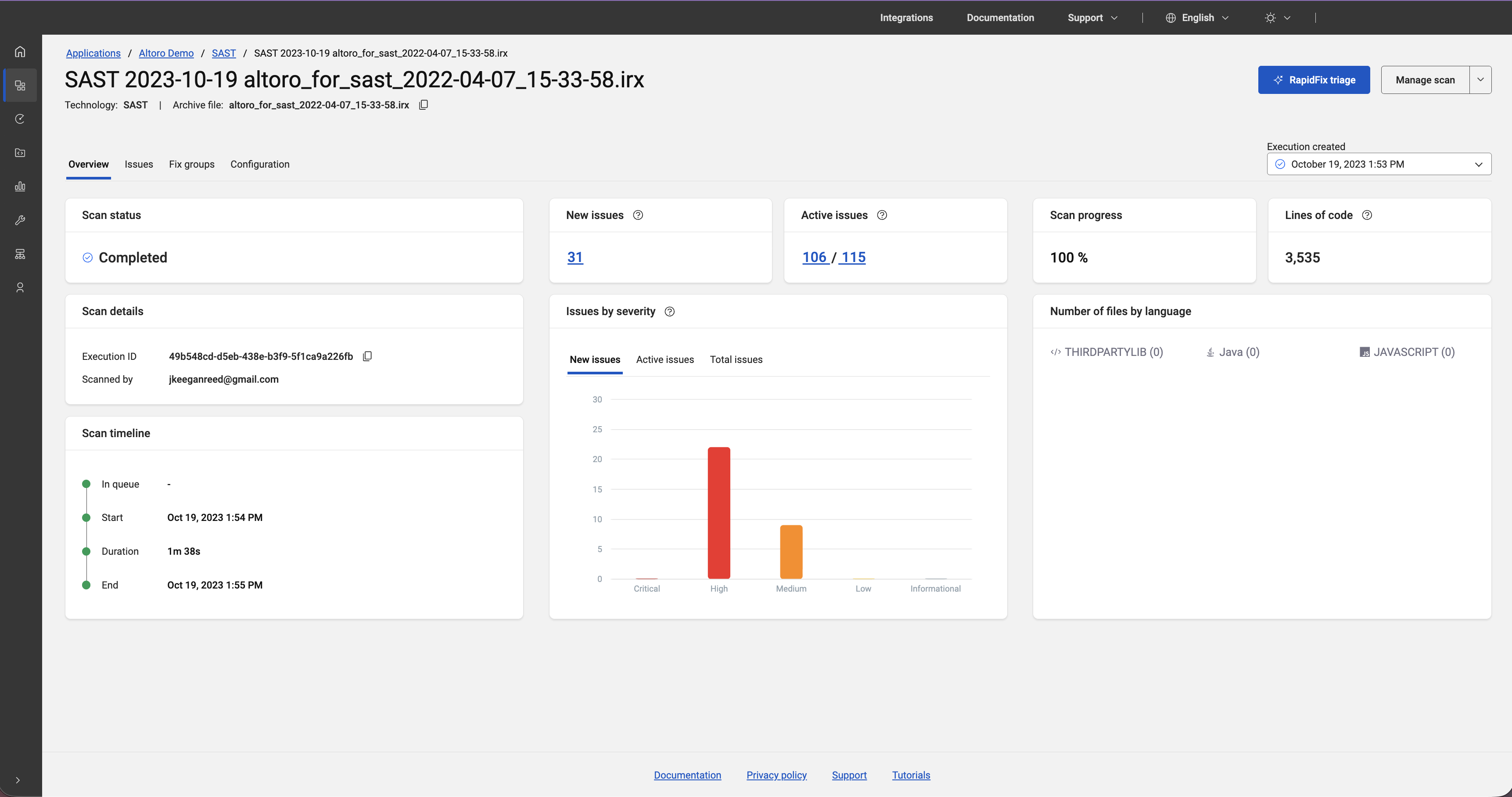

  • Click RapidFix triage from the single scan view of a static analysis (SAST) scan, then click Learn more on the resulting dialog box. AppScan 360° opens a new browser window from which you can request more information from the HCL sales team.

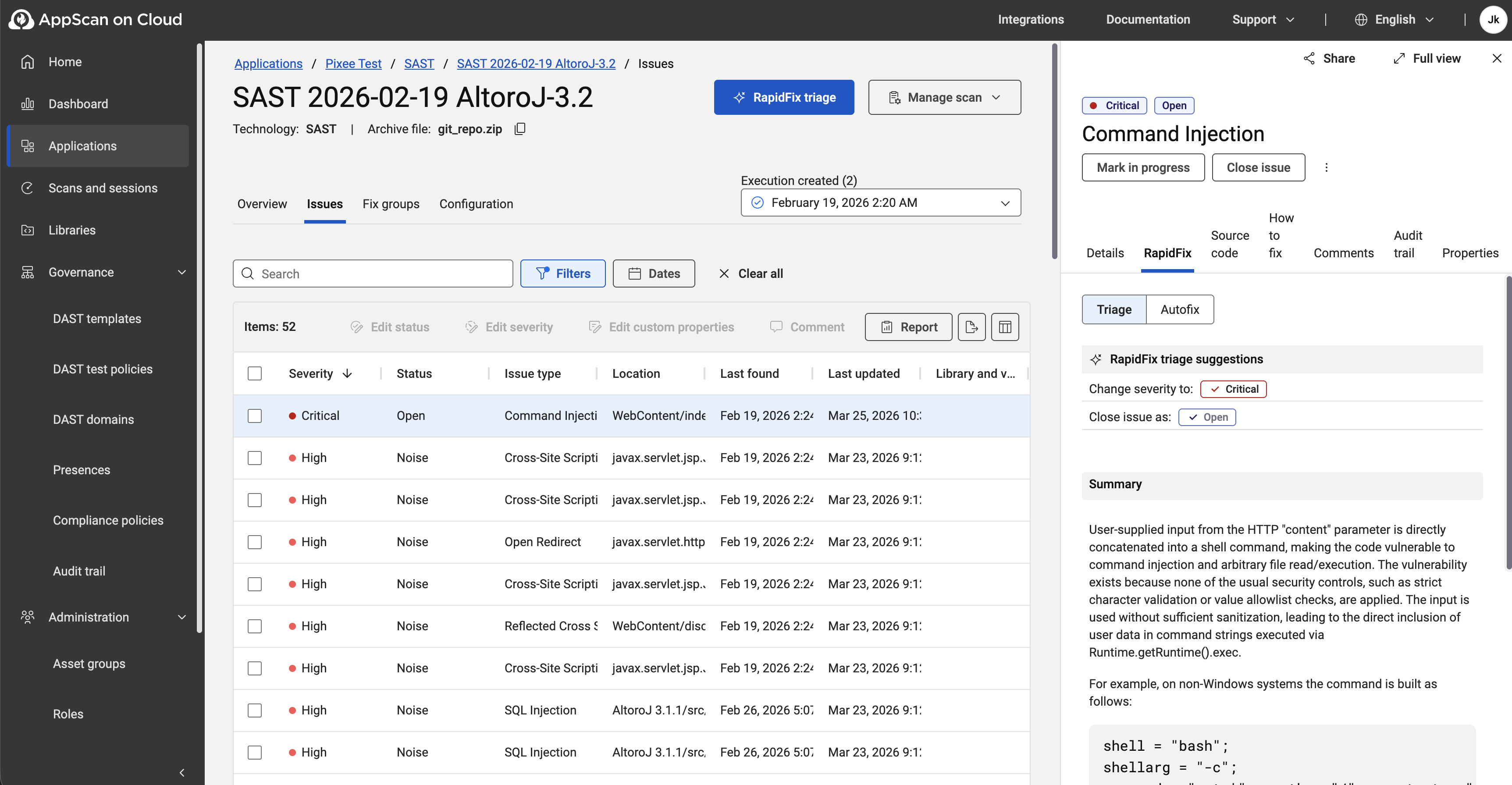

When RapidFix is subscribed and configured, results that have been analyzed automatically by RapidFix are indicated in the following ways:

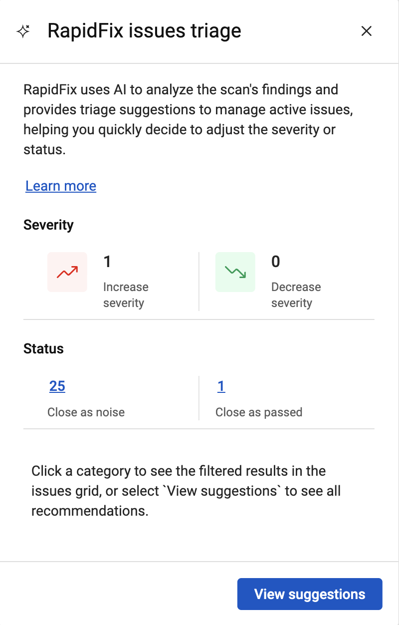

  • Clicking RapidFix triage from the single scan view shows a summary of RapidFix findings. Click View suggestions to go to the Issues page.Click View suggestions to go to the Issues page.
  • The RapidFix icon () displays for a scan on the Scans and sessions page.
  • The Issues page for the scan displays two new columns, RapidFix autofix and RapidFix triage.
    • RapidFix autofix indicates if an autofix is available for the issue.
    • RapidFix triage notes the results of AI analysis of the issue.
      Note: If you decide to ignore the triage suggested by RapidFix, this noted in issue audit trail as RFIgnoreTriage.
    Click the issue to open the Issue information pane to learn more.
  • A new tab – RapidFix – on the Issue information pane for the scan allows you to review the findings and take action.
