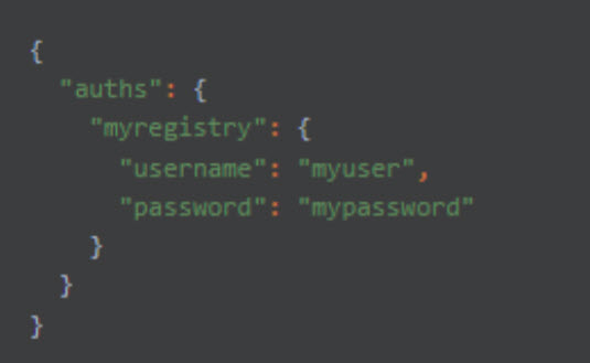

  4. If the private registry requires authentication, follow these steps:
    1. Create a JSON secret file:
      JSON secret file
    2. Run either the script or the Helm chart as follows:
      Script:
      ./install-secagent-webhook.sh -n my-namespace --registry=my.registry.com
      --registry-config-file=/path/to/registry-credentials.json
