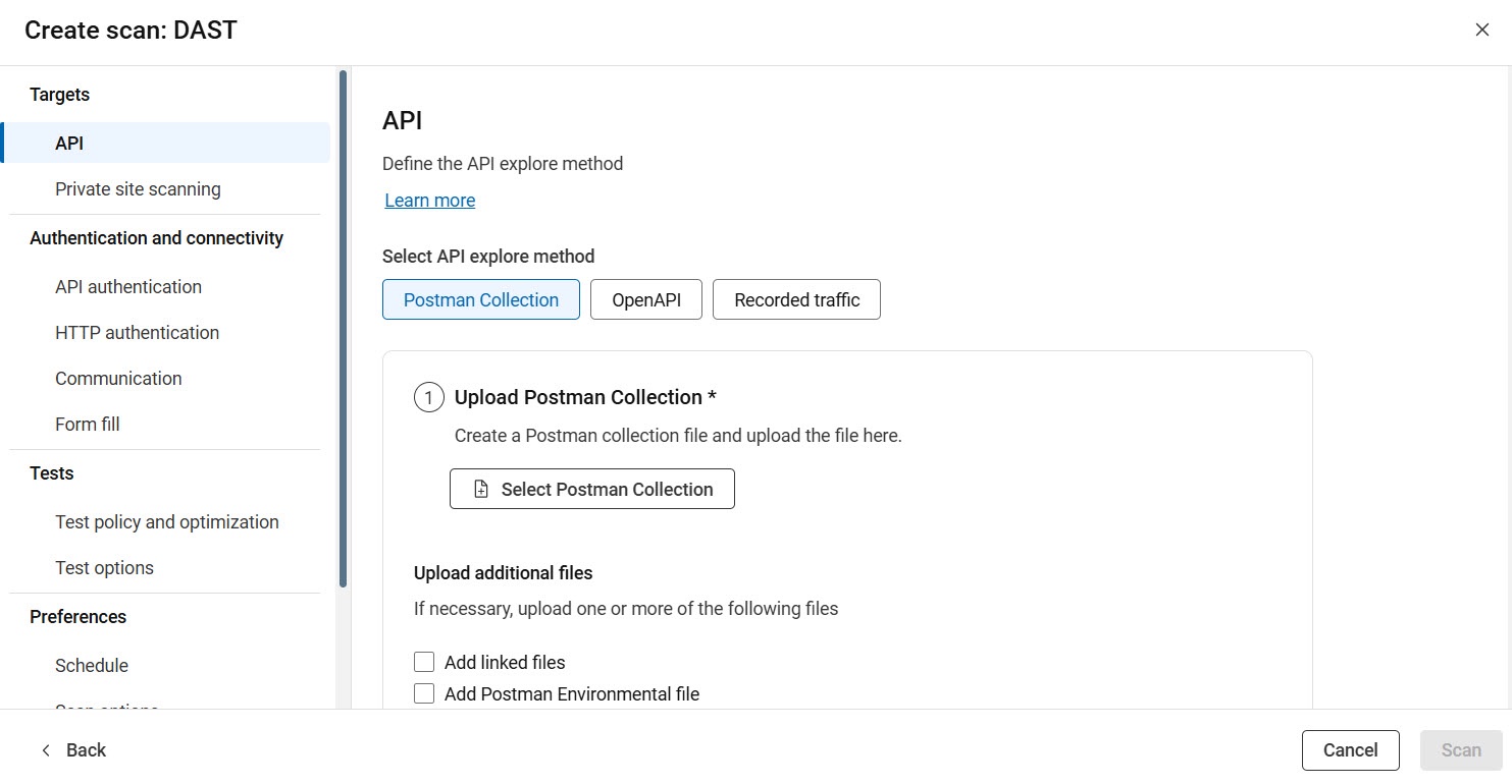

  3. API
    Select the API explore method:
    Setting
    Options
    Upload Postman collection or OpenAPI or Upload recording
    Using the API explore method, you can upload Postman files, an OpenAPI specification file or URL (including the Base URL), or a traffic recording.
    Domains to be tested
    Add all domains that you want included in the scan.
    Both these formats are valid:
    • https://demo.testfire.net/
    • demo.testfire.net
      Important: Domains not listed will not be scanned.

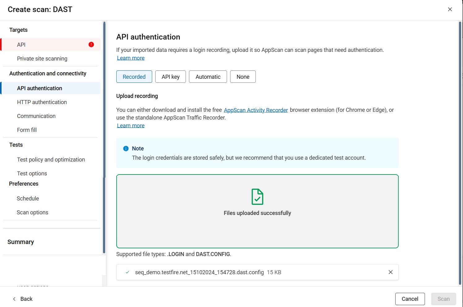

  4. Authentication and connectivity: API authentication
    If your imported data requires a login recording, upload it so AppScan can scan endpoints that need authentication. You can also use third-party tools to record the login and upload the file here. API key authentication is available for OpenAPIs. API configuration showing login recording upload option

    Recorded
    Upload recording
    If a special login procedure is needed, select this option to upload a recording of the procedure that AppScan 360° will use to log in to the applications during the scan. You can create the recording using the AppScan Activity Recorder (saved as a CONFIG file) or AppScan Standard (exported as a LOGIN file).
    Important: The recorded login sequence must include the following requests:
    • A login/authorization request
    • An additional logged-in/authorized request. This extra request helps AppScan confirm a successful authorization and maintain a session while testing the application.
    For more information about recording a CONFIG or LOGIN file see Recording traffic and Recording the login using AppScan Standard.
    API key AppScan 360° supports API authentication for scanning APIs that require an API key, such as OpenAPI. Enter at least one Key name and Key value. If needed, you can add another Key name and value. The values will be saved and used during API authentication.
    Automatic Select this method to let AppScan® automatically detect the login form of your application and use the username and password you provide. You can also enter a third credential (optional), such as PIN# = 1234. However, using a third credential requires help from the AppScan 360° Support team, and the scan might take longer.
    Note: CAPTCHA is not supported.
    None Use this option when no special login procedure is required.

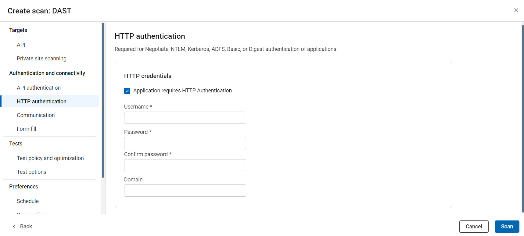

  5. Authentication and connectivity: HTTP authentication
    In addition to the login information, indicate whether the application requires HTTP authentication (Negotiate, NTLM, Kerberos, ADFS, Basic, or Digest). Enter the Username, Password, and Domain (optional) for AppScan 360° to use during the scan.
    API configuration showing HTTP authentication options

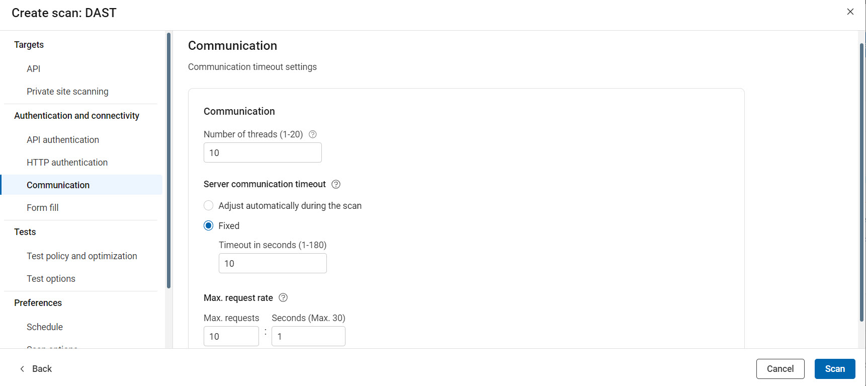

  6. Authentication and connectivity: Communication
    Set the maximum number of requests that AppScan 360° can send to the site simultaneously.
    API configuration showing Communication options
    Setting
    Options
    Number of threads
    Reduce the limit if your site does not allow this amount; if your site does not allow simultaneous threads at all, reduce the limit to 1.
    Server communication timeout
    Adjust automatically during the scan
    Allow AppScan 360° to decide how long to wait for any particular response before timing out. This can significantly reduce scan time.
    Fixed
    Set the maximum time AppScan 360° waits for a response before timing out. Increase this setting if your site's responses are slow and AppScan 360° is missing responses due to the short timeout.
    Max request rate
    By default, AppScan 360° sends its requests to the site as fast as possible. If this limit will overload your network or server, you can reduce it.

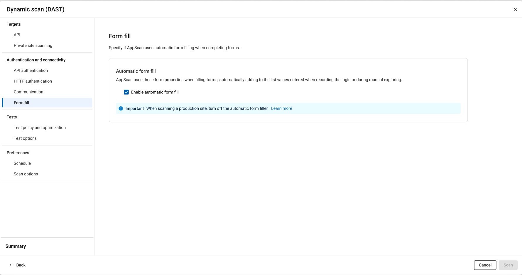

  7. Authentication and connectivity: Form fill
    When enabled, AppScan 360° uses the AppScan Standard default automatic form fill parameters to complete forms automatically during the scan. This cannot be changed using the wizard.API configuration showing enable form fill option
    Setting
    Options
    Automatic form fill
    AppScan 360° uses AppScan Standard's default form fill parameter values to fill and submit forms during the scan.
    Note: If you turn off automatic form fill and scan in AppScan 360°, it will remove all the information filled in the forms except for the login management data. AppScan will not fill in the forms automatically during scanning. When you import this scan into AppScan Standard, automatic form fill is enabled, but the form filling data, except for login management, will be empty.

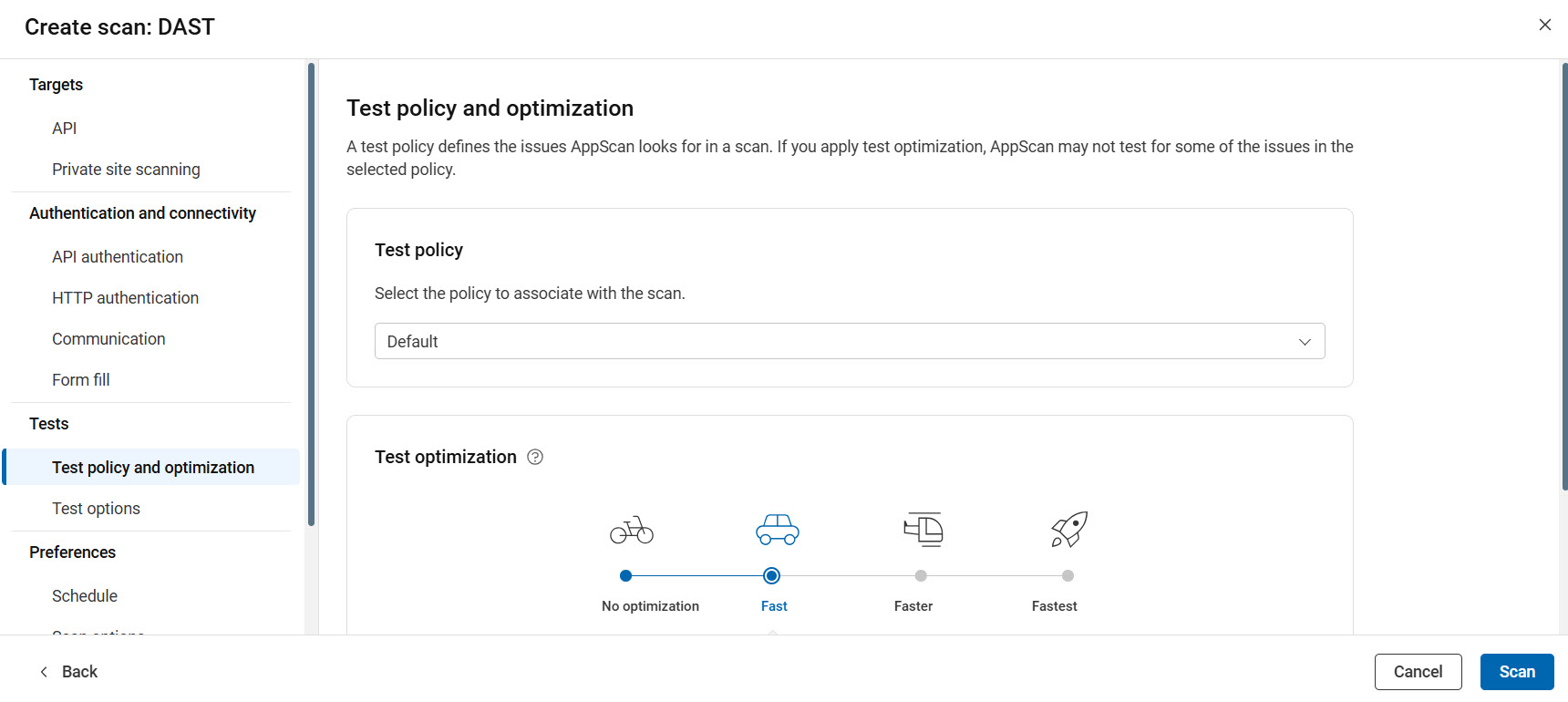

  8. Tests: Test policy and optimization
    Define the collection of tests that will be sent to the application during testing (the test policy), and apply optimization for faster scans at times in the product lifecycle when speed is more important to you than scan depth.API configuration showing test policy and optimization options
    Setting
    Options
    Test policy
    Select one of the five predefined test policies or a custom policy based on the level of coverage required. The default is Default that includes all tests except invasive and port listener tests. For details, see Test policies.
    Tip: Test policy is different from application compliance policy.
    Test optimization
    Select the level of tradeoff between scan speed and issue coverage for your needs. The slider offers four levels. The default is Fast. For details, see Test Optimization.

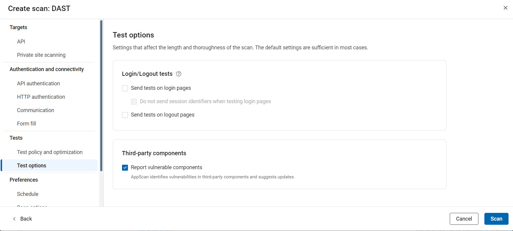

  9. Tests: Test options
    Choose whether to send tests on login and logout pages. If you choose to send tests on login pages, specify whether to send session identifiers.API configuration showing test options
    Setting
    Options
    Login/Logout tests Choose whether to send tests on login and logout pages. If you choose to send tests on login pages, specify whether to send session identifiers.
    Report vulnerable components AppScan finds vulnerabilities in third-party components and recommends updates.

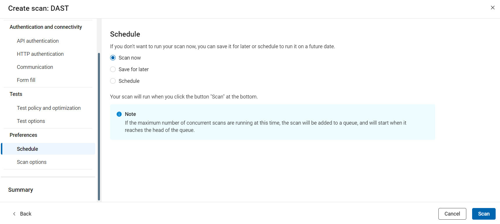

  10. Preferences: Schedule
    Specify when the scan runs: now, later, or on a schedule.API configuration showing the scheduling options
    Setting
    Options
    Scan now
    Your scan runs as soon as setup and review are complete.
    Save for later
    Your configuration is saved when completed. You can run the scan later.
    Schedule
    Your configuration is saved, and one or more scans run as configured:
    1. Select a date and time. Enter these according to the time zone configured on your machine, but note that times will be converted to UTC when displayed in the user interface.
    2. To run the scan more than once, select the Repeat, and then choose:
      • Daily, and select a daily interval (1-30 days)
      • Weekly, and select which day, or
      • Monthly, select a monthly interval, and then select which numerical day of the month, or which weekday of the month (first, second, third, fourth, last).
      Note: If the maximum number of concurrent scans are running when the scheduled time arrives, the scan starts as soon as allowed by your subscription.
    3. Set the End date (the last date a scan will run), or click Remove end date to have the schedule run indefinitely.

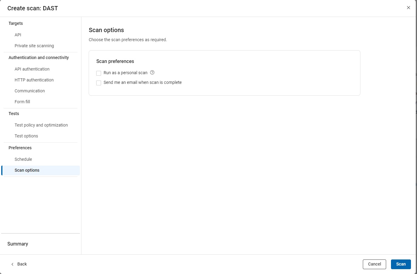

  11. Preferences: scan options
    In the Scan options panel, you can:
    • Elect to run the scan as a Personal scan.
    • Elect to receive an email when the scan is complete.
