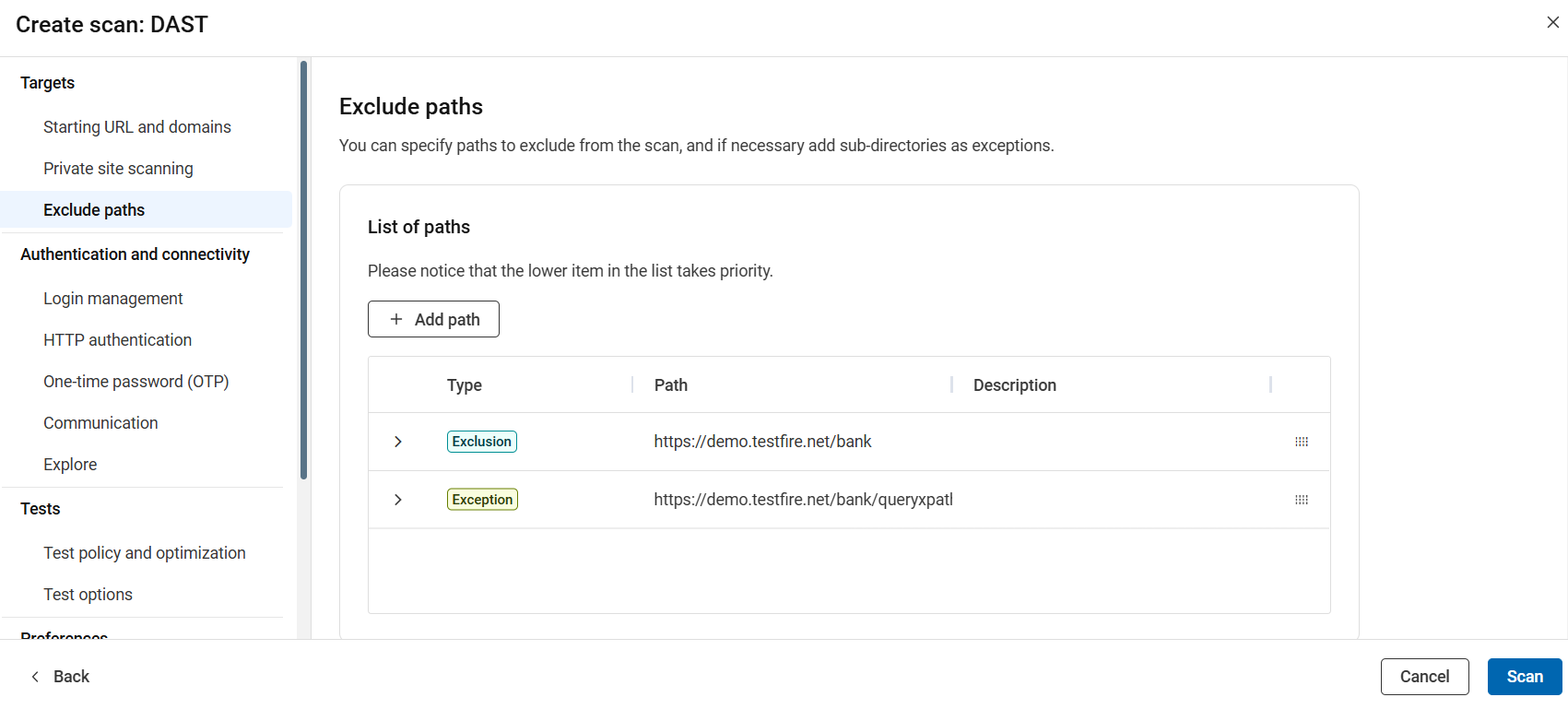

  4. Targets: Exclude paths
    Exclude certain paths in the application from the scan. You can filter the scope of the automatic Explore stage by adding URLs (full paths, which may include queries) or Regular Expressions to the Excluded paths list. Possible reasons for doing this may be:
    • Because they are still under development and you know they are problematic and do not want to scan them right now
    • Because you know they are not problematic and you want to reduce scan time
    • To reduce scan time by restricting the scan to certain parts of the application
    You can also include certain paths to be scanned as an exception to the excluded path.
    Configuration showing one exclusion and one exception added

    + Add path
    Displays options below the list to add a path as an exclusion or exception to the scan.
    Exclusion Listed paths are excluded from the scan. Any link that matches a path configured to be an exclusion is filtered out of the scan.
    • Path: Type a path or regular expression. If the path is a regular expression, select the RegEx toggle button.
    • Description (Optional): Add a description to be displayed in the Exclude Paths list.
    • Exclusion: Select the radio button to add an exclusion and click Add. The listed path and its subdirectories will be excluded from the scan, unless you define any exception.
    Exception Use to include a specific a directory or a file within a path that was excluded higher up in the list.
    • Exception: Select the radio button to add an exception to a specific directory within a path that was excluded higher up in the list and click Add. The listed path will be included in the scan. Note that the Exception must be below the Exclusion to take effect.
    • Use Exception only needed when you want to include a directory or a file that is within a path that you have excluded. For example, if you have excluded: https://demo.testfire.net/bank you could then add https://demo.testfire.net/bank/queryxpath.jsp as an Inclusion, lower down in the list, to include that subdirectory in scans.
    • If you add Exclusions between the Explore and Test stages of scanning, AppScan® will not test the excluded paths even though they were explored.
    • Where there is a conflict between two items in the list, the lower item takes priority. Click and drag the item in the list to move them up or down and adjust the order of items as required.
