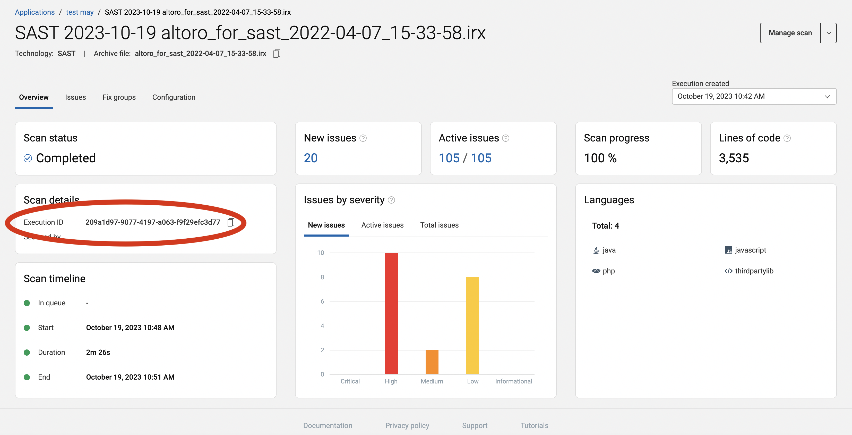

/scans/. For example, in the following URL, the scan ID is6ecf4111-adf9-47a8-852b-625ff4c954ef:< ASCP service URL>/70f7db22-1bea-4f55-babc-5668f1f723f4/scans/6ecf4111-adf9-47a8-852b-625ff4c954ef/scanOverview - The execution ID is listed on the Overview tab,
under Scan details.

- On the scan page ( or ), copy the Execution ID listed under Scan details.
