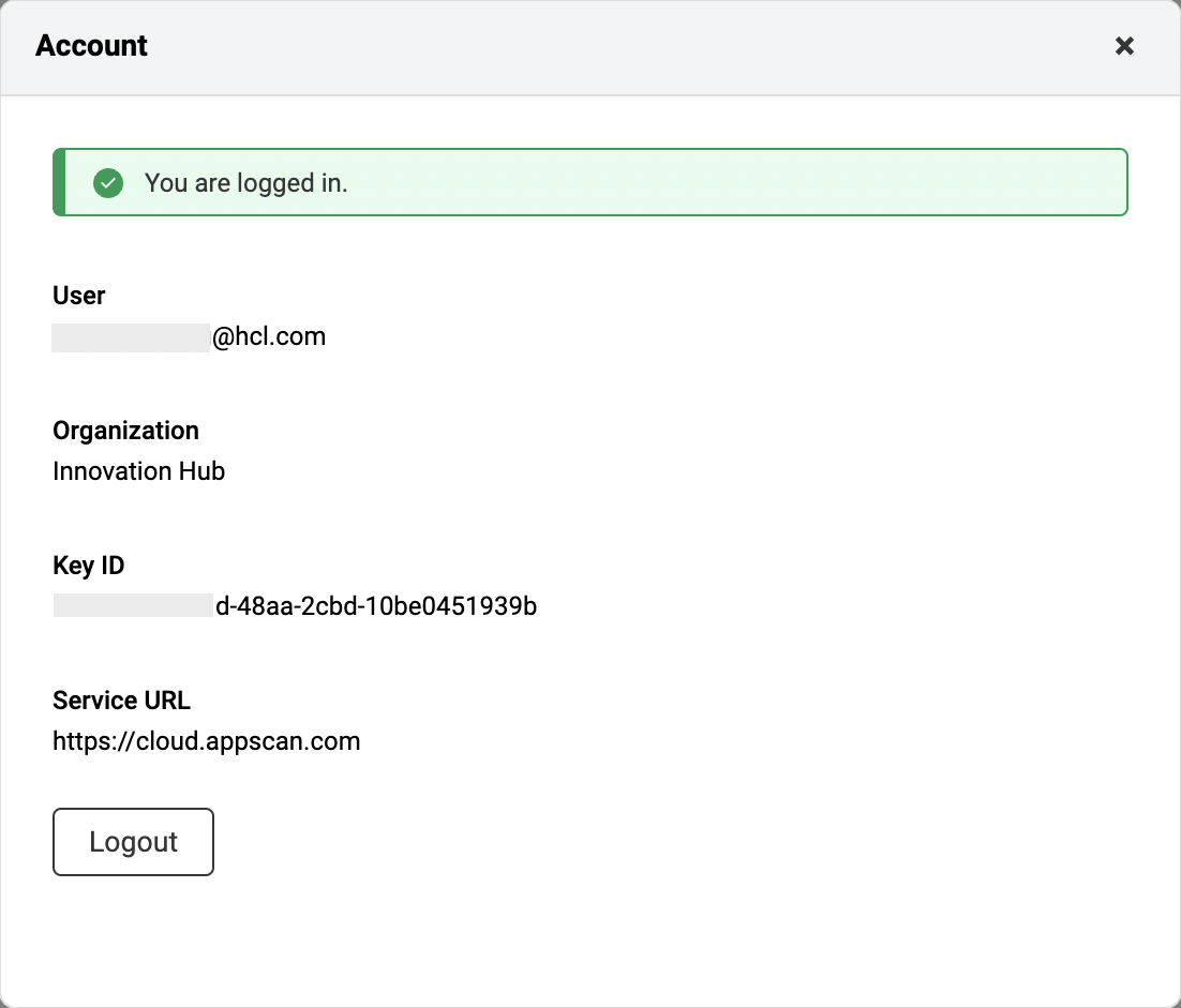

Account information
To access account information, select .

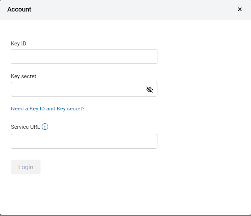

If you are not currently logged in to AppScan 360°, first provide a key ID and key secret, and enter the service URL.
Click Logout to log out of the currently connected AppScan service.

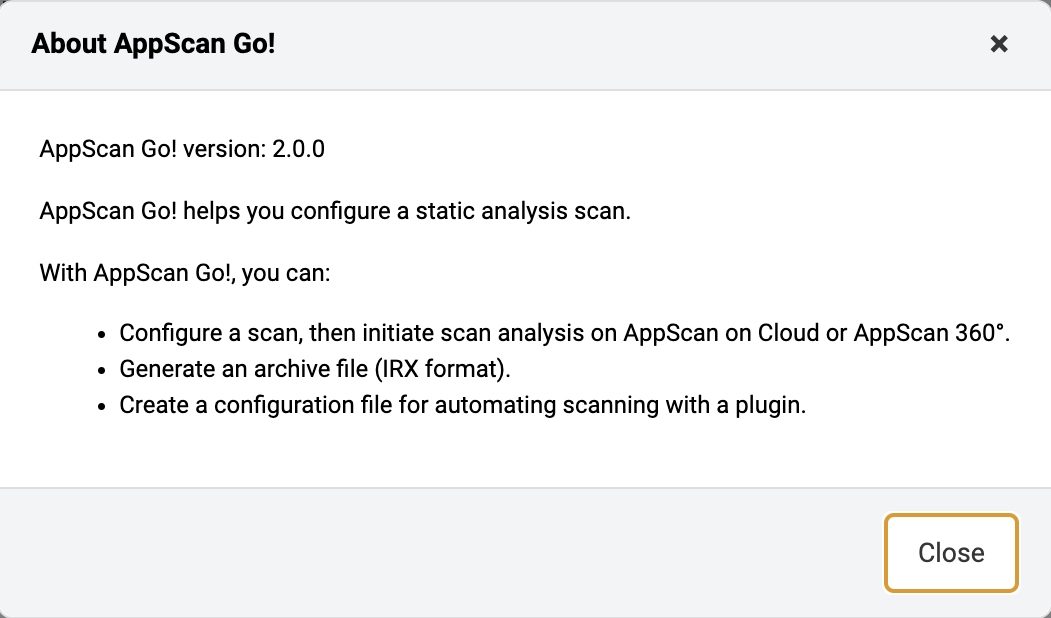

Help menu
The Help menu provides additional information and resources for AppScan Go! users:
- Select to access the About AppScan Go! dialog box.

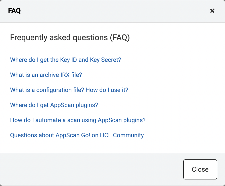

- Select to access the FAQ dialog box.
Click on any of the questions to launch the online help in a new browser tab with information answering the question.
