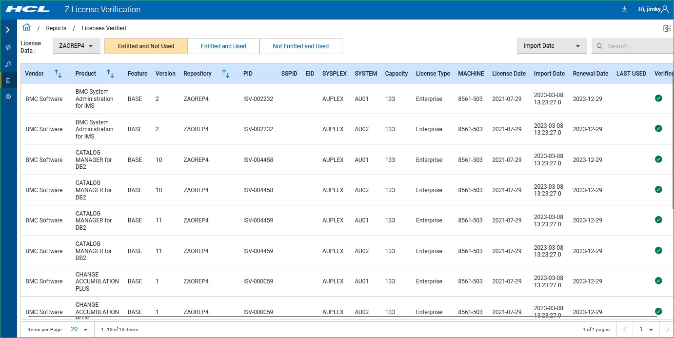

Entitled and Not Used
The Entitled and Not Used report displays
products that are licensed but are not being used. Investigate whether these products are still required.
| Column Name | Description |
| Vendor | Name of the Vendor. |
| Product | The Asset name of the product. |
| Feature | The feature name of the product. |
| Version | The version of the product. |
| Repository | The name of the Repository being viewed. |
| PID | The PID of the product. |
| SSPID | The IBM S&S PID for the product. |
| EID | The IBM Entitlement ID for the product. |
| SYSPLEX | The name of the SYSPLEX that the product was discovered on. |
| SYSTEM | The name of the System/LPAR that the product was discovered on. |
| Capacity | The MSU capacity of the License. |
| Machine | The Machine the product is licensed on. |
| License Date | Date the software was licensed. |
| Import Date | The date that data was verified. |
| Renewal Date | The date the software is due for renewal. |
| Last Used | The date the product was last used. |
| Verified | If the ICON is GREEN, the software is verified correctly. If the ICON is RED, then click on the ICON to see the explanation why the software is not verified. |

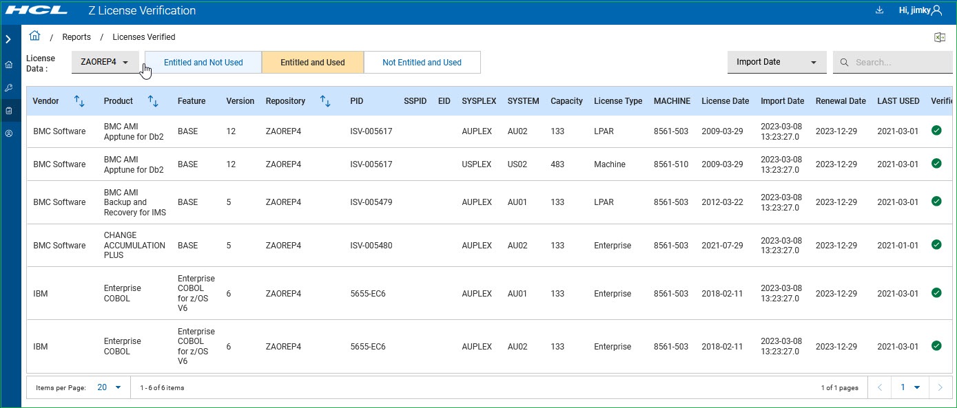

Entitled and Used
The Entitled and Used report shows licensed products that are being used. This report needs no further investigation.

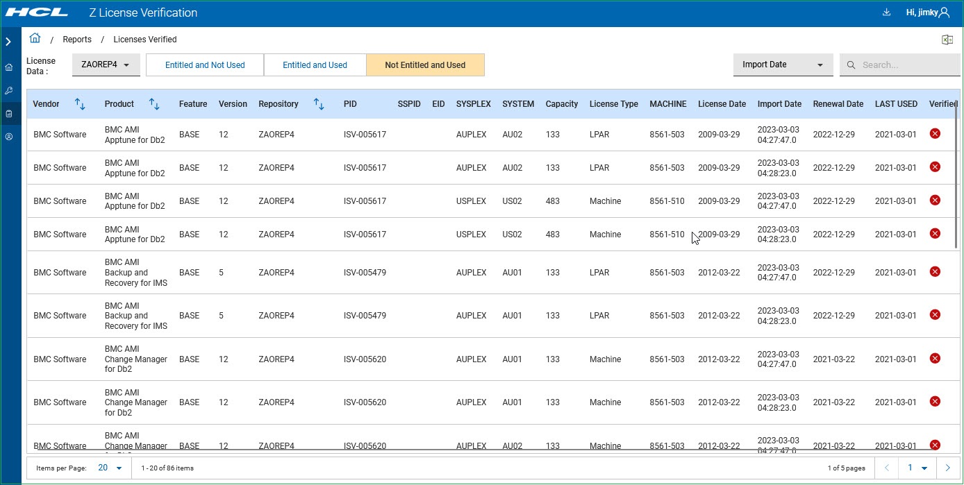

Not Entitled and Used
The Not Entitled and Used report shows licensed products that are
still being used but have not met the verification criteria. Clicking on the red
circle "x" under the Verified column displays the reason why the products
have not been verified. One reason could be the capacity of the machine or LPAR has
changed and does not match the license or the renewal date has passed. | Column Name | Description |
