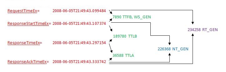

These measurements are then used to calculate elapsed time for various activities in the request/response process, as indicated in the following diagram:
- Discover Timing Metric
- Description
WS_GEN- Web server generation time
RT_GEN- Round trip generation time
TTLB- Time to last byte
NT_GEN- Network time
TTLA- Time to last Ack
TTFB- Time to First Byte (same value as WS_GEN)
Calculated Timing Values (microseconds)
TTFB=7890TTLB=189780TTLA=36588WS_Gen=7890NT_GEN=226368RT_GEN=234258
