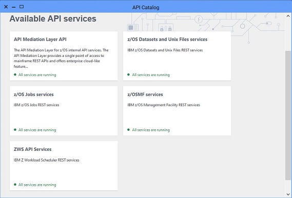

  3. Verify that the Workload Automation REST API was successfully added to the API mediation layer by opening the Zowe Virtual Desktop and accessing the API catalog. The catalog will show the Workload Automation REST API, as in the following example:
The image shows the Zowe API Catalog with some examples of the available API services to be used.
