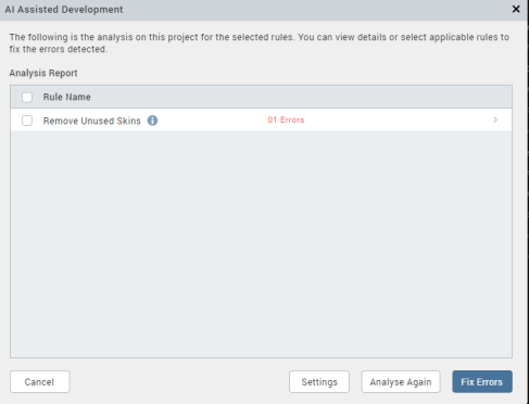

  5. Click Analyze. The Analysis Report appears.
    This report displays the unused items beside the respective rules
  6. Click on the respective rule to view the details of the unused item.
  7. Select the item you want to delete from your project.
  8. Click Fix Errors. This will delete the items permanently from your project.
    Note: This is an irreversible step. You cannot recover the deleted item after this step.

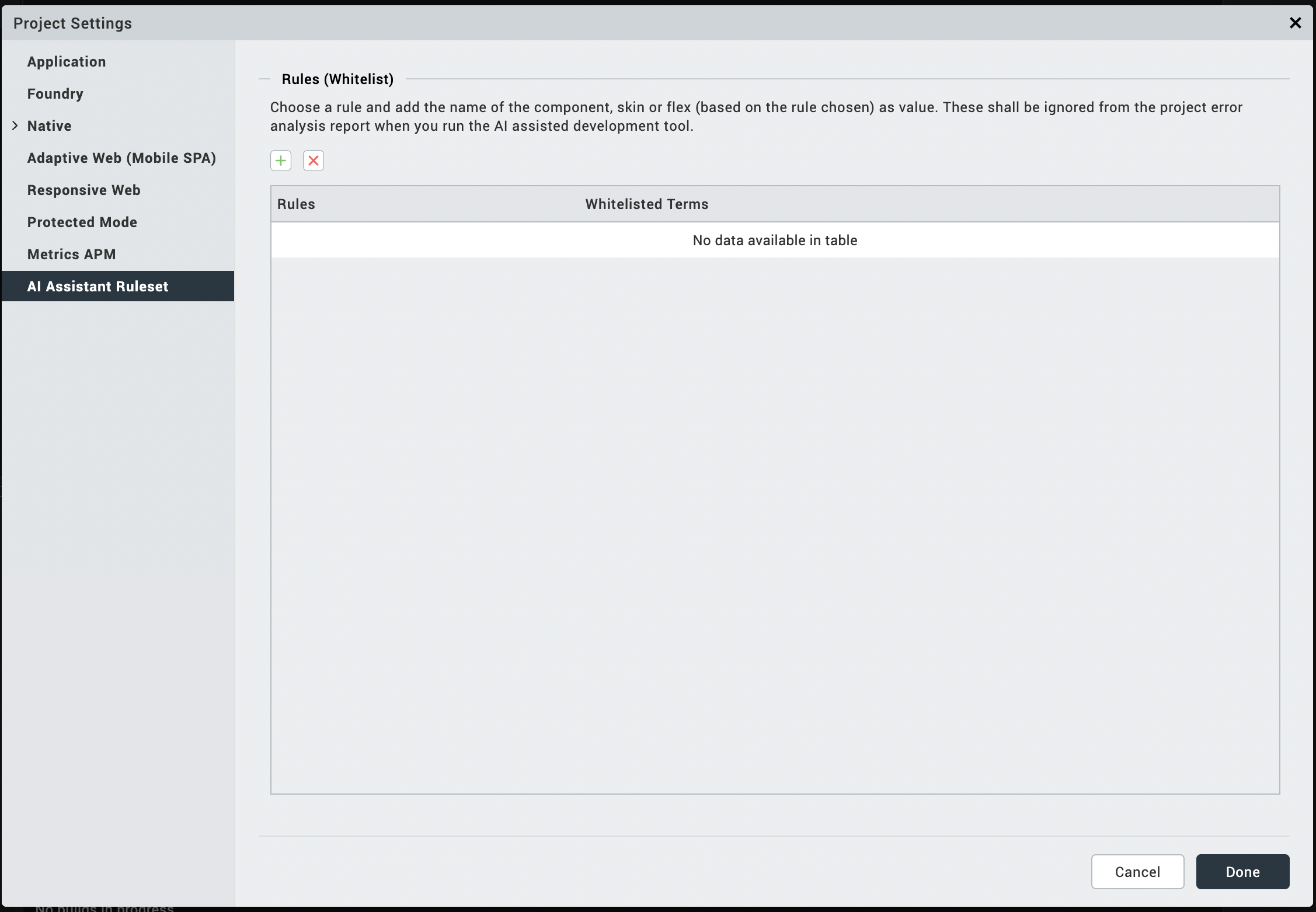

Add Exceptions while analyzing your project
To add any resources, skins, or widgets as an exception while analyzing the a project, follow these steps.
  1. In Volt Iris, open your project.
  2. From the main menu, navigate to Help > AI Assisted Development and select the rule categories, say Best Practices.
    The AI Assisted Development window appears.
  3. Click Settings.
    The Rules Whitelist window appears displaying a table with two columns: Rules and Value.
    You can also access the Rules Whitelist window from the Project Settings. In the Project Settings window, from the left pane select AI Assistant.
  4. Click + to add the exception.
    A new row is added to the table.
  5. Under the column Rules, select the rule for which you are adding the exception.
  6. Under the column Value, provide the name of the resource, skin or widget that must not be analyzed.
    For example, if a rule name is Remove Unused Skins with the value formSkin, when you run the analysis for unused skins, the formSkin will be ignored from the analysis.
