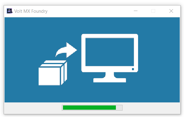

  2. Double-click VoltMXFoundryInstaller-x.x.x.x_GA.exe to launch the installer.
    The InstallAnywhere dialog appears. The InstallAnyWhere dialog displays information about the progress of the software installation at run time.
    A dialog with the VoltMX logo appears.

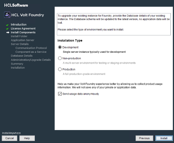

  6. Click Next. The Install Components window appears with the following supported installation types:
    • Development for single machine instance.
    • Non-Production for larger environments like QA or UAT.
    • Production for the production instance.
    Installation environment is set to Development by default .
  7. Choose the New Installation option for new installation.
  8. Choose one of the appropriate install type based on your license - for example, Development, Non-Production, or Production.
  9. Select the Send usage data anonymously check box. Allows VoltMX to collect product usage information to make your Volt Foundry experience better. VoltMX does not save any of your private or application data. By default this check box is selected.

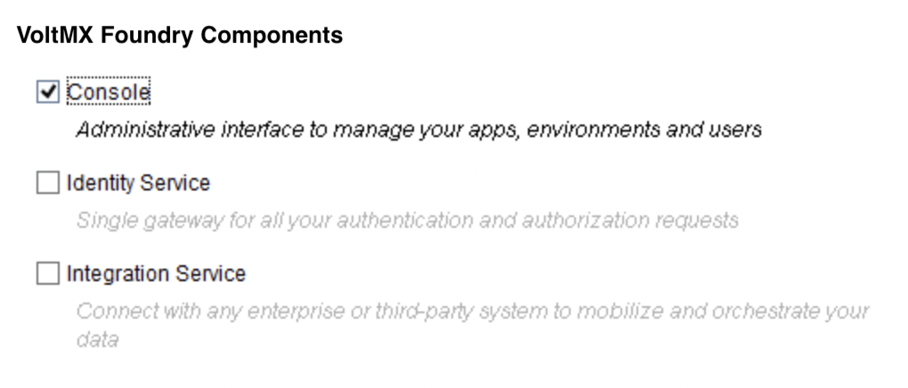

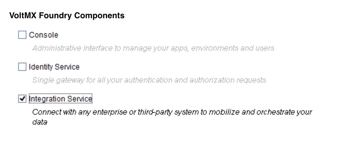

  10. Click Next. The Choose components to install window appears.
  11. Select one or more check boxes for the supported components. By default, the Console, Identity Services, Integration Services, Developer Portal, and Engagement Services check boxes are selected:
    • Console - To install Volt Foundry Console, select the Console check box.
      The system creates the following databases: <prefix>mfconsoledb<suffix>, <prefix>mfaccountsdb<suffix>, and  <prefix>mfreportsdb<suffix>.
    • Identity Services - To install VoltMX Identity Services, select the Identity Services check box.
      The system creates the following database: <prefix>idconfigdb<suffix>.
    • Integration Services - To install Volt Foundry Integration Services, select the Integration Services check box.
      The system creates the following databases: voltmxadmindb  and  mfreportsdb.
    • API Developer Portal - To install developer portal, select the API Developer Portal check box.
      Note: During installation if you have selected API Developer Portal, the API Developer Portal is created. You can directly access your VoltMX Developer Portal in Volt Foundry Console.
    • Engagement Services - To install Volt Foundry Engagement Services, select the Engagement Services check box.
      The system creates the following database: <prefix>vpnsdb<suffix>.

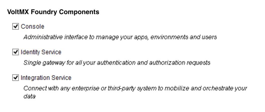

    • If you select the Console check box, the system creates the reports database.

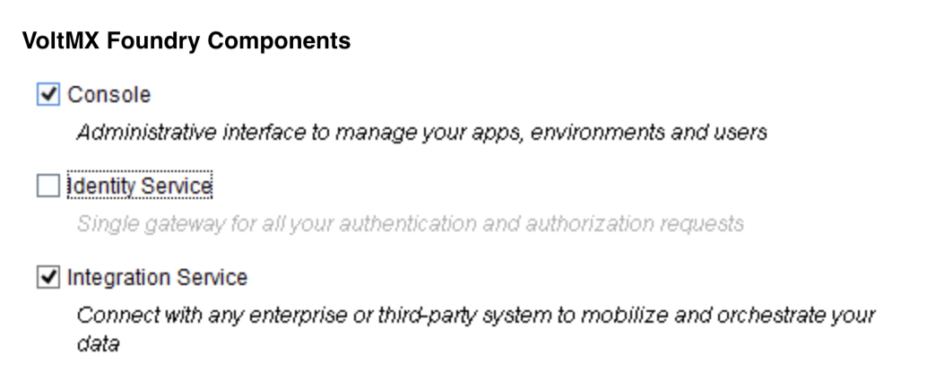

    • If you select the Console and Integration Services check boxes, the system creates the reports database.
    • If you select all (components: Console, Identity Services, Integration Services) check boxes, the system creates the reports database.

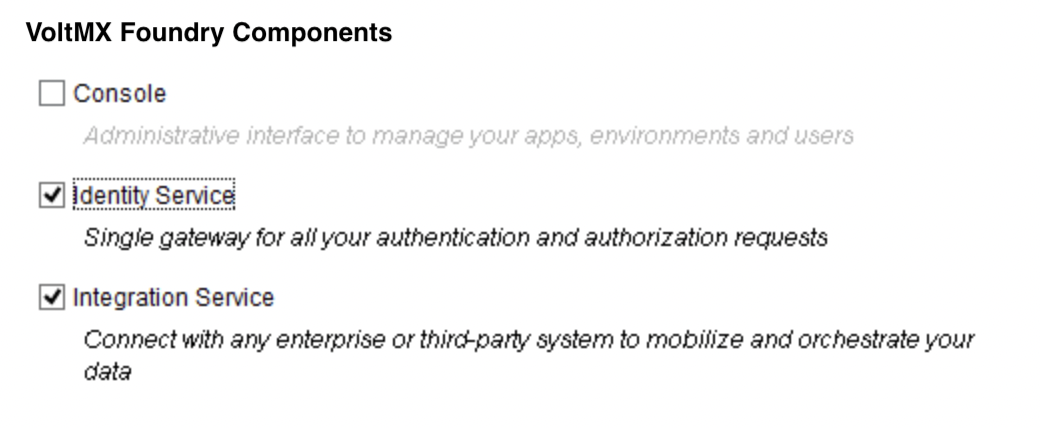

    When you install the integration with or without one or more components ( identity, KMS or Sync) on a separate node, the installer displays the Reports Database Name field in the Database Details window, based on the following choices only :
    -  if you select Integration Services check box, the system displays the Reports Database Name field in the Database Details window.
    -  if you select Integration Services with Identity Services, the system displays the Reports Database Name field in the Database Details window.
    If the installer prompts you to enter the existing reports db, enter the reports database name in the Database Details window > Reports Database Name field. Refer to the Database Details window.

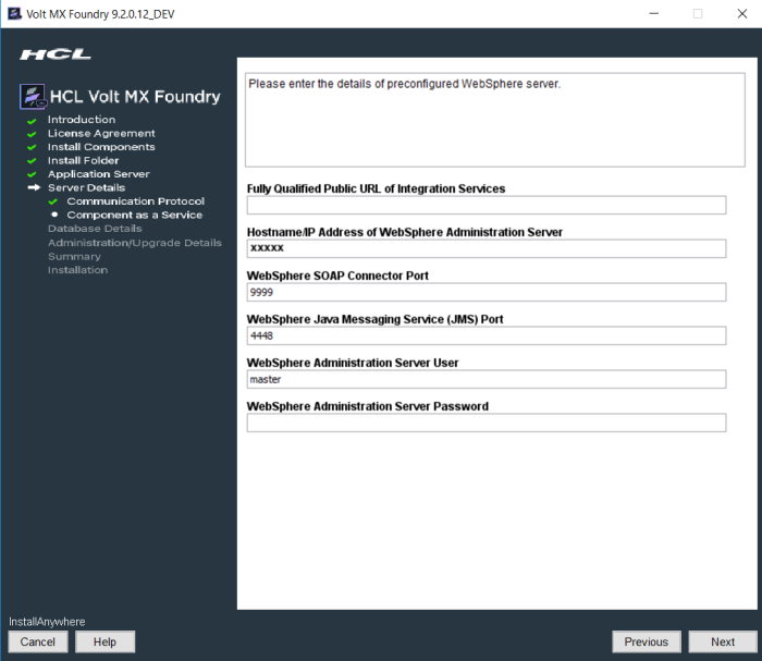

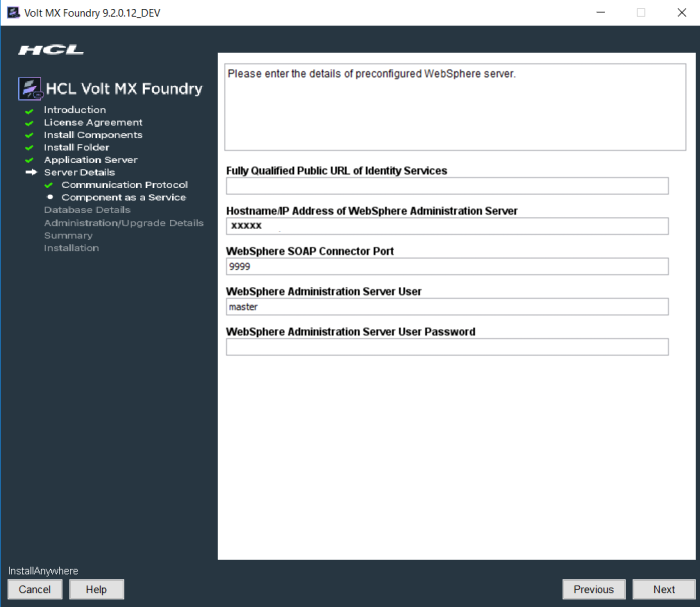

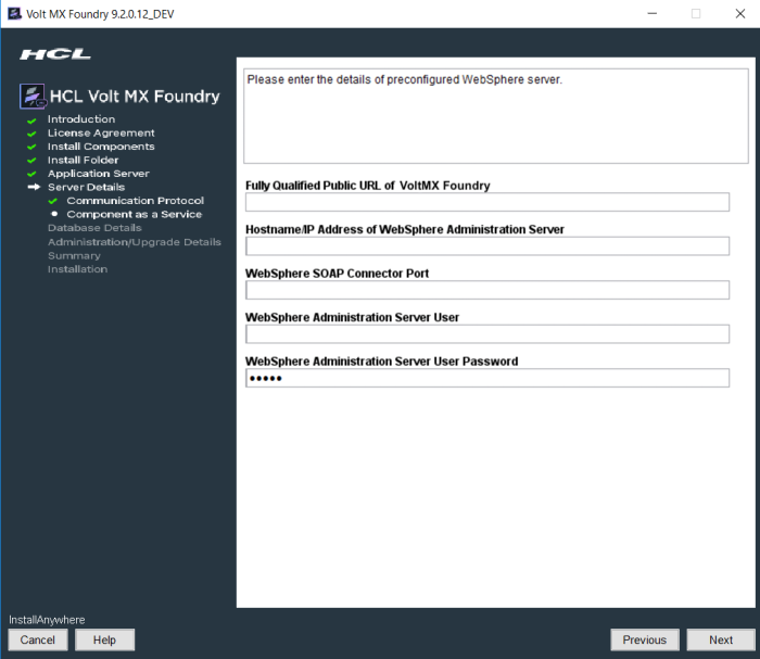

  17. Click Next. In the Service Details window, enter the details for WebSphere.
    1. The following window will appear only if you select all the check boxes at Install Components. Enter the following details:
      • Fully Qualified Public URL of Volt Foundry: Enter load balancer URL to use public communication.
        If you are using standalone WebSphere Server without Load Balancer, ensure that the port for default host is set to either 9080. For example, http://<domain>:9080
      • Hostname/IP Address of WebSphere Administrator Server: Enter IP Address/Hostname of the WebSphere Administrator Server.
        If you are installing Volt Foundry on a machine where the IP address may change, for example, development boxes that connect to the network via Wi-Fi, it is preferred to provide the Hostname instead of IP address during installation.

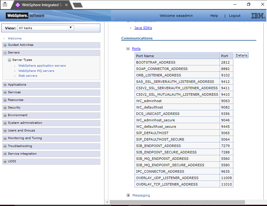

      • WebSphere SOAP Connector Port: Enter SOAP connector port of WebSphere Server.
        Port details for a particular server can be contained from the Server Configuration page, as shown in the following:
      • WebSphere Java Messaging Service (JMS) Port: Enter WebSphere-JMS port.
        The JMS port is same as Bootstrap address for WebSphere.
      • WebSphere Administrator Server User: Enter the log-in username for WebSphere Administrator Server.
      • WebSphere Administrator Server Password: Enter the log-in password for WebSphere Administrator Server.

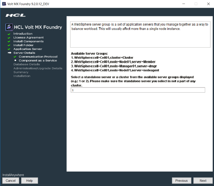

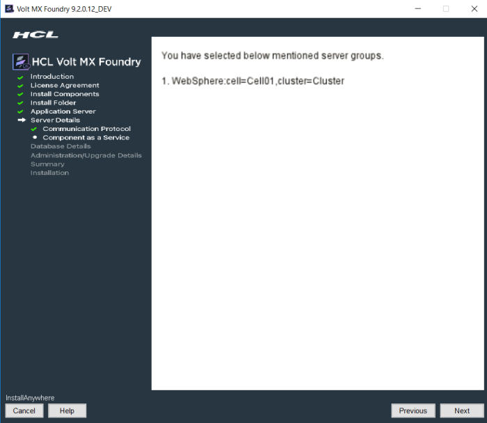

    3. Click Next. The Server Groups window appears.
    4. Enter server groups separated by commas - for example, 1, 2, shown in the previous step. Click Next. The system displays the selected groups in the Selected Server Group window, shown below:WebSphere:cell=KH2013Node01Cell,node=KH2013Node01,server=server1
      If the JVM Heap size is less than 6GB when all the components are selected, the following warning is displayed:
      You can choose to continue with the installation by clicking OK, to avoid roll back during installation due to the "OutofMemory" warning.

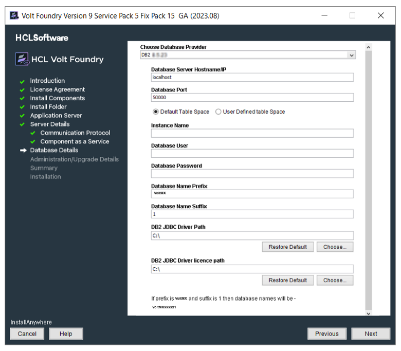

  18. Click Next. The Database Details window appears. From the Database Choice drop-down, choose one of the databases to display database details and fill the details. By default, this option is set to MySQL.
    • Enter the following database details for MySQL.
      • Database Server Hostname/IP: Enter the DB server Hostname/IP to be used to create a database of selected components of Volt Foundry. By default, the server Hostname/IP is set as localhost.
      • Database Port: Enter the database port of the MySQL Server. By default, this field is set to 3306 for MySQL.
      • Database User: Enter the user name used while creating the database user - for example, dbclient.
      • Database Password: Enter the user password used while creating the database user.

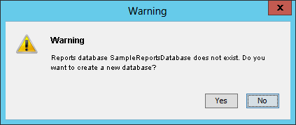

      • Reports Database Name: Enter the reports database name that is created during Volt Foundry installation. Refer to Install Components.
        The system verifies the entered database name - for example, SampleReportsDatabase. If the reports database name does not exist, the system displays the warning message: Reports database SampleReportsDatabase does not exist. Do you want to create a new database?, shown below:
        Click Yes. The system creates the reports database - for example, SampleReportsDatabase.
        If you try to install Integration Services and Console in different nodes, ensure that you point to the same reports database to make reports feature work properly.
      • Database Name Prefix: Enter the valid prefix databases - for example, VoltMX.
      • Database Name Suffix: Enter the valid suffix for all databases - for example, 1.

      • Reports Database Name: Enter the reports database name that is created during Volt Foundry Installation. Refer to Install Components.

    • Enter the following database details for DB2.
      • Database Port: Enter the database port of the DB2. By default, this field is set to 5000 for DB2.
        • Provide tablespace for DB2 database:
          • Default Tablespace: If selected, the database schema and SQL scripts migration happen automatically to the default tablespace for example, USERSPACE1
          • User Defined Tablespace: If selected, enter the tablespaces for the following:
            • Data Tablespace:
              Enter the name for Data tablespace.
              This is a mandatory field. If the Data tablespace field empty, the installer displays the error message:
              If the Data tablespace (for example, SampleData) does not exist, the installer displays the error message:
            • Index Tablespace: Enter the name of Index tablespace.
              If the input for Index Tablespace is not provided, then the value will be set to the provided Datatable space value.
            • LOB Tablespace: Enter the name for LOB tablespace.
              If the input for LOB Tablespace is not provided, then the value will be set to the provided Datatable space value. * Instance Name: Enter the instance name for the database. * Database User: Enter the user name used while creating the database user. * Database Password: Enter the user password used while creating the database user. * Reports Database Name: Enter the reports database name that is created during Volt Foundry Installation. Refer to Install Components.
      • Database Name Prefix: Enter the valid prefix databases - for example, jboss.
      • Database Name Suffix: Enter the valid suffix for all databases - for example, 54.
        Download the following DB2 JARs from IBM download site:
             - IBM DB2 Type 4 Driver (db2jcc4.jar)
             - DB2 JDBC Driver licence (db2jcc_license_cu.jar)
        The version of the downloaded JARs should be compatible with your installed DB2 Database version.
      • DB2 JDBC Driver Path: Click Choose and select the path for the IBM DB2 Type 4 Driver (db2jcc4.jar) that you downloaded.
        Provide the complete path of the database jar file. For example, <path of the database jar location>/db2jcc4.jar
      • DB2 JDBC Driver License Path: Click Choose and select the path for the DB2 JDBC Driver license (db2jcc_license_cu.jar) that you downloaded.
        Provide the complete path of the database license file. For example, <path of the database license location>/db2jcc_license_cu.jar
        If a database faces connection issues, the system displays an error message. For example:

    • management_server_host_name <application_instance hostname>
    • management_server_port <soap port of application_instance>
    • management_server_user <application_instance admin username>
    • management_server_password <application_instance admin password>
    • management_server_groups <application_instance groups details>

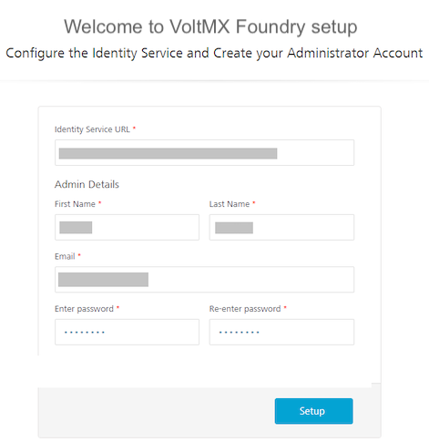

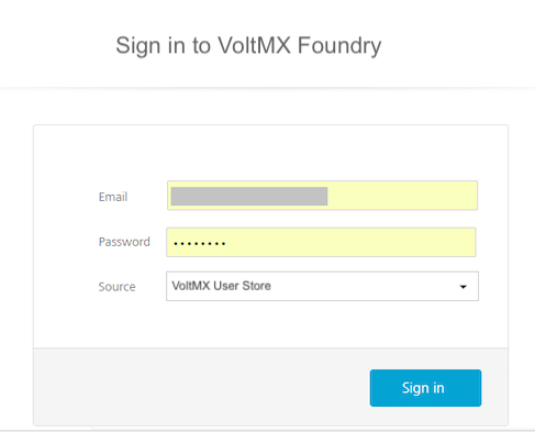

    Note: You can now access Volt Foundry Console by using the URLs. For more details, refer to Accessing Volt Foundry Console - On-premises.
    During installation if you have configured your super administrator account, you can directly log in to Volt Foundry Console by using the Console URL.
