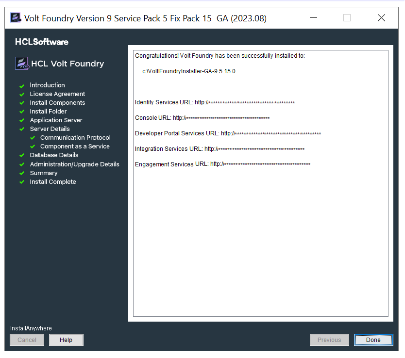

To install Volt Foundry on WebLogic using the installer, follow these steps:
  1. Unzip the VoltMXFoundrySetup.zip file.

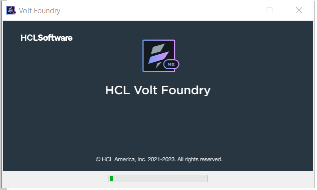

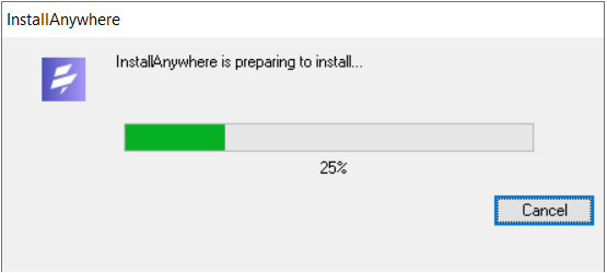

  2. Double-click VoltMXFoundryInstaller-x.x.x.x_GA.exe to launch the installer.
    The InstallAnywhere dialog appears. The InstallAnyWhere dialog displays information about the progress of the software installation at run time.
    A dialog with the Volt Foundry logo appears.

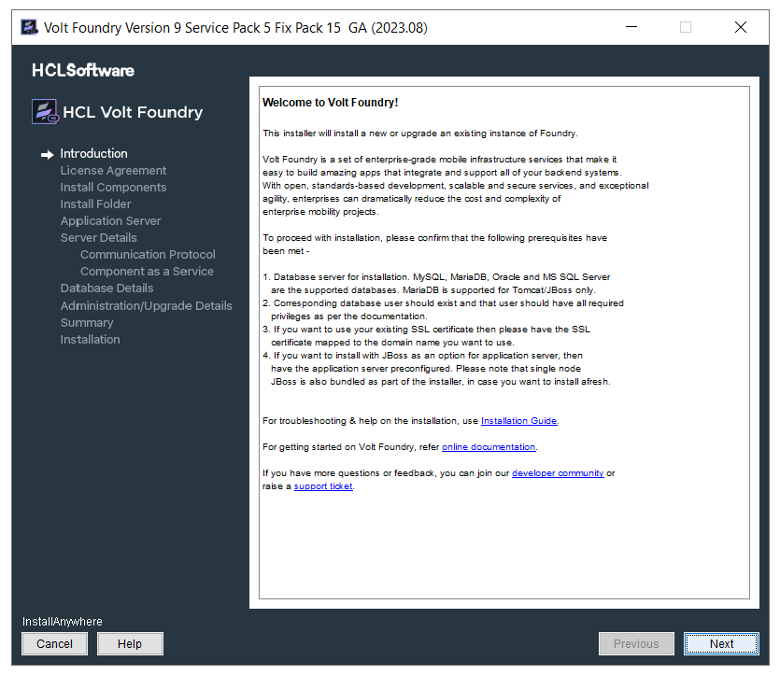

  3. The Welcome to Volt Foundry windows appears.
    Read the instructions carefully before installing Volt Foundry Console.
  4. Read the instructions carefully, and click Next.

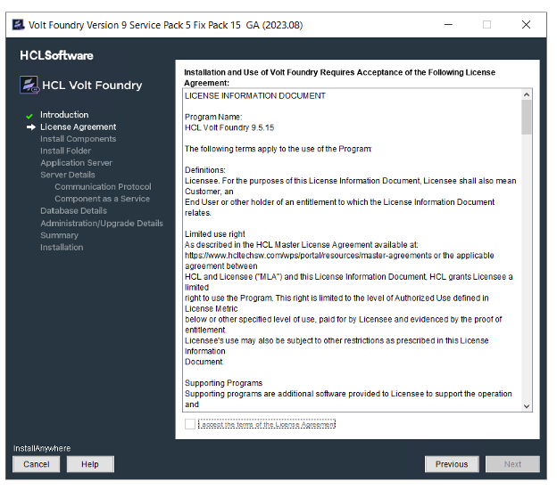

    The LICENSE AGREEMENT window appears.
  5. Scroll until end of the screen, and select the "I accept the terms of the License Agreement" option.
    Note: To activate the License Agreement option, read carefully the whole agreement text.

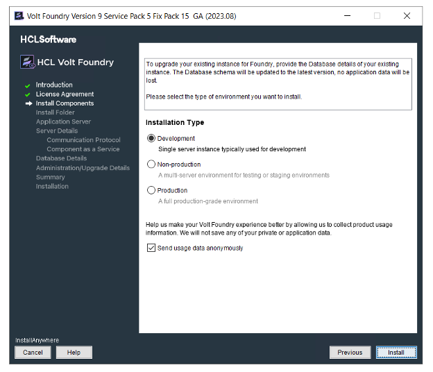

  6. Click Next. The Install Components window appears with the following supported installation types:
    • Development for single machine instance.
    • Non-Production for larger environments like QA or UAT.
    • Production for the production instance.
    Installation environment is set to Development by default .
  7. Choose one of the appropriate install type based on your license - for example, Development, Non-Production, or Production.
  8. Select the Send usage data anonymously check box. Allows Volt MX to collect product usage information to make your Volt Foundry experience better. Volt MX does not save any of your private or application data. By default this check box is selected.

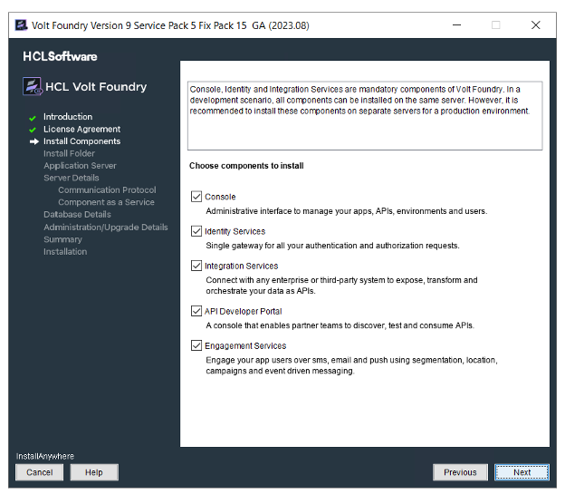

  9. Click Next. The Choose components to install window appears.
  10. Select one or more check boxes for the supported components. By default, the Console, Identity Services, Integration Services, Developer Portal, and Engagement Services check boxes are selected:
    • Console - To install Volt Foundry Console, select the Console check box.
      The system creates the following databases: <prefix>mfconsoledb<suffix>, <prefix>mfaccountsdb<suffix>, and  <prefix>mfreportsdb<suffix>.
    • Identity Services - To install Volt MX Identity Services, select the Identity Services check box.
      The system creates the following database: <prefix>idconfigdb<suffix>.
    • Integration Services - To install Volt Foundry Integration Services, select the Integration Services check box.
      The system creates the following databases: voltmxadmindb  and  mfreportsdb.
    • API Developer Portal - To install developer portal, select the API Developer Portal check box.
      Note: During installation if you have selected API Developer Portal, the API Developer Portal is created. You can directly access your VoltMX Developer Portal in Volt Foundry Console.
    • Engagement Services - To install Volt Foundry Engagement Services, select the Engagement Services check box.
      The system creates the following database: <prefix>kpnsdb<suffix>.

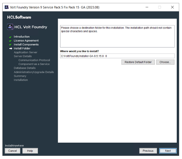

  1. Click Next. The Install Folder window appears. The selected path appears in the Where would you like to install field.
  2. Click Choose to browse the required folder from your system.

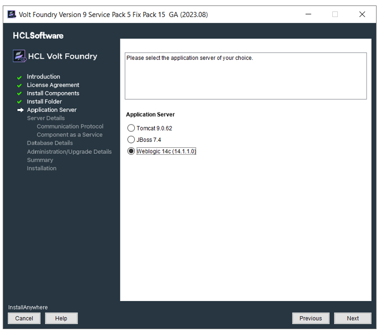

  3. Click Next. The Application Server window appears asking you to choose the application server. By default, the Application Sever is set to Tomcat.
  4. In the Application Server window, select WebLogic.

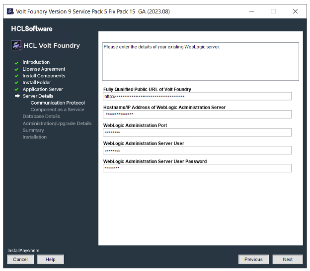

  7. Click Next. Enter the details:
    1. The following window will appear only if you select all the check boxes at Install Components.
      • Fully Qualified Public URL of Volt Foundry Console:  Enter load balancer URL to use public communication.
      • Hostname/IP Address of WebLogic Administrator Server: Enter IP Address/Hostname of the WebLogic Administrator Server.
      • WebLogic Administrator Port: Enter native port of WebLogic Administrator Server.
      • WebLogic Administrator Server User: Enter the log-in username for WebLogic Administrator Server.
      • WebLogic Administrator Server User Password: Enter the log-in password for WebLogic Administrator Server.

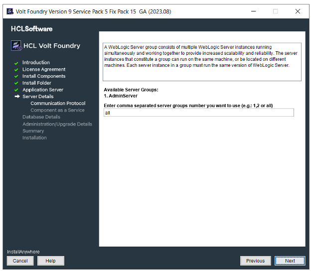

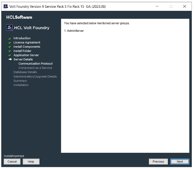

    2. Click Next. The Server Groups window appears.
      A WebLogic Server group consists of multiple server instances that run simultaneously on the same machine or on different machines. Volt Foundry supports WebLogic Servers and WebLogic Clusters.
    3. Enter server groups separated by commas - for example, 1, 2, shown in the previous step. Click Next. The system displays the selected groups in the Selected Server Group window, shown below:

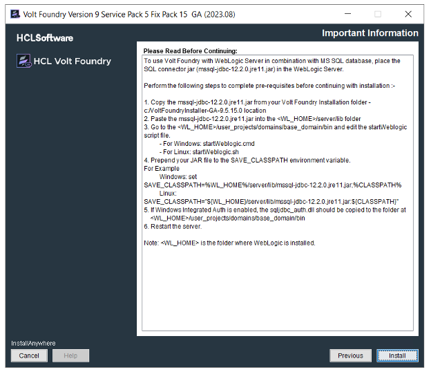

    4. Click Next. The following screen appears for WebLogic connector Jar.
      • MS SQL: If you want to install Volt Foundry on WebLogic with MS SQL, you must place the SQL connector jar ( mssql-jdbc-7.2.2.jre11.jar ) in the WebLogic Server path.
        For more details, follow the below steps:
        To use Volt Foundry with WebLogic Server in combination with MS SQL database, place the SQL connector jar (mssql-jdbc-7.2.2.jre11.jar) in the WebLogic Server.
        Perform the following steps to complete pre-requisites before continuing with installation :
        1. Copy the mssql-jdbc-7.2.2.jre11.jar from your Volt Foundry Installation folder.
        2. Paste the mssql-jdbc-7.2.2.jre11.jar into the <WL_HOME>/server/lib folder
        3. Go to the <WL_HOME>/user_projects/domains/base_domain/bin and edit the startWeblogic script file.
          For  Windows: startWeblogic.cmd
        4. Prepend your JAR file to the SAVE_CLASSPATH environment variable.
          set SAVE_CLASSPATH=%WL_HOME%/server/lib/mssql-jdbc-7.2.2.jre11.jar;%CLASSPATH%
        5. If Windows Integrated Auth is enabled, the sqljdbc_auth.dll should be copied to the folder at: <WL_HOME>/user_projects/domains/base_domain/bin
        6. Restart the server.
          Note: <WL_HOME> is the folder where WebLogic is installed.

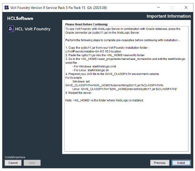

      • Oracle: To use Volt Foundry with WebLogic Server in combination with Oracle database, you must place the Oracle connector jar (ojdbc8.jar) in the WebLogic Server path.
        1. Copy the ojdbc8.jar from your Volt Foundry Installation folder.
        2. Paste the ojdbc8.jar into the <WL_HOME>/server/lib folder
          set SAVE_CLASSPATH=%WL_HOME%/server/lib/ojdbc8.jar;%CLASSPATH%
        5. Restart the server.

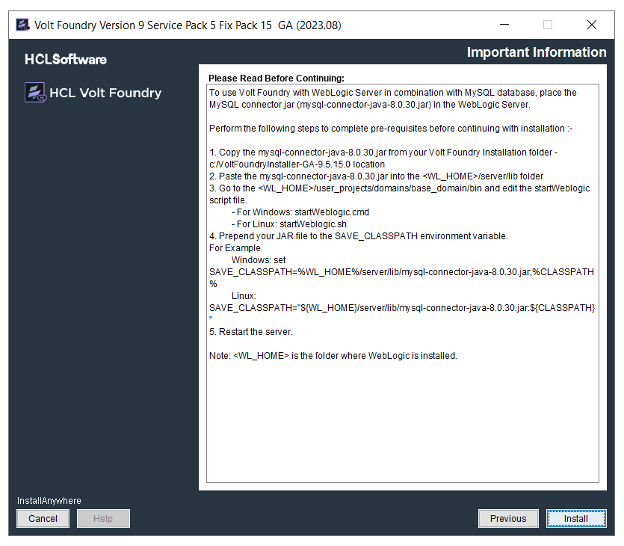

      • MySQL: To use Volt Foundry with WebLogic Server in combination with MySQL database, you must place the MySQL connector jar (mysql-connector-java-8.x.x) in the WebLogic Server path.
        1. Copy the mysql-connector-java-8.x.x from your Volt Foundry Installation folder.
        2. Paste the mysql-connector-java-8.x.x into the <WL_HOME>/server/lib folder
          set SAVE_CLASSPATH=%WL_HOME%/server/lib/mysql-connector-java-8.0.12.jar;%CLASSPATH%

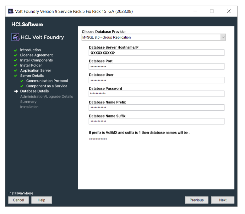

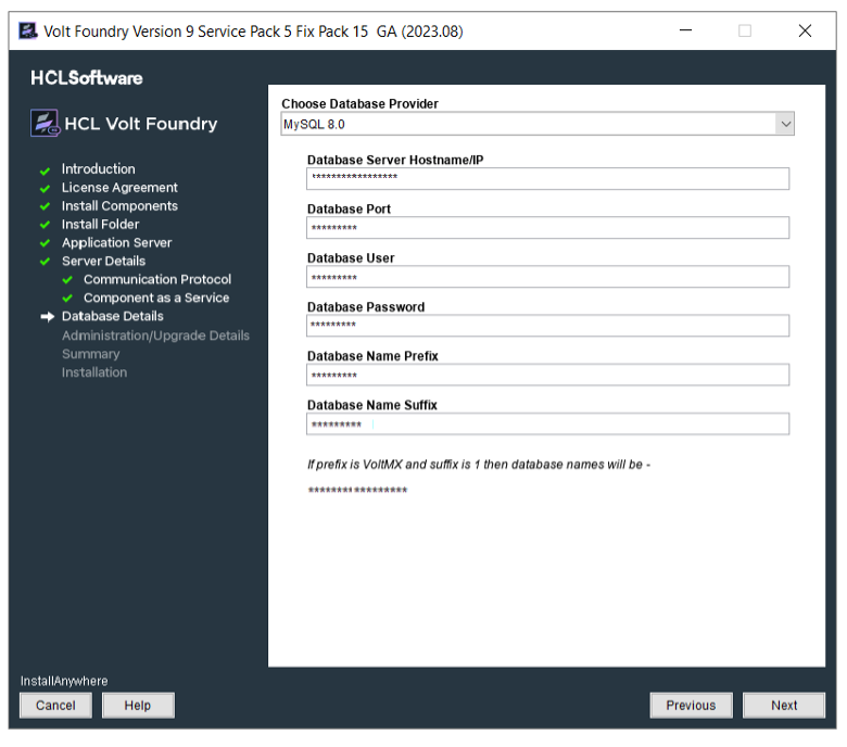

  8. Click Next. The Database Details window appears. From the Database Choice drop-down, choose one of the databases to display database details and fill the details. By default, this option is set to MySQL.
    1. Enter the following database details for MySQL.
    2. MySQL Cluster - Group Replication is a new replication type supported from MySQL 5.7 onwards. In case your Foundry setup consists of a MySQL Cluster with Group Replication, please select the same from the list of Database Type Providers instead of the default MySQL option.
      • Database Server Hostname/IP: Enter the DB server Hostname/IP to be used to create a database of selected components of Volt Foundry. By default, the server Hostname/IP is set as localhost.
      • Database Port: Enter the database port of the MySQL Server. By default, this field is set to 3306 for MySQL.
      • Database User: Enter the user name used while creating the database user - for example, dbclient.
      • Database Password: Enter the user password used while creating the database user.
      • Database Name Prefix: Enter the valid prefix databases - for example, Volt MX.
      • Database Name Suffix: Enter the valid suffix for all databases - for example, 1.

    • management_server_host_name <application_instance hostname>
    • management_server_port <soap port of application_instance>
    • management_server_user <application_instance admin username>
    • management_server_password <application_instance admin password>
    • management_server_groups <application_instance groups details>
  11. Enter the databases details, and click Next. The Pre-Installation Summary window appears.

    Once the installation completes, the Install Complete window appears with the confirmation message.
  13. Click Done to close the window.
    Note: You can now access Volt Foundry Console by using the URLs. For more details, refer to Accessing Volt Foundry Console - On-premises.
