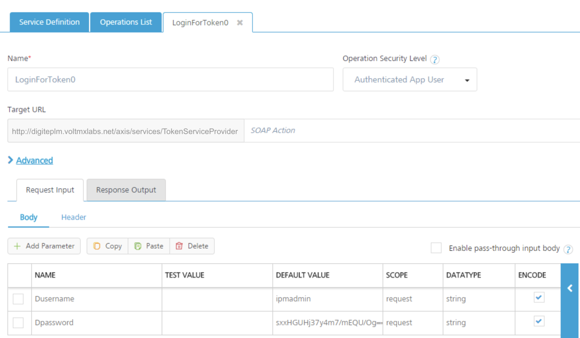

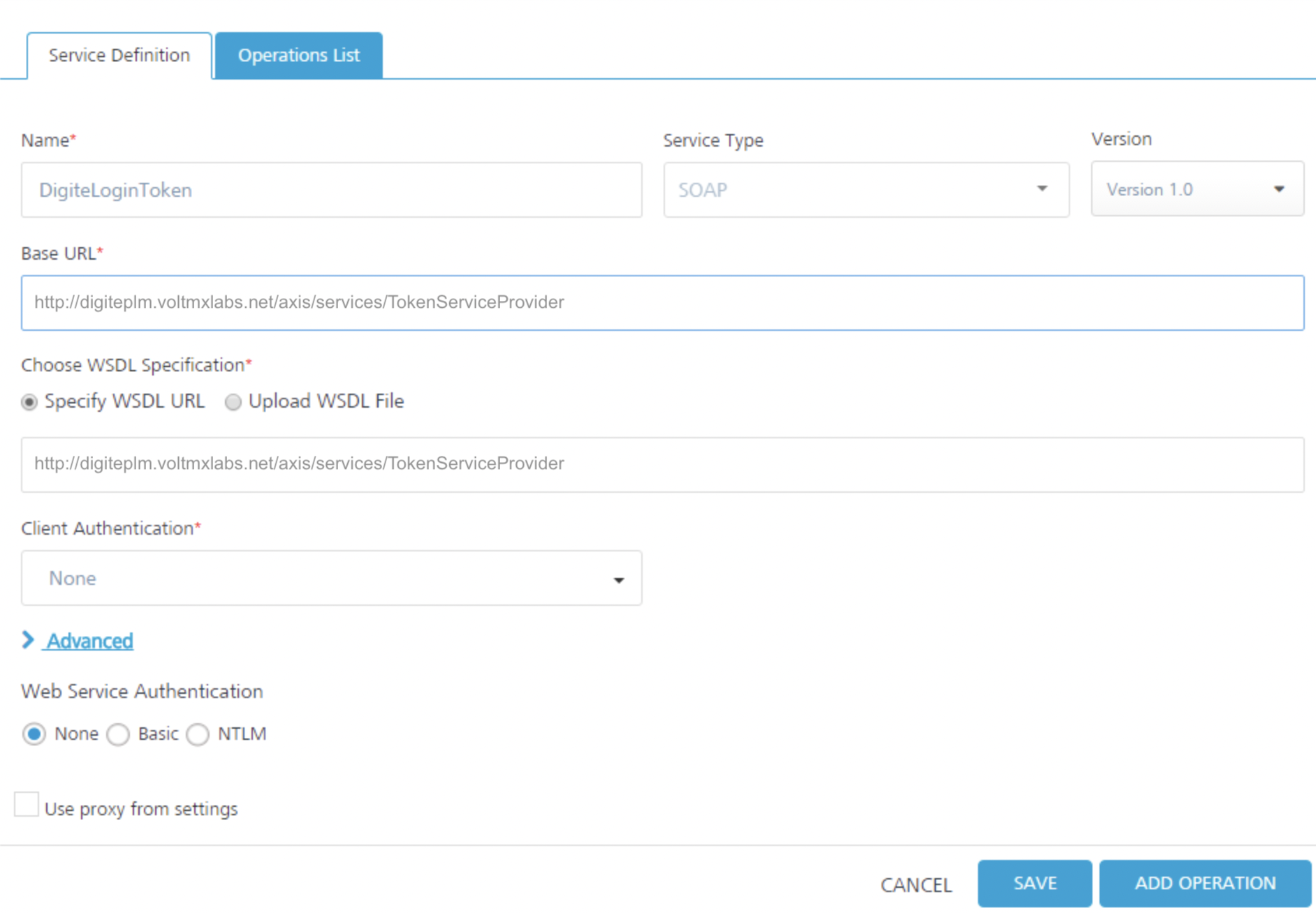

DigiteLoginToken Service
The first integration service is named DigiteLoginToken. The type of integration service is SOAP. The given base URL is specified, and the given WSDL URL is specified.
The DigiteLoginToken service has one operation, LoginForToken0. The operation provides the parameters for the username and password for the defect management system.

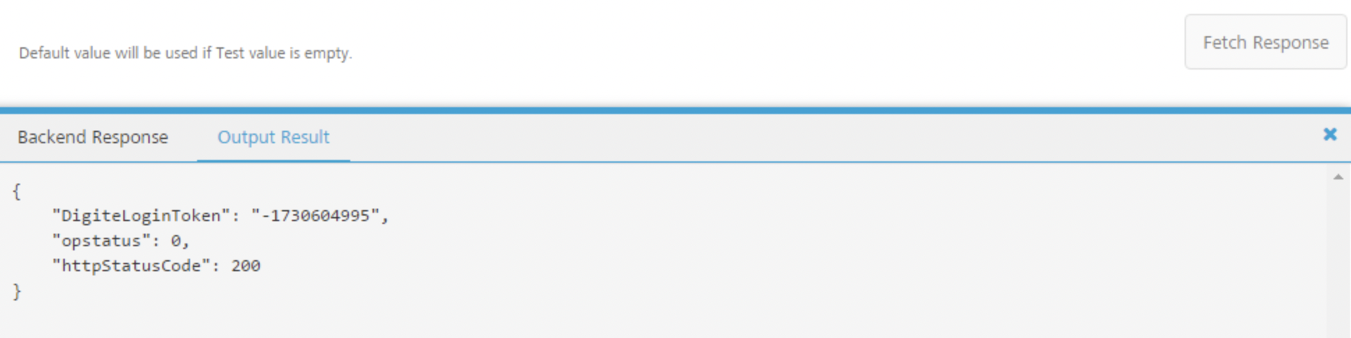

If you click Fetch Response, the defect management system back end returns a token in the output result. The token that must be sent along with every request to access data in the back end.

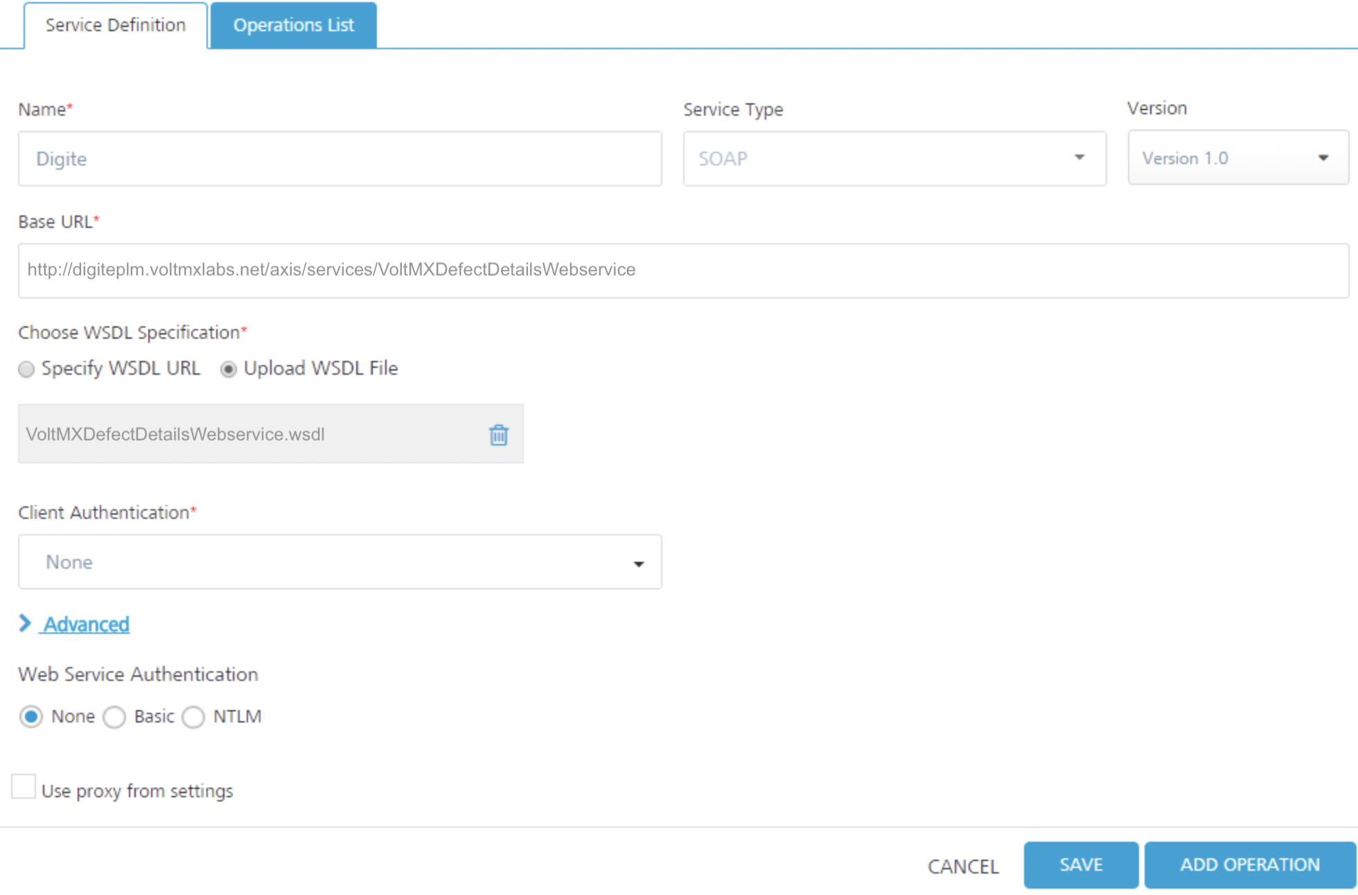

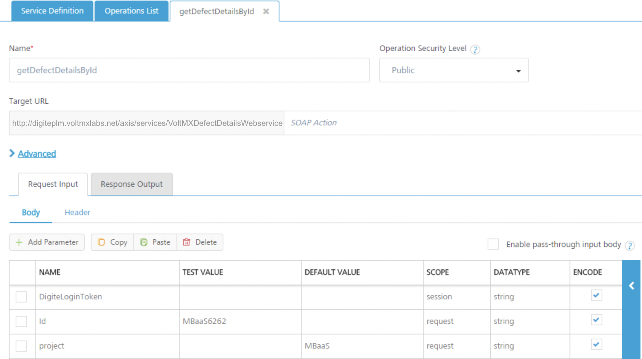

Digite Service
The second integration service is named Digite. The type of integration service is SOAP. The given base URL is specified, and the given WSDL file to upload to the VoltMX Foundry app is specified.

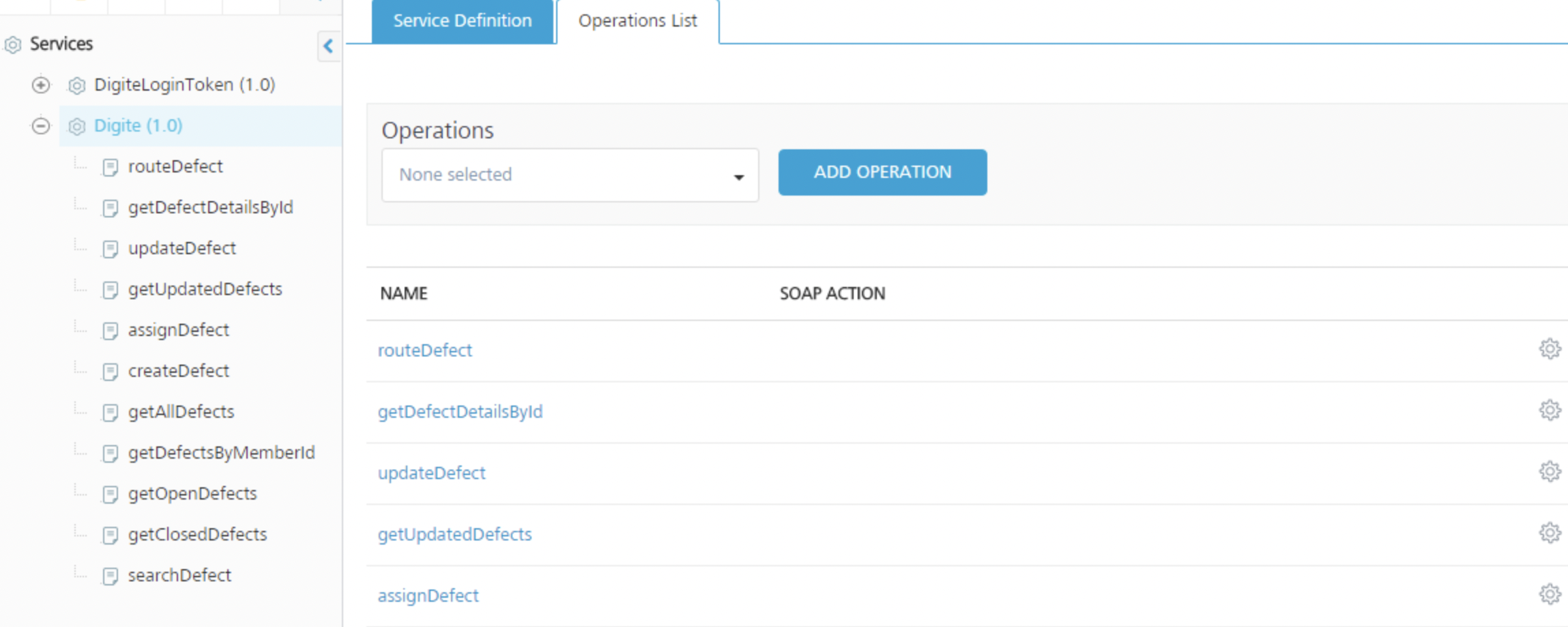

The Digite integration service has operations for accessing and performing actions on the defect management system.
The getDefectDetailsById operation includes the DigiteLoginToken parameter for passing the token that the back end expects with every request. The scope of the DigiteLoginToken parameter is session. This means that VoltMX Foundry picks up the parameter up from the session that is created for the app.
If you click Fetch Response, the service sends to the defect management system back end the DigiteLoginToken that was retrieved earlier. The service also sends the defect ID and project parameters. The back end will respond by sending all the details related to the specified defect ID, MBaaS6262, in the specified project, MBaaS.

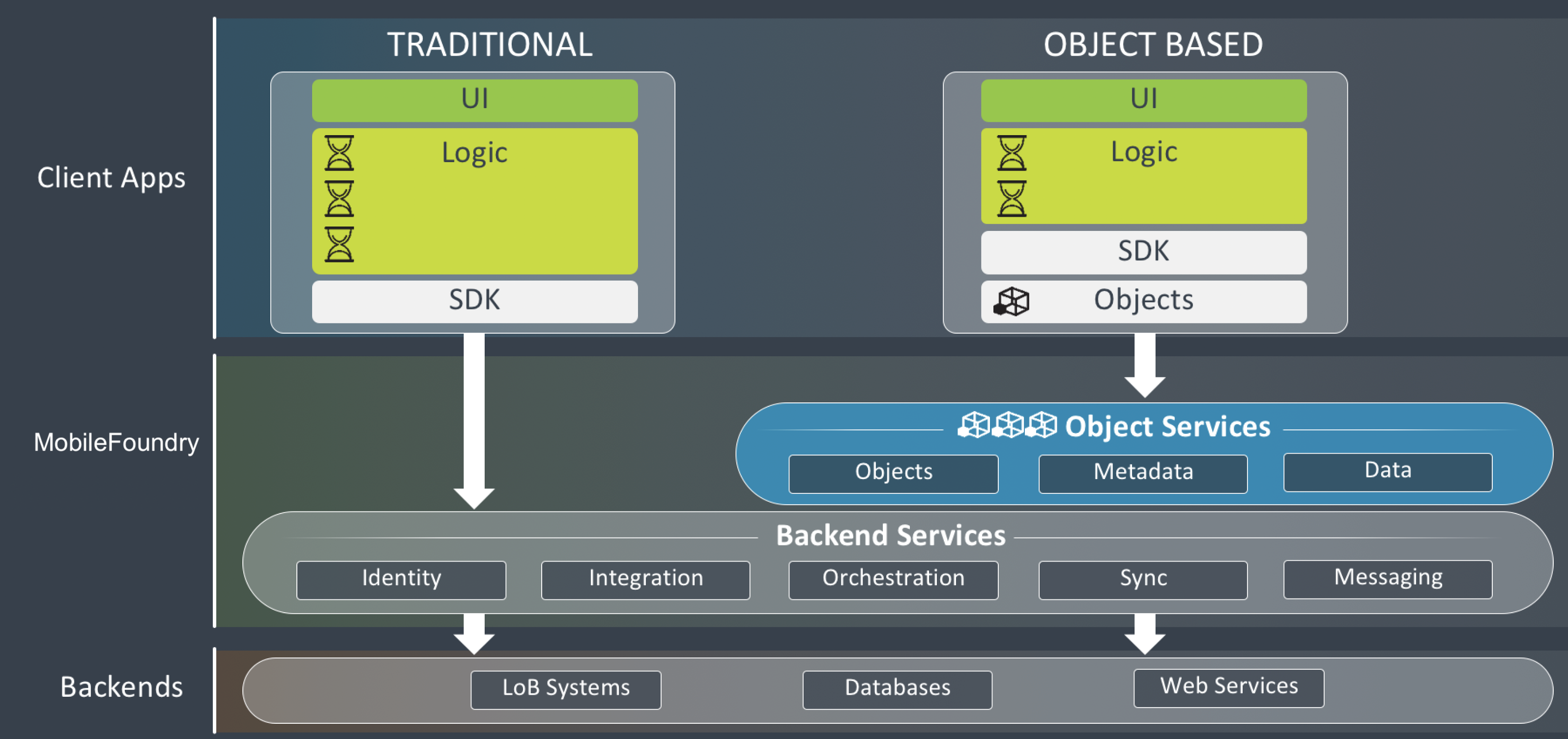

Traditional App Development and Object-Based App Development
With the integration services complete, you have imported the WSDL from the defect tracking system and turned it into a REST API. You can stop at this point and proceed to develop the client app in the traditional way by simply calling those new REST APIs from the client app. Or you can go to the Objects tab and perform a few extra steps to turn the WSDL into a service-driven object, and reduce the amount of logic that you must write in the client app.
The following diagram shows the Object Services layer that is built on top of these other VoltMX Foundry services. When using VoltMX Foundry object services, the client developer is given an SDK and the generated client object code. This reduces the amount of logic that the client developer must write, and significantly reduces the effort required to develop the mobile app.

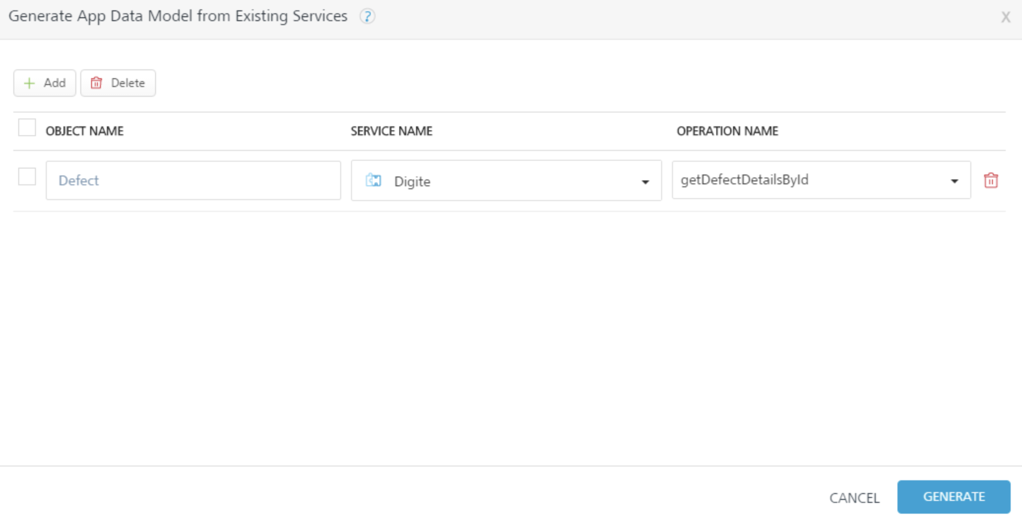

  6. Click Generate.
The Generate App Data Model from Existing Services screen appears.
  1. Click the Add button.
  2. Click in the Object Name field, and enter Defect.
  3. Click in the Service Name field. A drop-down menu appears. Select the Digite integration service.
  4. Click in the Operation Name field. A drop-down menu appears. Select getDefectDetailsById.
  1. Click Generate.
VoltMX Foundry generates the objects and the data model based on the getAccount and getContact operations in the Salesforce integration service. All the fields for the objects are populated from the union of what is sent to the specified operation and what is returned from the operation.

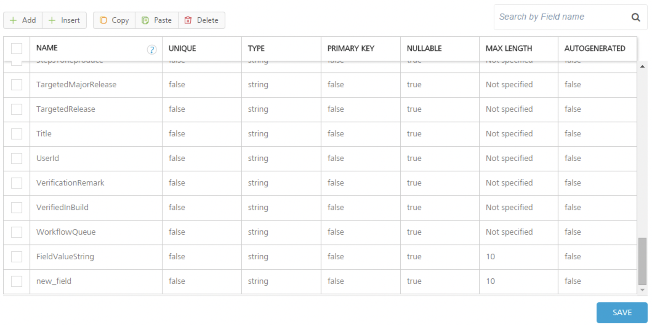

Now add three additional fields to the Defect object for this defect management system.
To add fields to the Defect object, follow these steps:
  1. In the Data Model navigation pane, click the plus button next to Defect, and click Fields.
  2. Click the Add button.
  3. In the new field that is added to bottom of the list, enter FieldValueString for the name of the new field.
  4. Click the Add button.
  1. In the new field that is added to bottom of the list, enter Action for the name of the new field.
  3. In the new field that is added to bottom of the list, enter Comment for the name of the new field.
  4. Scroll up to the ID field.
  5. For the ID field, click Primary Key. Select true.
  6. Click Save.

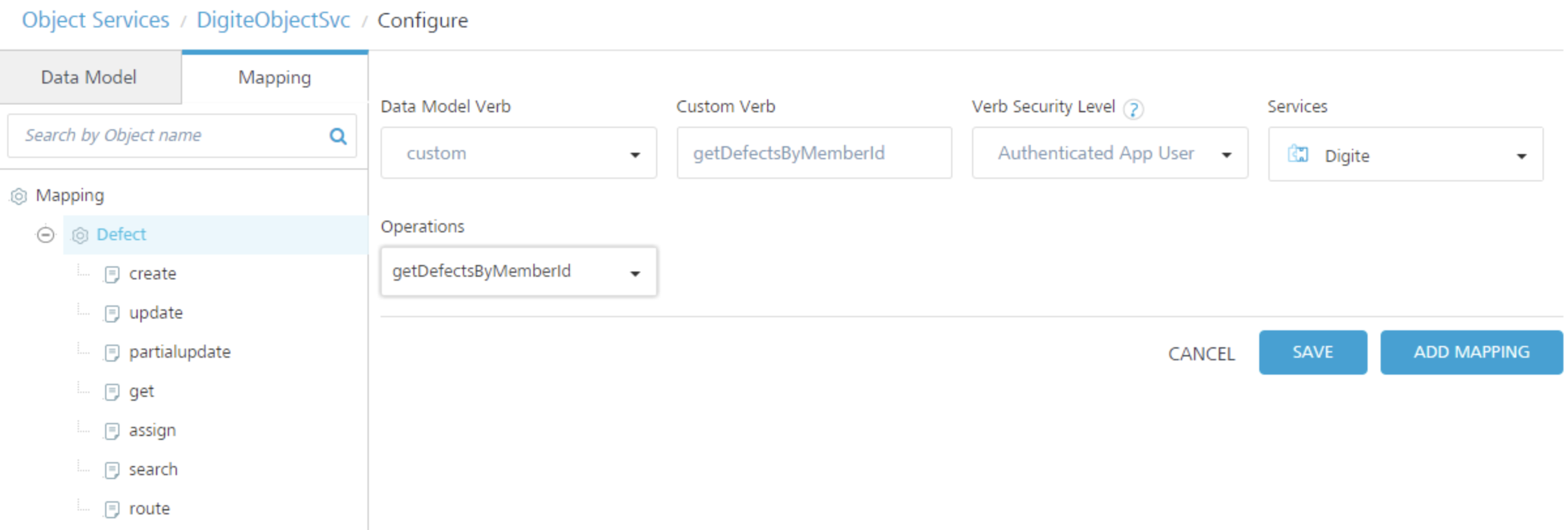

Now map the verbs for the Defect object. To perform operations beyond the basic create, read, update, and delete operations, you can create custom verbs.
To map the verbs for the Defect object, follow these steps:
In addition to the built-in verb options, you can also create custom verbs for an object. For example, you can create the custom verb assign, and map it to the assignDefect operation on the back end. Click here for more details.
To create and map the custom verbs for the Defect object, follow these steps:
  1. In the navigation pane, on the Mapping tab, click the Defect object.
  3. Click in the Data Model Verb field. A drop-down menu appears. Click custom.
  4. Click in the Custom Verb Field and enter assign.
  5. Under Verb Security Level, use the default security level that is selected, Authenticated App User.
  6. Click in the Services field. A drop-down menu appears. Select the Digite integration service.
  7. Click in the Operations field. A drop-down menu appears. Select assignDefect.
  8. Click Save.
The mapping for the verbs is automatically generated by default. The mapping tabs show the automatically generated mapping of the object applied to this verb.
  1. Repeat steps 2 through 8. Create the custom verb search, and map it to the searchDefect operation.
  2. Repeat steps 2 through 8. Create the custom verb route, and map it to the routeDefect operation.
  3. Repeat steps 2 through 8. Create the custom verb getDefectsByMemberId, and map it to the getDefectsByMemberId operation.
  1. Click Save.
