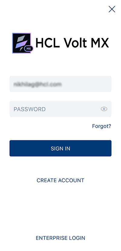

Sign in to your Volt MX account by entering your username and password. If you want to bypass entering your login credentials the next time you run the app, select Remember me. Then, tap Sign In.

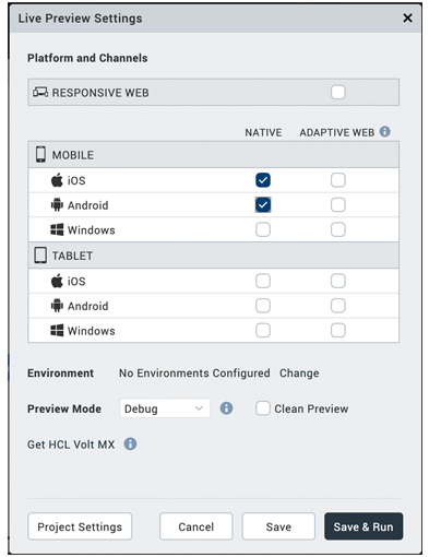

Local. On the Preview menu, click Configure Channels.
- The Live Preview Settings windows appears. Select the platformsThe operating system of a given device. iOS and Android are examples of platforms. and channelsDevice types available within a given platform. These include mobile (i.e. phone), tablet, and desktop. that you want the Volt MX Appto support.
- Click Save & Run. App User Guide builds the local preview. To view it, see Preview an App Locally.

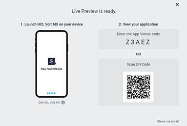

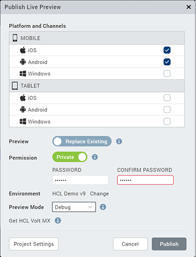

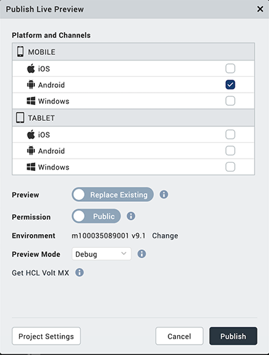

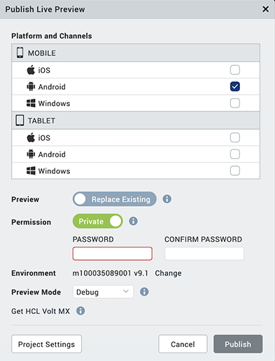

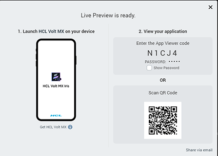

Cloud. On the Preview menu, click Publish. The Publish Live Preview window appears.
Select the platformsThe operating system of a given device. iOS and Android are examples of platforms. and channelsDevice types available within a given platform. These include mobile (i.e. phone), tablet, and desktop. that you want to publish.
- If the project has an existing preview with a publish code, the Publish Live Preview window displays a Preview option.
Toggle the Preview switch to Create New option to publish the app to a new cloud account. If you have access to the app's account, Replace Existing is selected by default, so that the preview you are publishing replaces the existing preview, under that same publish code.
Important: Make sure you select the Volt MX Foundry environment you want to use.
- If you want to password-protect the preview, toggle the Permission to Private.
- Enter a password, and then re-enter it in the Confirm Password text box.
- You can change the Preview Mode to Debug, to be able to debug the app. Run mode is selected by default.
Click Publish.

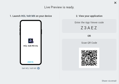

App User Guide proceeds to publish the app, as indicated by the progress bar. Depending on the size of your application and the speed of your internet connection, uploading an application may take some time. Once the application is uploaded to your Volt MX account, a publish code is generated as shown here. Also, if you selected the Permission to Private, the password you entered is displayed as well.

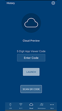

Note: The publish code is essential for viewing the preview of the application, and can contain numbers and uppercase letters.
You can easily share the publish code and password by clicking Share Via Email. A New Message window from your default mail client (for example, Outlook) appears. The code, along with the steps for viewing the preview of the app, is auto-generated in the body of your new email message. Add the email address of all the stakeholders to whom you want to give access to the preview of the application, and then send the email.
Once you have generated a preview of the app, the publish code appears in the status bar located over the Properties Editor.

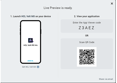

App User Guide proceeds to publish the app, as indicated by the progress bar. Depending on the size of your application and the speed of your internet connection, uploading an application may take some time. Once the application is uploaded to your Volt MX account, a publish code is generated as shown here. Also, if you selected the Access Settings to Protected, the password that you entered is displayed as well.From Volt MX Iris V8 SP3 onwards, a QR code is displayed along with the Publish code. This QR code helps in auto-populating the required data in your device for ease of viewing your application.
You can easily share the publish code and password by clicking Share Via Email. A New Message window from your default email client (for example, Outlook) appears. The code, along with the steps for viewing the preview of the app, is auto-generated in the body of your new email message. Add the email address of all the stakeholders to whom you want to give access to the preview of the application, and then send the email.

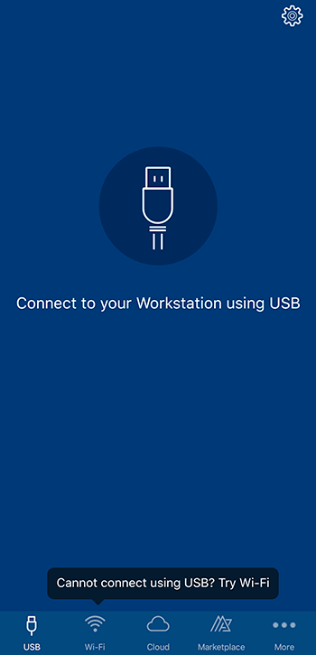

- Establish a USB connection between the computer(Workstation) that generated the preview, and the device.
- Tap the VoltMX App on your device. The application is launched.
- If necessary, provide your Volt MX account credentials on the sign-in page and tap Sign In.
- Tap the USB tab on the Volt MX App tray to display the USB Preview page, if it is not already visible.
- The Volt MX App automatically connects to Iris on the computer, and previews the application for which you have performed the Preview > Run command on Iris.

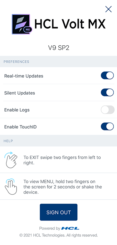

If you want the incremental preview changes that take place on App User Guide to be automatically reflected in the preview of the device, enable Real Time Updates. Additionally, when you enable Real Time Updates, you can opt to enable Silent Updates.
When enabled, the Silent Updates feature refreshes the preview any time you select Run on App User Guide, so that the preview reflects the incremental changes made during the last build. If Silent Update is disabled but Real Time Updates is enabled, when you select Run on App User Guide to initiate an incremental preview to incorporate your latest project changes, the Volt MX App shows a dialog box. In the dialog box, the Volt MX App prompts you that an update is available and asks if you want to refresh the preview. Selecting No keeps the current preview, while selecting Yes refreshes the Volt MX App, thereby loading the latest build.Important: You can enable or disable the Real Time Updates and Silent Updates options from the Settings page on the Volt MX App.

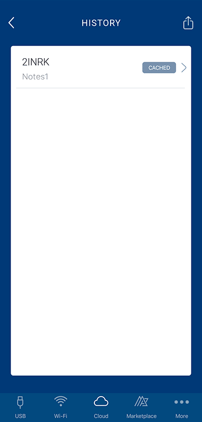

Tap the preview project name that you want to see. This name is identical to the name of the project on App User Guide.
Alternatively, you can tap the History icon at the bottom of the screen to see a list of previews previously viewed on the device. If you have signed in by using your Volt MX credentials, the previous preview can be stored on the cloud and can be accessed on any device by using the same cloud credentials.
If the preview is cached locally on the device so that it can be viewed without a wireless or USB connection, the preview's listing includes a Cached status. If the preview has an update available for download, its listing includes an Update status.
Note: To email information about the preview to a recipient, click the email icon
. Included in the email is the App Viewer ID, and for each platform, the preview's name, short notes, and timestamp.
- Tap the App Viewer ID of the preview that you want to see.
- To cache the preview locally on the device so that you can view it without a wireless connection, activate the Caching slider.

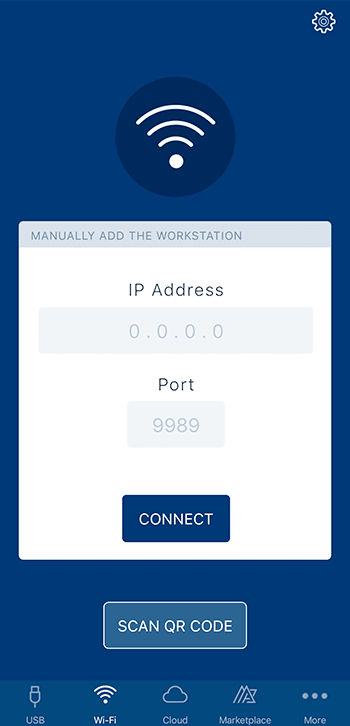

Preview an App by using a Wi-Fi connection
Important: Your computer and your mobile device must be connected to the same wireless network.
To view the preview of your prototype locally, follow these steps:
- If necessary, provide your Volt MX account credentials on the sign in page, and then tap Sign In. The Volt MX App displays its home screen.
Tap Wi-Fi on the Volt MX App tray to display the WiFi preview page.
From the list of available Iris workstations, tap the computer hosting the app that you want to preview.
Or, tap Scan QR Code and scan the QR code displayed on Volt MX Iris after generating a preview.
Note: The default port used for a Enterprise app is port
8888, and is different from that used for a Volt MX Iris app. The Starter app uses the9989port. If you choose to change the port, it is written to the install location in theglobalPreferences.jsonfile.

If you want the incremental preview changes that take place on App User Guide to be automatically reflected in the preview on the device, enable Real Time Updates. Additionally, when you enable Real Time Updates, you can opt to enable Silent Updates.
When enabled, the Silent Updates feature refreshes the preview any time you select Run on App User Guide, so that the preview reflects the incremental changes made during the last build. If Silent Update is disabled but Real Time Updates is enabled, when you select Run on App User Guide to initiate an incremental preview to incorporate your latest project changes, the Volt MX App displays a dialog box. In the dialog box, the Volt MX App prompts you that an update is available and asks if you want to refresh the preview. Selecting No keeps the current preview, while selecting Yes refreshes the Volt MX App, thereby loading the latest build.Important: You can enable or disable the Real Time Updates and Silent Updates options from the Settings page on the Volt MX App.

Preview an App on the Cloud
This procedure assumes that you have already generated a preview on App User Guide. For more information, see Generate a Preview of the App.
A French version of the Volt MX App is available. To view the Volt MX App in French, set your device's language to French (for Apple devices, also set the region to France), and then restart the Volt MX App.
To view the preview of your prototype on the cloud, follow these steps:
- Tap the VoltMX App on your device. The application launches.
- Tap Sign In.
Do any one of the following:
If your company's Volt MX account uses standard authentication, enter your Volt MX credentials and tap Sign In.

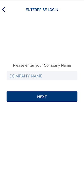

If your company has a custom authentication arrangement with VoltMX: tap Enterprise Login, enter your Enterprise Identifier/ Company Name, tap Next, enter your Volt MX credentials and tap Sign In.
- If the Cloud Preview screen does not appear, tap the Cloud icon at the bottom of the screen.
The VoltMX Iris Cloud Preview is displayed, from which you can launch a preview in two ways: by either launching by using the App Viewer ID, or opening a previous preview from the History screen:
Launch by using the App Viewer ID. If it is not already highlighted, tap the Cloud icon at the bottom of the screen. Next, tap the Enter Code field, type the publish code for the preview you just published, and tap the Launch button. Or, you can just tap the Scan QR Code button to auto-populate the required details and preview the app.
While generating the preview of the app on App User Guide, if you selected the Access Settings to Protected and set up a password, when you tap the Launch button, you are prompted to enter the app password.
Open a previous preview. Tap the History icon at the bottom of the screen to see the list of previews previously viewed on the device. A previous preview can be stored on the cloud and can be accessed on any device by using the same cloud credentials. If the preview is cached locally on the device, it can be viewed without a wireless connection; the Volt MX App's listing includes a Cached status. If the application preview has an update available for download, its listing includes an Update status.
When you open the History page, it initially shows the app previews stored on your cloud account. You can pull to refresh the screen and load the latest app previews stored in your cloud account.
Tap the App Viewer ID of the Project Name that you want to preview.
The preview gets downloaded to your device and is displayed. You can now move around on the Volt MX App and run any actions attached to it.

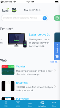

To view Marketplace applications on the Volt MX App:
- In the Volt MX App, click HCL Forge . The HCL Forge page appears with components and applications.
- Browse through the components and applications.

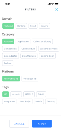

You can search for a specific component by typing its name or by anpplyig related filters in the search option.
- Tap Preview to view the details of the component. The Preview button does not appear for components that do not have their preview available. You can tap the play icon to play the video of the component.
- To view an application, tap the application. The application page is displayed.
Tap Preview. The application opens, and you can verify the application functionality.
