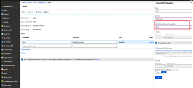

  6. Can I configure an additional email address for alert notifications?
    Yes, you can provide an additional email address for alert notifications. To do so, you need to select the Azure role to configure sending alert notifications in the Azure portal. Perform the following steps:
    1. Log in to Azure portal.
    2. Select Monitor, click Manage action groups.
    3. Edit the action group for which the email IDs needs to be added.
    4. Select the role from the given list, as illustrated in the following image.
