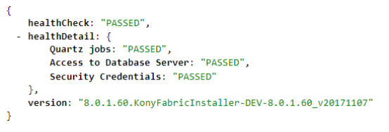

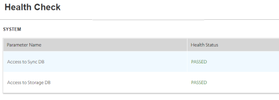

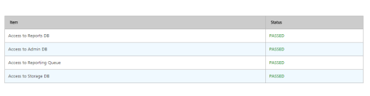

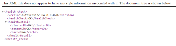

Test the Setup
Use the following Healthcheck URLs post-deployment to check the status of a Volt MX Foundry component on each node:
For Volt MX Foundry console: http://
: /mfconsole/health_check/all
For Middleware: http://
: /services/healthcheck
For Auth Service: http://
: /authService/v1/manage/checkhealth
For Sync: http://
: /syncconsole/healthcheck
For Messaging: http://
: :53409/vpns/service/healthcheck/json
