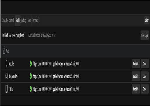

Access to the Published URL within
Once the publish is complete, the published URL is displayed on the Build tab in . When you click the URL, the Iris Preview window opens. For more information on the Iris Preview window, click here.
You can also click on Copy beside the URL to copy it and view the app in a web browser of your choice.
The Build tab in Iris displays the status of your app publish. If there are any errors, they appear in the Build tab. You can switch to the Console tab for a detailed view of the error logs.

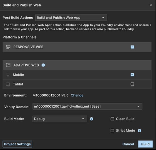

The Build and Publish Web option in builds the application for the selected Web platforms and performs the selected Post Build Action. You must choose the Post Build Action in the Build and Publish Web window, before the build process begins. There are three types of Post Build Actions:
- Build and Publish Web App – This action publishes the application to your environment.
- Publish to my App Store – This action publishes the Web application to your Enterprise App Store.
- Generate Web App – This action generates the archive for your Web application and saves it on your file system.
The Post Build Action is initiated after the Build is complete.

From the main menu of , select Build > Build and Publish Web.
The Build and Publish Web window appears.
Select the required Platforms and Channels for which you want to build and publish your web app.
- From the Post Build Action drop-down menu, select the desired Post Build Action. For more details about the Post Build Action, click here.
- From the Build Mode drop-down list, select your desired build mode.
- You can choose to change the cloud environment on which your app will be published. To do so click on Change beside the Environment option.
- Once all the required settings are ready, click Build.
The progress of the Web App Publish is displayed in the Build tab of Iris.
Once the publish process is complete, a Web App URL appears on the Build tab. - Click on the generated URL to preview your Web app in the Live Preview mode.
The Iris Preview window appears. You can use this window to debug the application. - You can also click on Copy to copy the URL to your clipboard and view it in a web browser of your choice.
- Click on View Logs to access the logs of the publish process.
- An Application was deployed mail will also be sent to your registered e-mail account. This mail will contain the App details along with the App URL. Click on the URL in the mail to open the web app in your default web browser.
