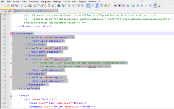

Update Listen Interfaces in host.xml for JBoss Cluster
For JBoss domain mode installation, configure the following interface address.
  1. Go to <JBOSS EAP dir>/domain/configuration/host.xml
  2. In place of existing  interfaces xml tag, replace the default content with below details:
        <interfaces>
                <interface name="management">
                    <any-ipv4-address/>
                </interface>
                <interface name="public">
                    <any-ipv4-address/>
                </interface>
                <interface name="unsecure">
                    <!-- Used for IIOP sockets in the standard configuration.
                        To secure JacORB you need to setup SSL -->
                    <any-ipv4-address/>
                </interface>
                <interface name="any">
                    <any-ipv4-address/>
                </interface>
        </interfaces>
