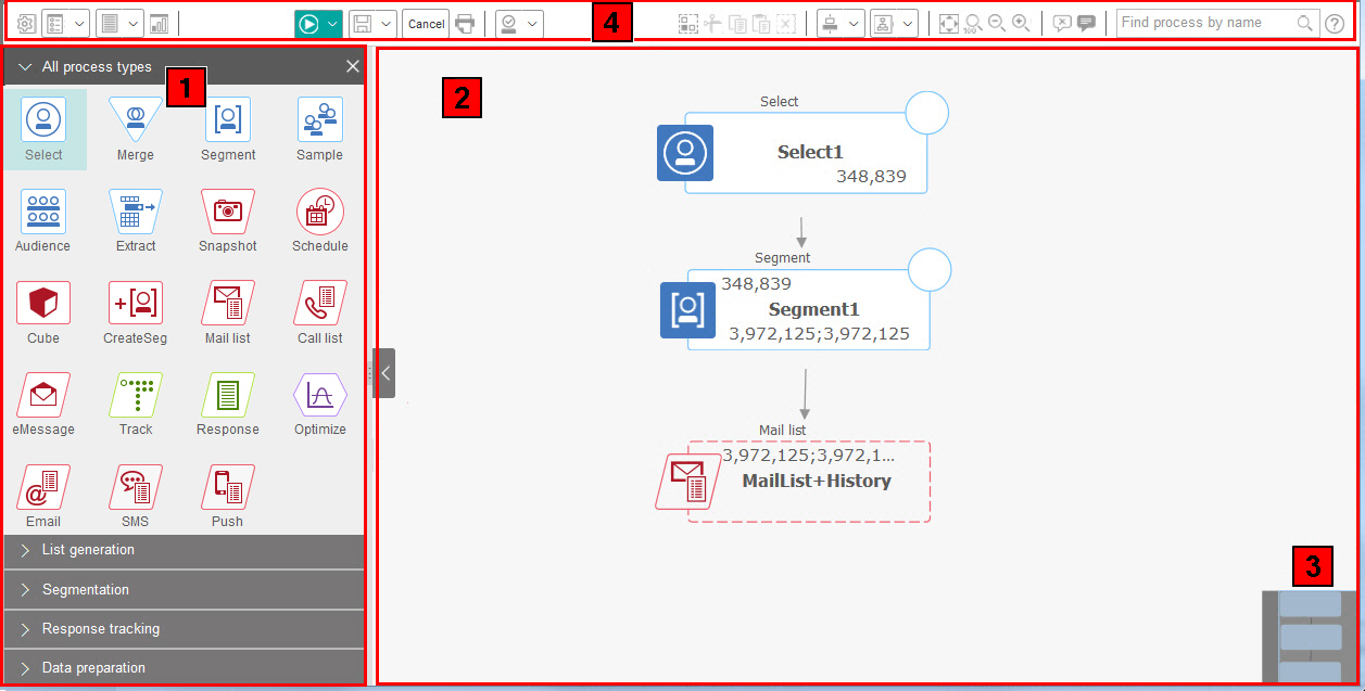

The flowchart workspace consists of the following elements.
| Element | Description | |
Palette (Edit mode only) |
The palette at the left side of the window contains processes that you use to build your flowchart. It is visible only in Edit mode. Drag a process from the palette to the workspace, then configure and connect processes in the workspace. By default, all process types are displayed. Click a category (List generation, Segmentation, Response tracking, Data preparation) to view a subset of processes. To resize the palette, drag the edge of the palette area to widen or narrow it. To hide or show the palette, click Hide palette (gray arrow) or Show palette. |
Main workspace area |
In View mode, you can view but not modify process boxes and you can perform a limited set of operations. In Edit mode, you can configure and connect processes to determine the workflow and behavior of the flowchart. Right-click any process box to open a menu of options. To configure a process: Double-click it, or right-click it and choose Process configuration. To connect processes: Rest the cursor over a process box until four arrows appear, then drag a connection arrow to another process box. |
Panning area |
Use the panning area to highlight the portion of the flowchart that you want to see. This visual representation of the workspace is useful when not all of the process boxes fit on the screen at the same time. |
Flowchart toolbar |
Use the buttons and menus in the toolbar to perform the actions that are described in the
following table. Rest your cursor over each item to see what it does. To open a menu, click its
down-arrow |
The flowchart toolbar contains the following icons and menu options.
