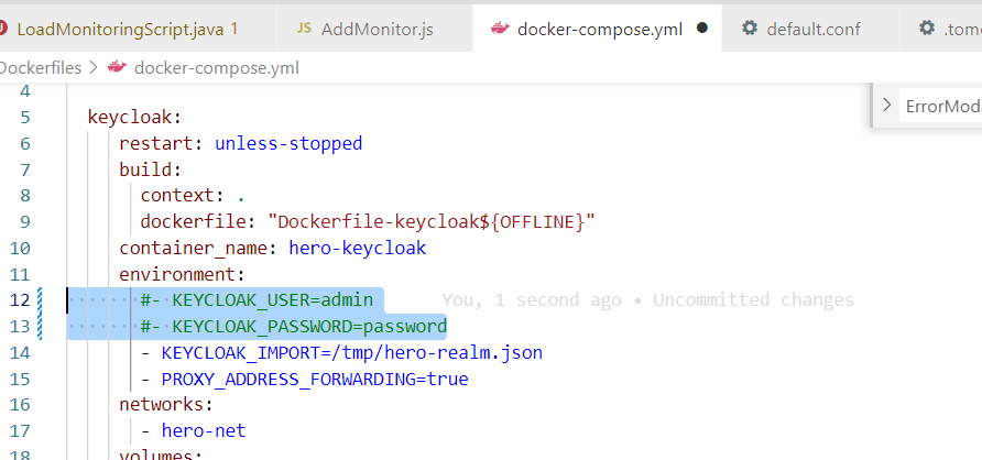

Symptom
After you run the command docker-compose up, keycloak container starts to crash, and docker tries to re-launch it in endless loop.
Cause and solution
 To solve this issue, run the following steps:
  1. Run the command docker-compose down.
  2. Edit the docker-compose.yml file and comment out the KEYCLOAK_USER and KEYCLOAK_PASSWORD parameters, like in the following example:
  1. Run the command docker-compose up.
