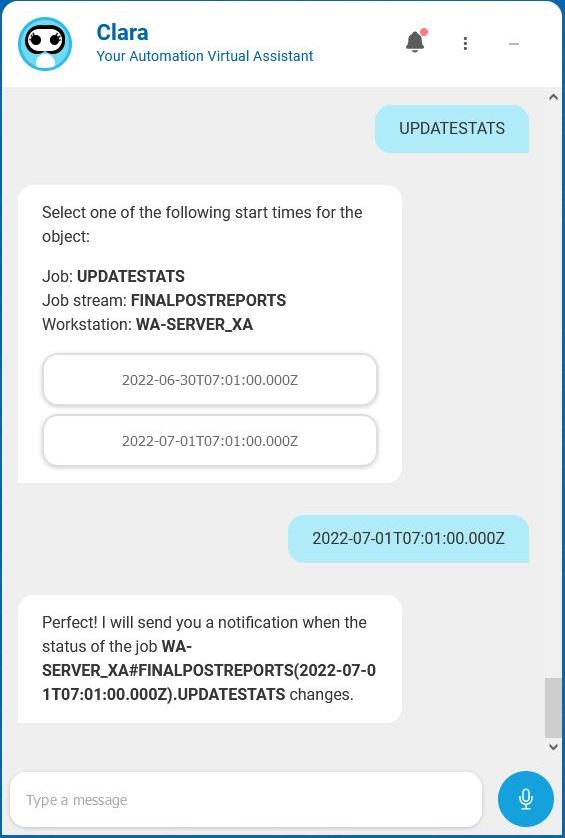

Clara can monitor a job and send you notifications when the job status changes.
To receive Clara notifications, you must first enable notifications in your browser. For details, see: How to enable persistent notifications. If you skip this step, Clara warns you with a message and provides a button to enable the notifications.
To monitor a job and receive Clara notifications, run the following steps:
Among the actions Clara can help you with, select Monitoring and environment info > Monitor a job.
When required by Clara, provide the job name, the job stream name, and the workstation name for the job you want to monitor. For details, see Searching for a job.
Clara starts monitoring the job. She checks the job status at time intervals depending on the estimated duration of the job, and notifies every status change.

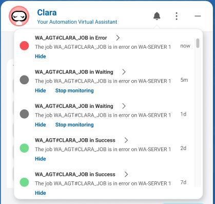

A red dot appears on the bell on the chat header meaning that you have unread notifications. An e-mail with the new job status is also sent to the e-mail address you have specified during the Add User flow, on the Credential Manager user interface.
To view the notification messages, click the bell. A panel appears, showing the notification queue. A maximum number of 10 notifications is kept for a week.
For each notification, you can run the following actions:
By clicking on each notification, you can get the timestamp of when the status change occurred.

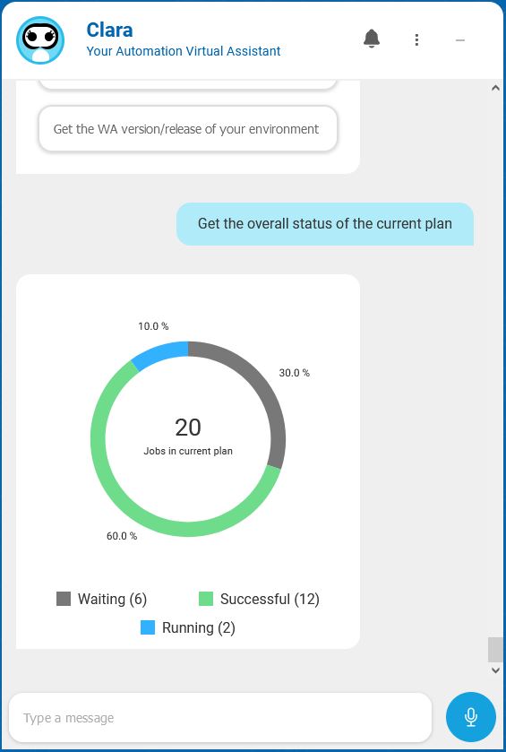

As a Workload Automation administrator, you might need to check the status of the current plan. Run the following steps:
Among the actions Clara can help you with, select Monitoring and environment info > Get the overall status of the current plan
Clara provides an interactive segmented donut chart where each color corresponds to a job status. By clicking each segment of the chart, you get the number of jobs in that specific status.

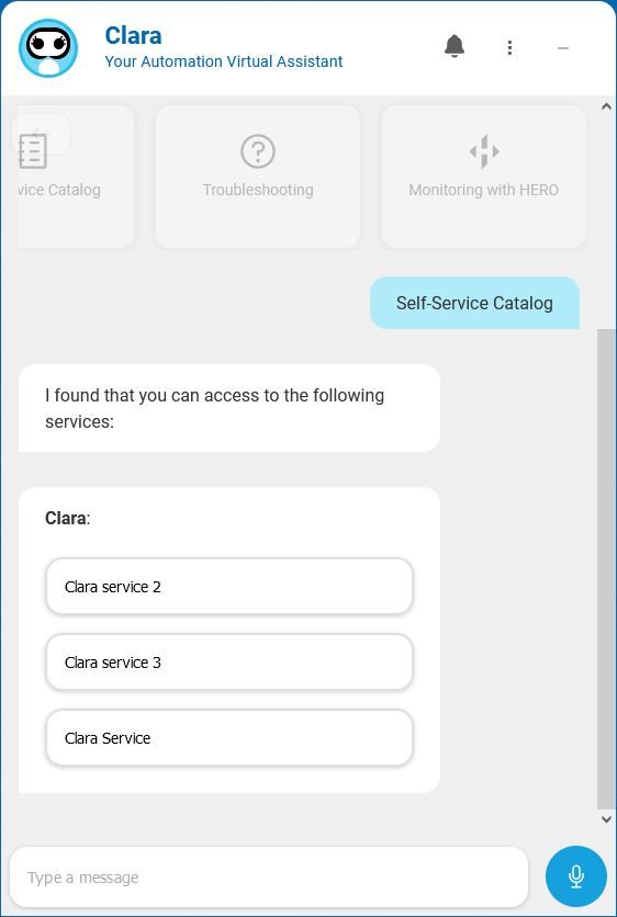

From V2.0.0.2, Clara supports the new Self-Service Catalog introduced by HCL Workload Automation V10.1 fix pack 1. For details about the new Self-Service Catalog and its prerequisites, see HCL Workload Automation documentation.
Ensure you have access to the Self-Service Catalog, otherwise contact WA administrator.
When you select the Self-Service Catalog action, Clara shows all the services available in the Self-Service Catalog. If you have both new and old Self-Service Catalogs coexisting in your Workload Automation environment, Clara will show the available services all together in the same way, without specifying the catalog name.
If a message appears saying that no services were found, see these troubleshooting hints.
Select the service that you want to submit.

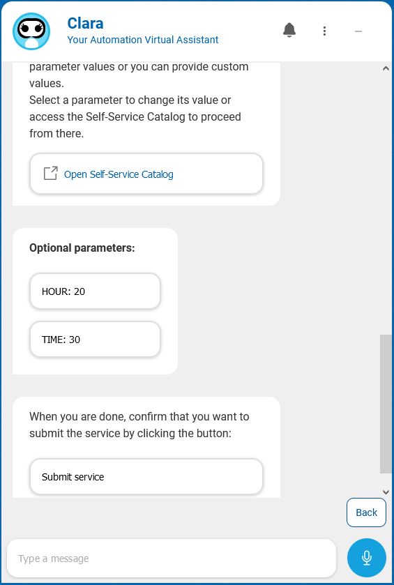

Mandatory and optional parameters are displayed by Clara with default values, if any.
You can submit the service with default parameter values or you can provide your custom values. Select a parameter to set or change its value. A link to Self-Service Catalog is provided if you want to modify the parameters and submit the service from there.

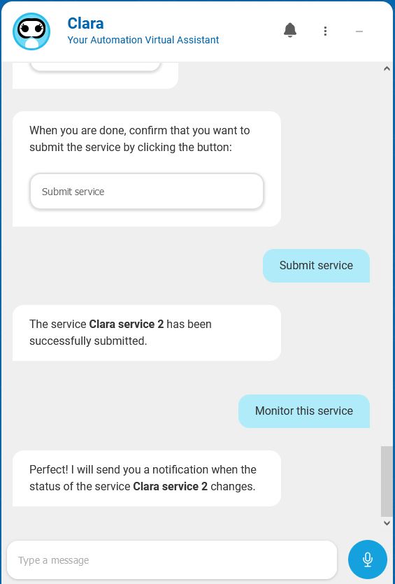

Click Submit service.
Click the suggested action Monitor this service to ask Clara to monitor the service execution for you and send a notification when the service status changes.
Note: Remember to enable Clara to send notifications. If you don't enable notifications when opening Clara UI, Clara will assist you to enable notifications in your browser later on.
Clara will notify you when the status of your submitted service changes into:
