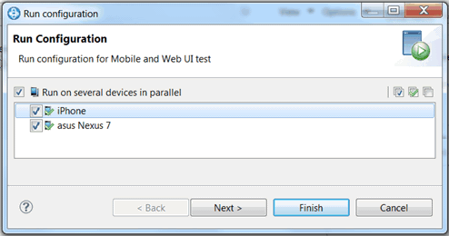

- Open the test. In the test editor, click Run Test.
In the Run configuration wizard,
select Run on several devices in parallel.
Select the devices and emulators that should run the test and click
Next.
Make sure that the devices are connected to Rational® Functional Tester and set to passive mode. You can select all devices to run the test, all ready devices (those that are already connected to Rational® Functional Tester), or select devices individually. You will need to configure the devices that are not connected. For more details, see Configuring the mobile test client.
- Select the options that enable performance testing and collecting response time data. For more details, see Evaluating response time contribution results.
Click Finish.
