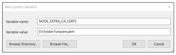

openssl x509 -in mycert.crt -out mycert.pem -outform PEM - Create the environment variable
NODE_EXTRA_CA_CERTS by performing the
following actions:
- Open the Environment Variables window.
- Click New from the System
variables section.
The New System Variable window is displayed.
- Enter NODE_EXTRA_CA_CERTS in the Variable name field.
- Enter the location of the PEM certificate in the Variable value field.
- Click OK.
