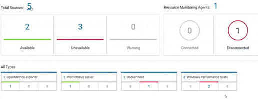

Click a source that is available in your project, either in the
Total Sources cards or in the All
Types cards from the Resource Monitoring page.

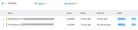

Click
under the Labels column of a Resource Monitoring
source to add a label.
Enter a name for the label and press the Enter key.
Example: Enter 'SUTv2' in three different Resource Monitoring sources.
Note: You can add one label or multiple labels for the same Resource Monitoring source. A label can contain a maximum of 200 characters.Tip: You can create the same label for different sources that belong to the same logical group to monitor the whole group with only one label. -

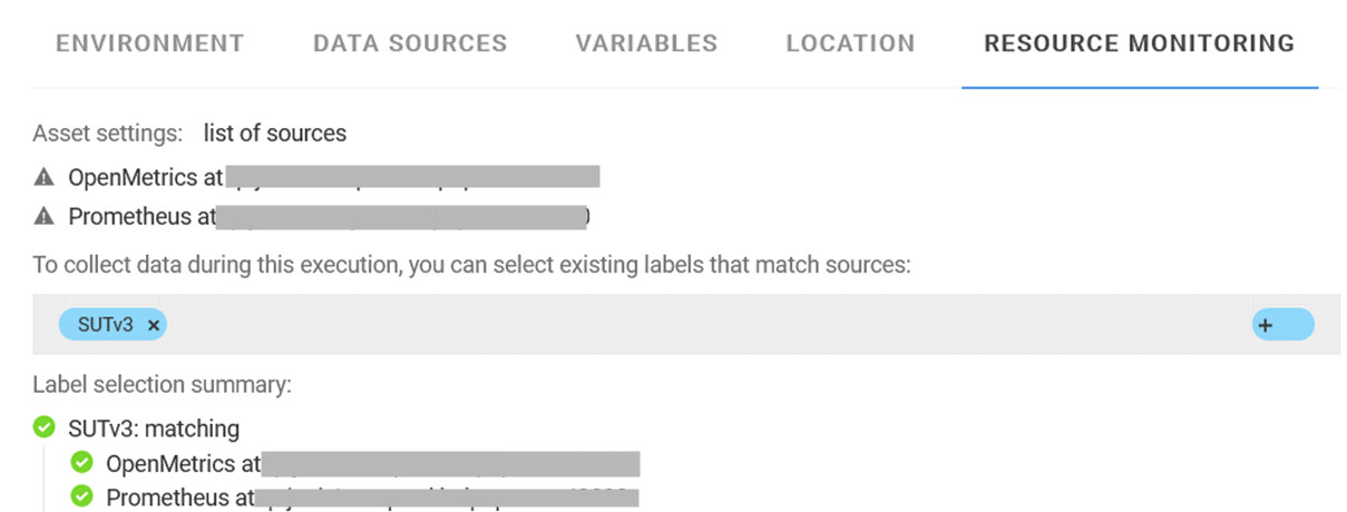

Navigate to the Execute view and click
on a performance schedule in the list of tests to execute a schedule.
Click the Resource Monitoring tab in the Execute
Test Asset dialog box.

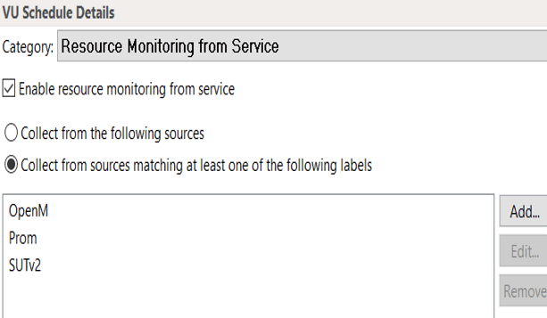

your Rational® Test Automation Server project (step 6). - If the Resource Monitoring from Service
option was enabled in Rational® Performance Tester, and data is collected from the sources you added to the
performance schedule in Rational® Performance Tester (see Figure 2), the Resource Monitoring tab
displays the list of these sources that are available in your
Rational® Test Automation Server project.
Figure 2:
To override the
initial sources with the sources that you created in Rational® Test Automation Server, select the labels that are in your Rational® Test Automation Server project and that match the Server sources (step 6 in this
procedure). - If you added sources to your performance schedule by using labels in

In the list of sources or labels that is displayed in the Resource Monitoring tab:- Green icons identify either labels that match the sources or sources that are found in the current project.
- Red icons indicate that the sources are not running,
- Yellow icons identify either labels that do not match the
sources, or sources that are not found in the current
project.
Data is collected for the sources that match labels only.

Click the
, and press the Ctrl + Space keys, or enter the initial letter of a
label to select a label in the list.
Example: Select 'SUTv3'.
You can see all the labels that you added to the Resource Monitoring sources in Rational® Test Automation Server. - Click Execute to execute the performance schedule.

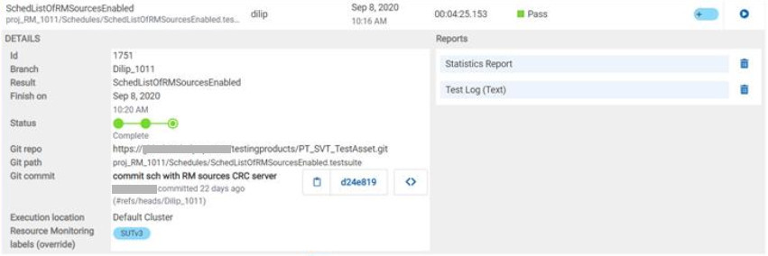

- Click the Result view in the navigation bar of Rational® Test Automation Server when the schedule is complete.
Expand the performance schedule result to see the Resource Monitoring label
name in the Details card.
The Details card displays the Resource Monitoring labels that are used in the schedule to override the initial labels and collect Resource Monitoring sources (in the example, the 'SUTv3' label). For other details about the Results page, see the link at the end of this page.

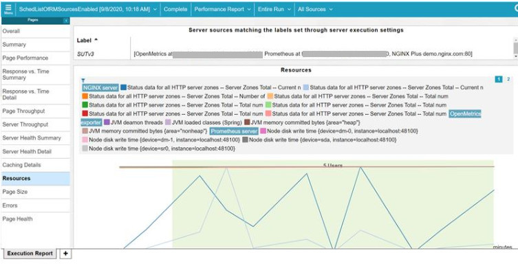

In the Report card, you find the link to the Statistics Report that is generated. In the Resource tab of the Statistics Report, you can view the information related to the Server sources matching the labels set in the schedule.
Click the Statistics Report link in the
Reports card to see the performance metrics of the
Monitoring sources matching the selected labels.
Example: You can see the statistics for the sources tagged with the 'SUTv3' label.
