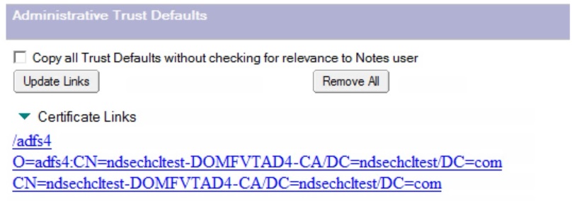

- Select the Keys and Certificates tab.
- To add the Notes® certifier to the policy, in the Administrative Trust Defaults section, click Update Links.
- Choose Selected supported and click OK.
Click the Notes Certifiers tab, select the certificates which signed the
IDs of the Notes users, and click OK.
Note: If the IDs are signed by an Organization Unit (OU) certificate, include all certificates in the hierarchy, including the Organizational certificate.
- Click the Internet Cross Certificates tab, select the cross certificate from the Notes root certifier to the certificate exported from ADFS and click OK.
- Click the Internet Certificates tab, select the TLS certificate exported from ADFS and click OK.
Verify that a chain of at least three certificates is shown (more if there are organization
unit certificates): the Notes certifier at the top, the internet cross certificate in the middle,
and the internet certificate at the bottom.
For example:
