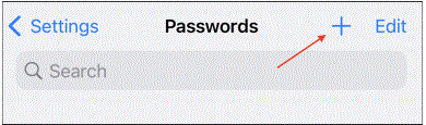

    1. Tap on the (+) button to add a new website.

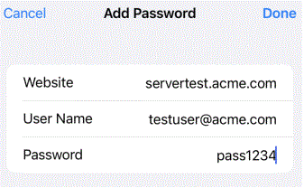

    2. Fill in the following details:
      • Website: your Traveler server URL
      • User Name: your Traveler account username
      • Password: your Traveler Internet password
    3. Tap Done.

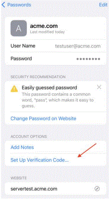

    4. Upon selecting the website, tap on Setup Verification Code.
  3. You can either Enter Setup Key or Scan QR Code. If you have your setup key or QR code handy, you may choose either of the two options.
