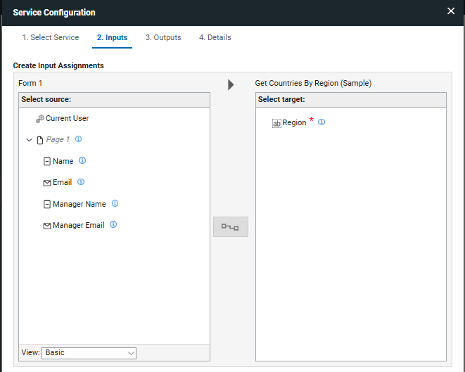

Mapping inputs
Every service can be filtered by defining input assignments.
On the left side is a list of all the fields in your form that can be used as inputs. You can switch the View to Advanced to see additional field properties or to Constant to specify a hard-coded value.
On the right side is the list of searchable targets for the service.
To create an assignment, select an item from the left side and the corresponding item from the right side, then click the Assignment button in the middle. Here are a few key points to understand about defining inputs:
- A service can have any number of inputs
- The assignments that you create must be of the same data type
- When multiple inputs are defined they will be applied as an AND relationship, which means that the results must match all the specified criteria.

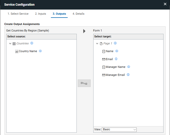

Mapping outputs
Every service returns some type of feedback. The items returned by a service call can be linked to items in your form to either render the results, or affect the behavior of the form.
On the left side is a list of the items that the service returns.
On the right side is a list of items in your form where you can link the output.
To create an assignment, select an item from the left side and the corresponding item from the right side, then click the Assignment button in the middle. Here are a few key points to understand about defining outputs:
- The assignments must be the same structure, if a list is returned then you can only link it to list items (such as, dropdown, table, select one or select many).
- If you change the view to Advanced, you will see additional properties available for assignment. You can set the value, an item's validity, or the invalid message. A common example is performing a search (allowing only one record) and creating an output assignment between Found No Matches and a field's Valid property.
