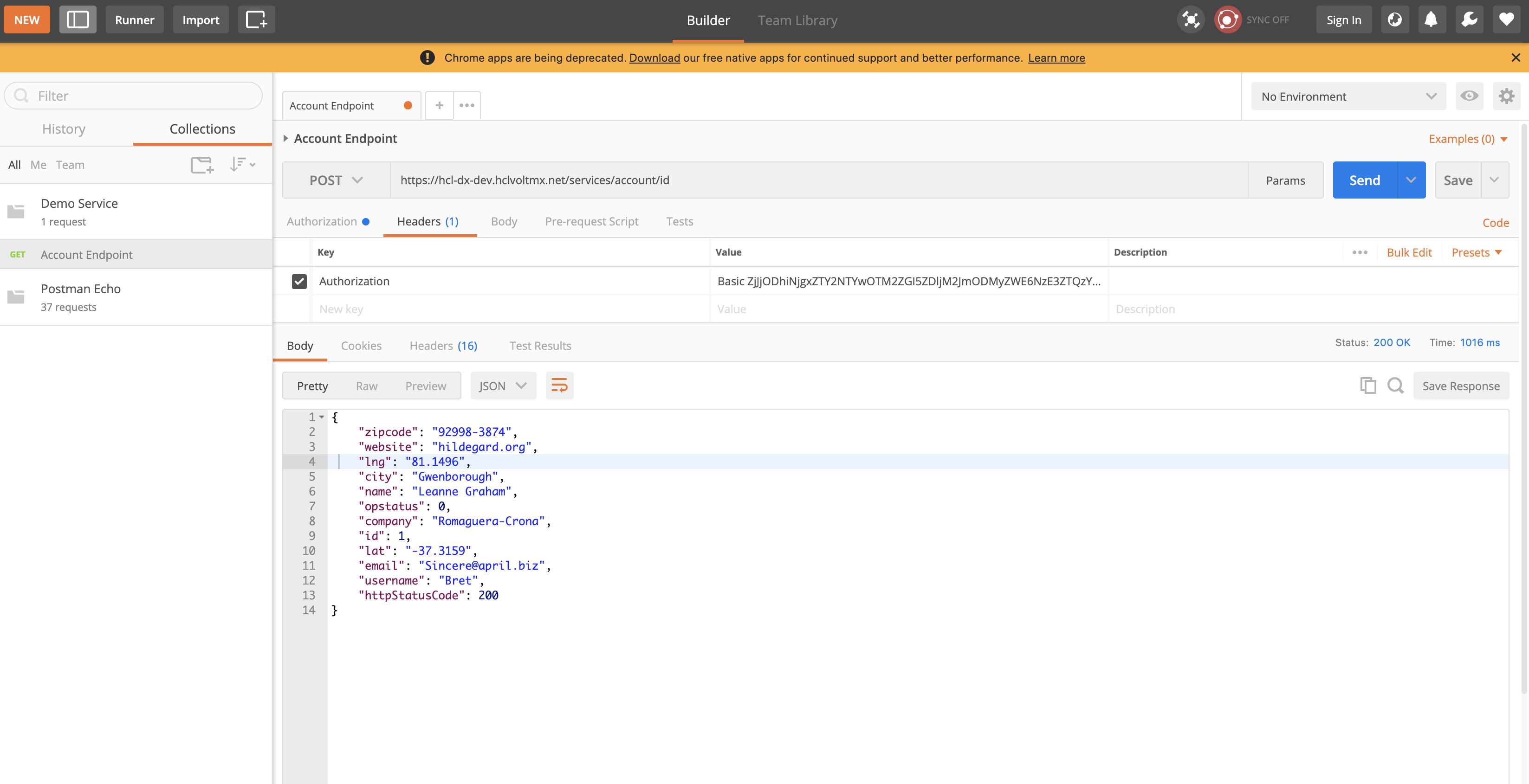

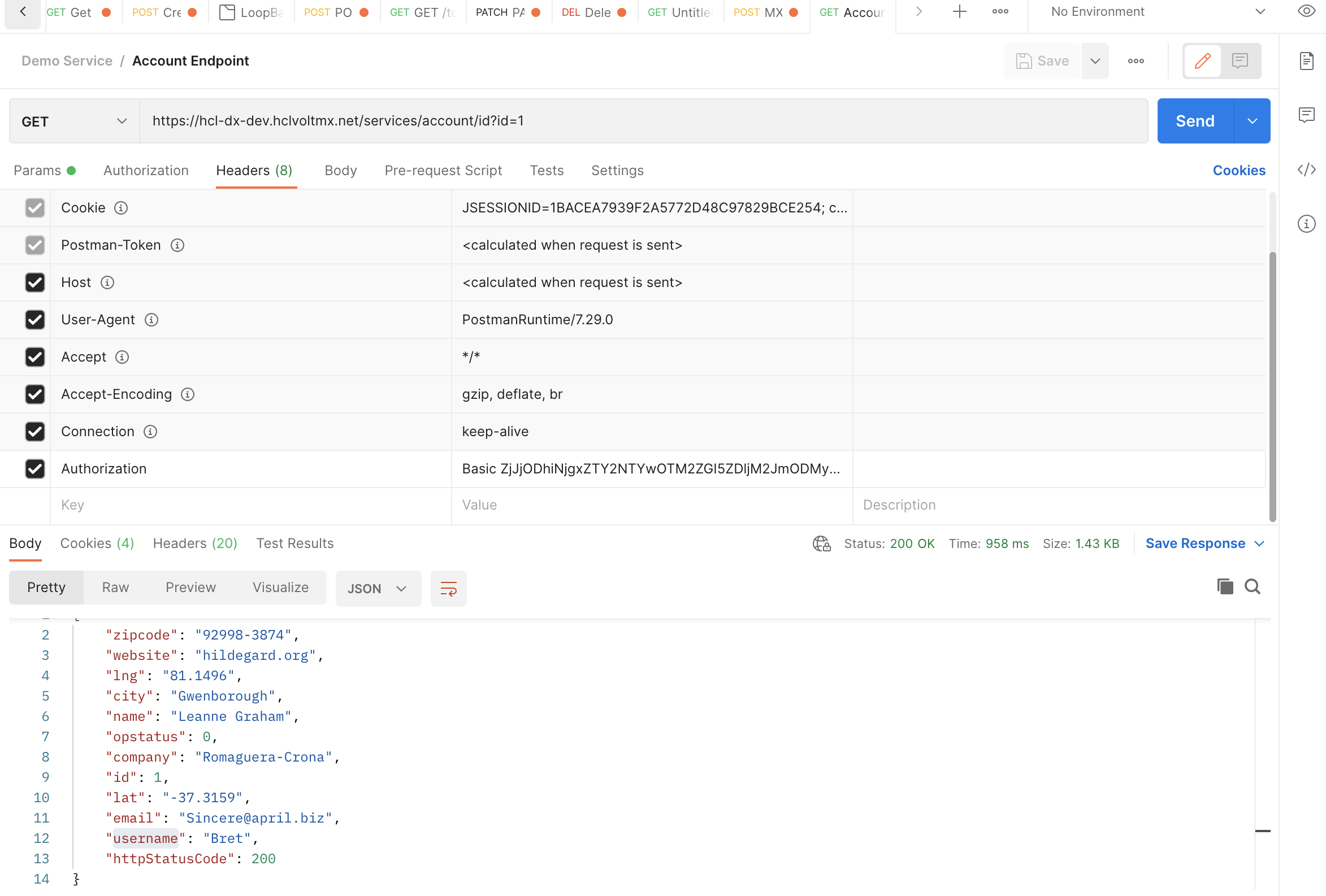

The following API end point and response are used to create this sample document:
  • Sample API end point for GET
  • Sample API end point for POST

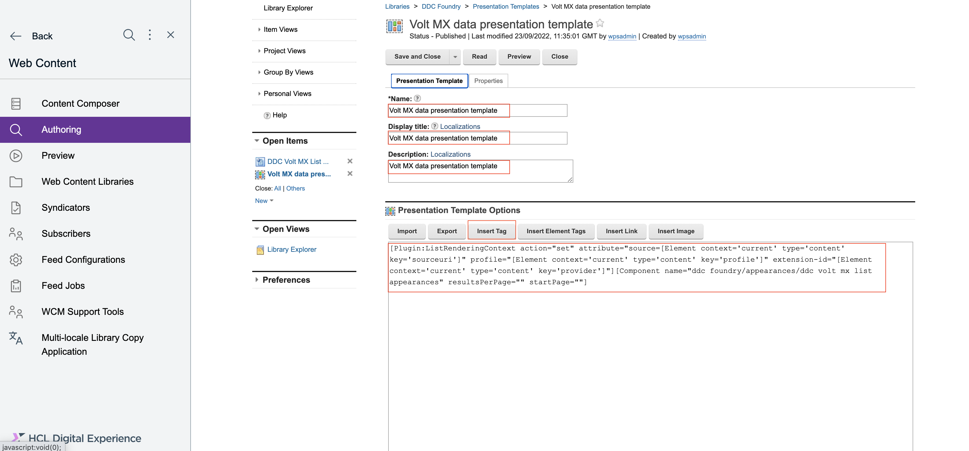

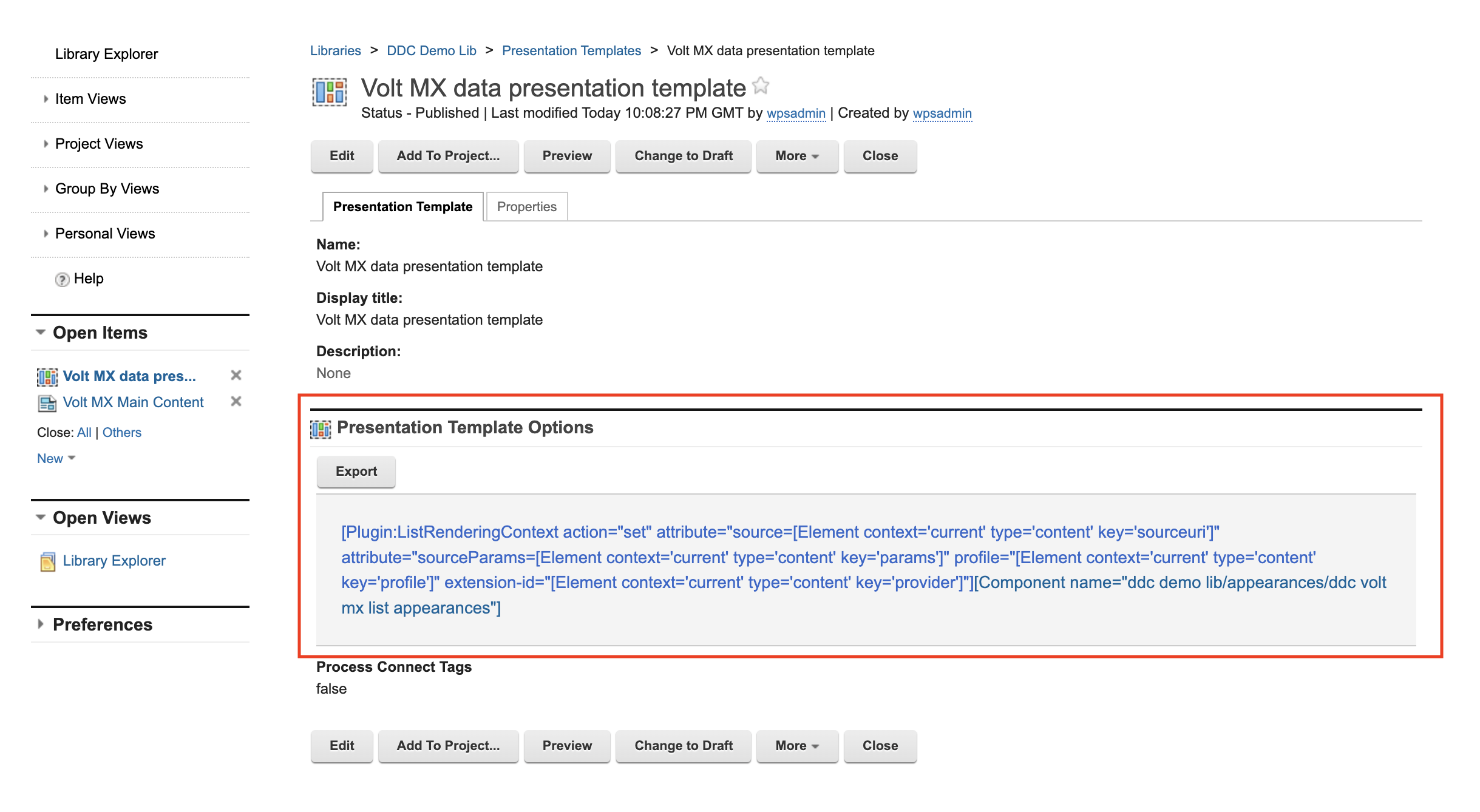

Creating a Presentation Template
Create a Presentation Template to set the context of the DDC content. Refer to the following steps:
  1. Go to Web Content > Authoring.
  2. Create a new Presentation Template.
    1. Click New > Presentation Template.
    2. Enter a Name, Display title, and Description for your presentation template. The recommended name is Volt MX data presentation template.

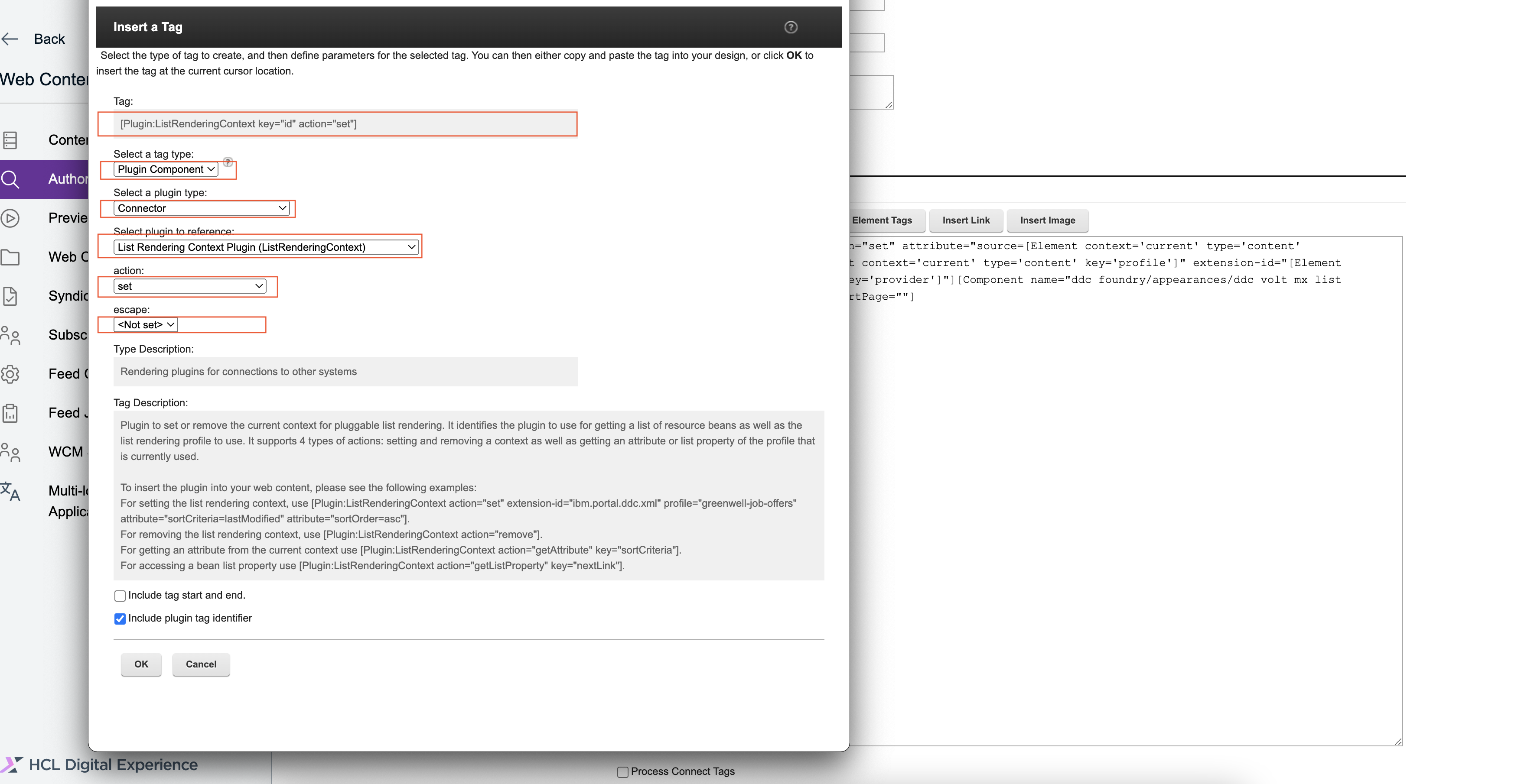

    3. Under Presentation Template Options, click Insert Tag.
    1. Select the type of tag to create, and then define parameters for the selected tag. You can then either copy and paste the tag into your design, or click OK to insert the tag at the current cursor location.
    Sample Presentation Template options
    [Plugin:ListRenderingContext action="set" attribute="source=[Element context='current' type='content' key='sourceuri']" profile="[Element context='current' type='content' key='profile']" extension-id="[Element context='current' type='content' key='provider']"][Component name="ddc foundry/appearances/ddc volt mx list appearances" resultsPerPage="" startPage=""]
    • Under attribute, define the data source endpoint. The content field set in this example is sourceuri, where you saved the endpoint in the content item.
    • profile refers to the List-Rendering Profile which was saved earlier in the WAS console. The content field that is set in this example is also profile, which is saved in the content item with the ddcDemo.profile.json value.
    • extension-id refers to the DDC plugin ID. The content field set in this example is provider, which is saved in the content item with value ibm.portal.ddc.json.
  3. Click Save and Close.

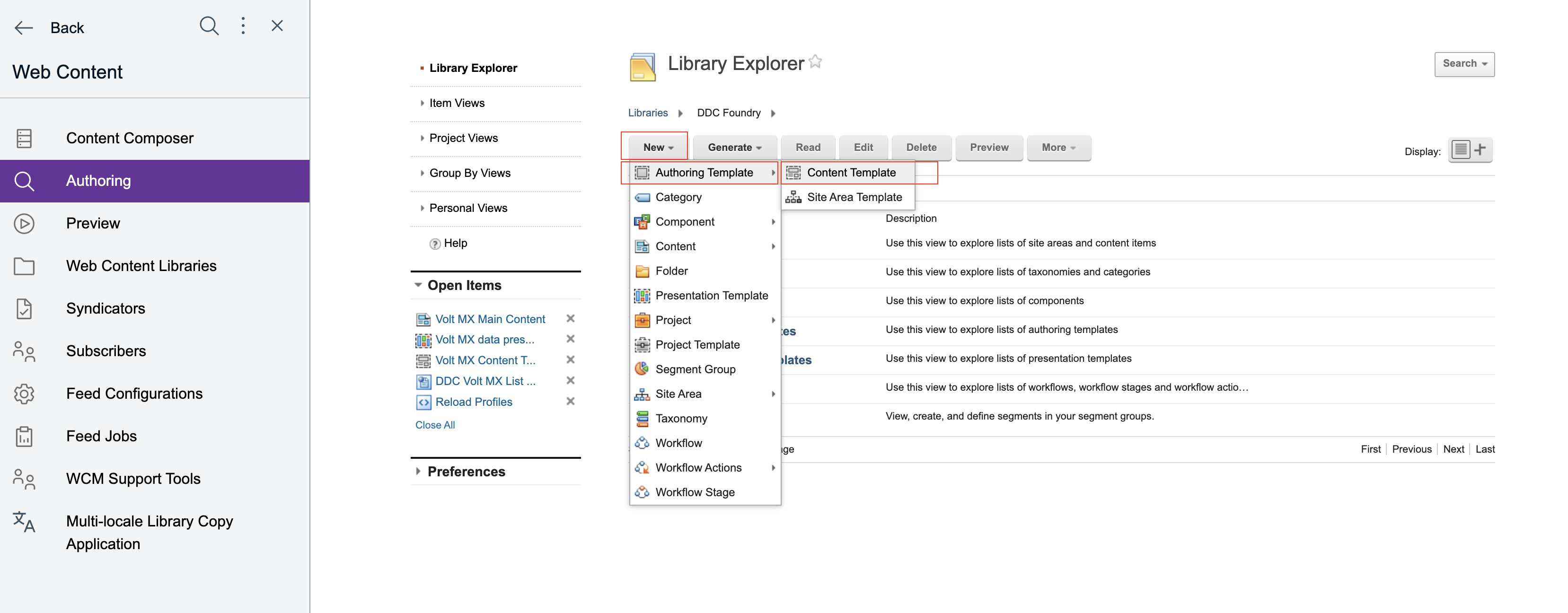

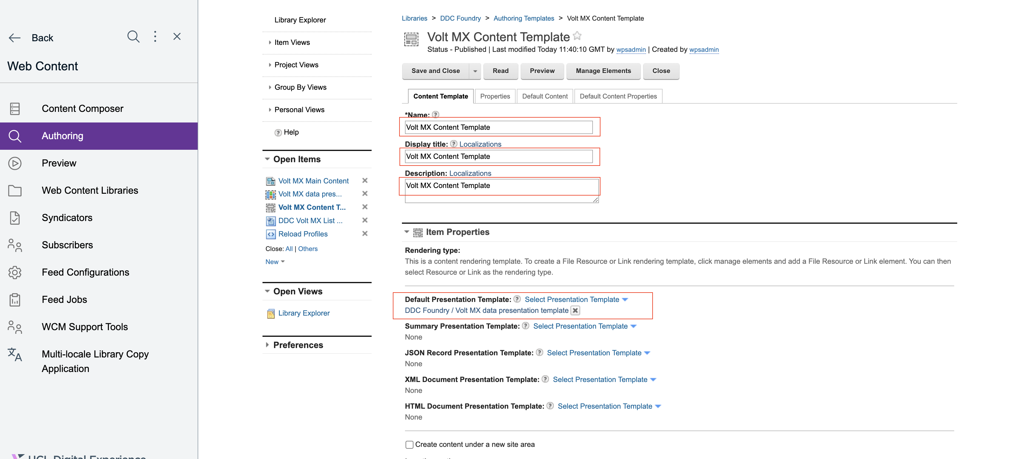

Under Authoring Templates, create a Content Template.
  1. Click New > Authoring Template > Content Template.
  2. Add the Name, Display title, and Description for your Content Template.
    The recommended name is Volt MX Content Template.
  3. Under Item Properties, select the presentation template you created in Creating a presentation template as the Default Presentation Template.

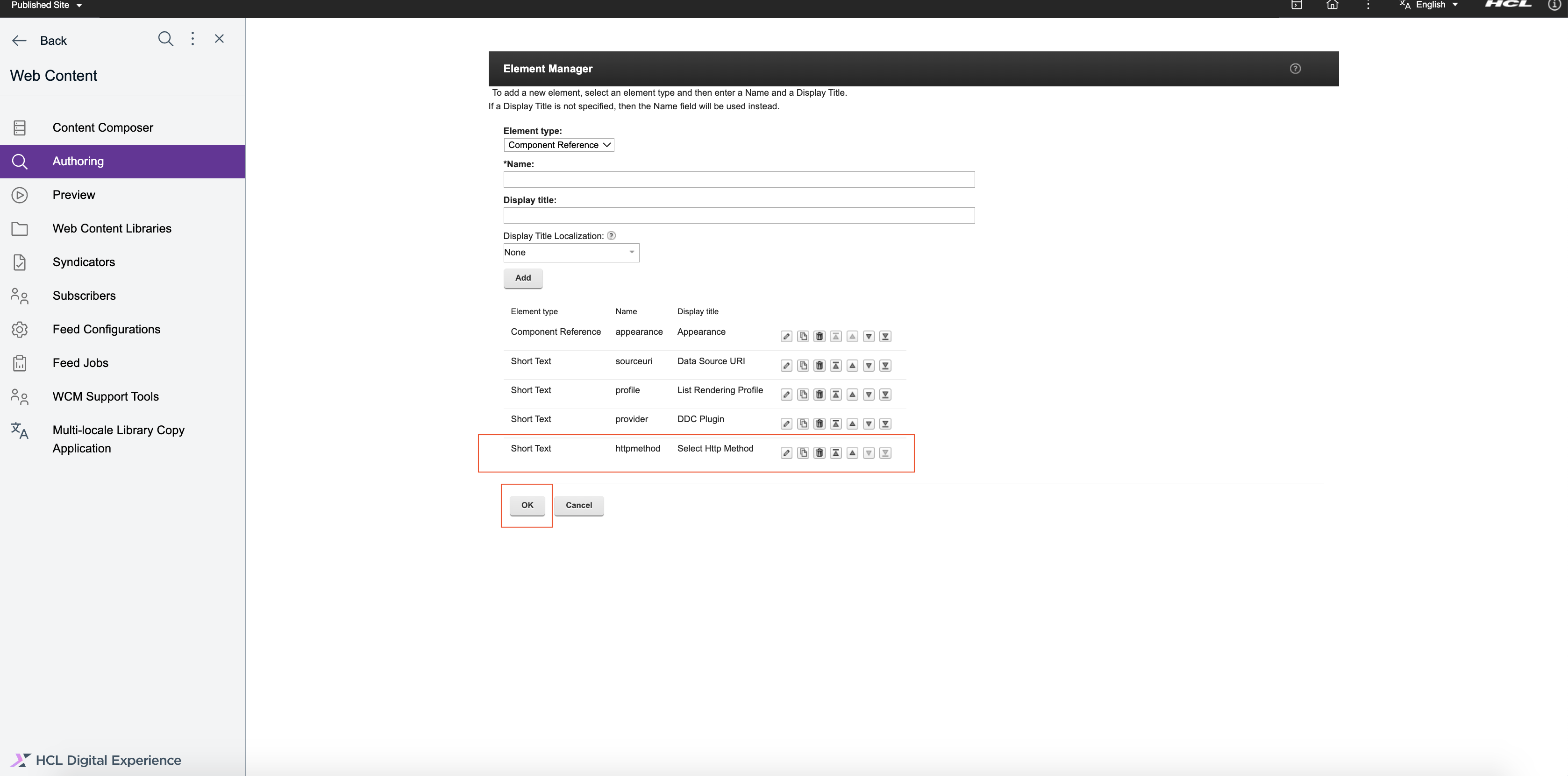

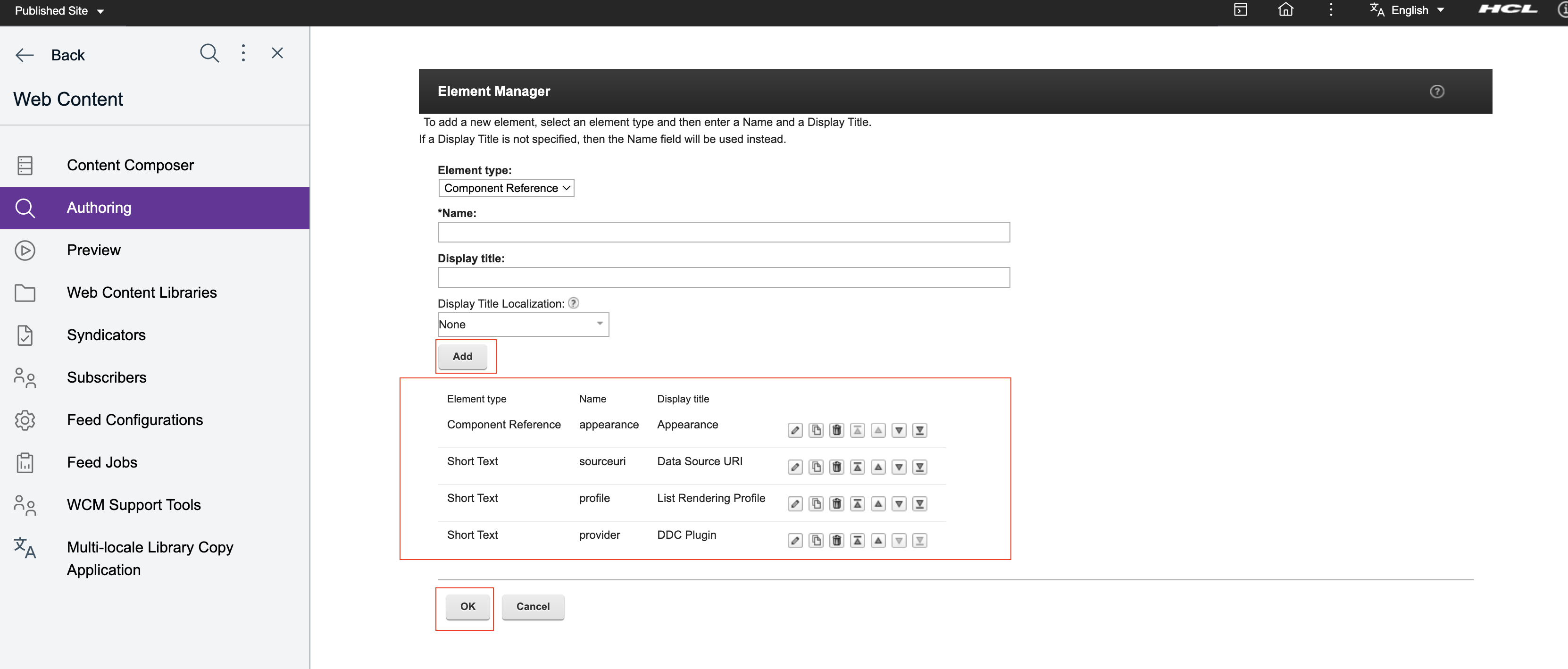

  4. Click Manage Element and add the following elements to the content template:
    Element type Name Display title
    Component Reference appearance Appearance
    Short Text sourceuri Data Source URI
    Short Text profile List Rendering Profile
    Short Text provider DDC Plugin
    Note
    In case of GET resource method, adding httpmethod element is not necessary. Vy default, the connection is initially set to GET.
    If you selected any other Resource Method (for example, POST from Advanced > Front End API > Resource Method) while creating a new integration service with Volt MX Foundry, then you need to add another element httpmethod. This element (httpmethod) can be added as Short Text, Text, or OptionSelection. A content created from this content template can then load and render data from data sources using other resource methods. Leaving the optional httpmethod field value blank or empty when creating your content, which is based on the content template, would still have the connection fallback to GET.
    Short Text httpmethod Select Http Method

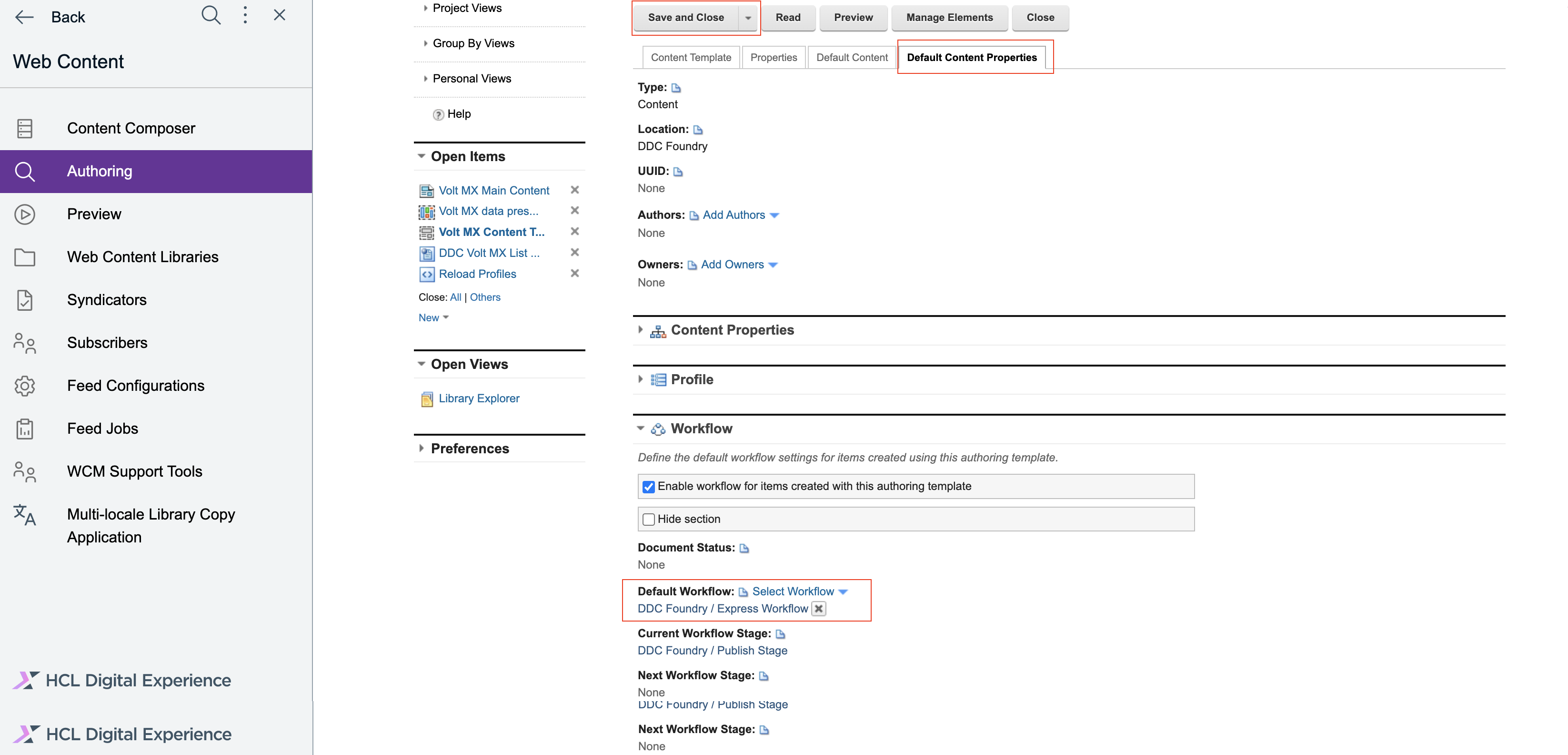

  5. Click Default Content Properties and add Express workflow.
  6. Click Save and Close.

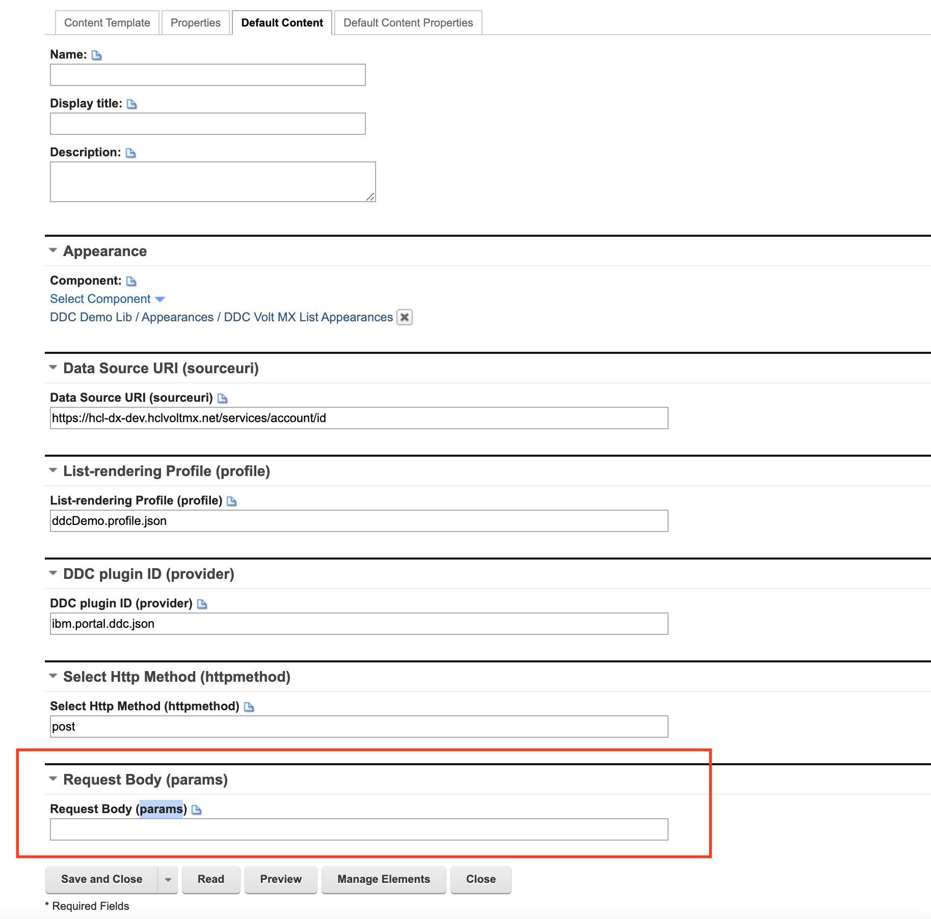

If you selected any other Resource Method (for example, POST from Advanced > Front End API > Resource Method) while creating a new integration service with Volt MX Foundry, you might need the capability to submit data to the API which DDC will try to parse as sourceParams using the Presentation Template you created in the previous section. In that case, you must add a content field in your Content Template that will save this. It can have any name but this example uses params.
Short Text params Request Body

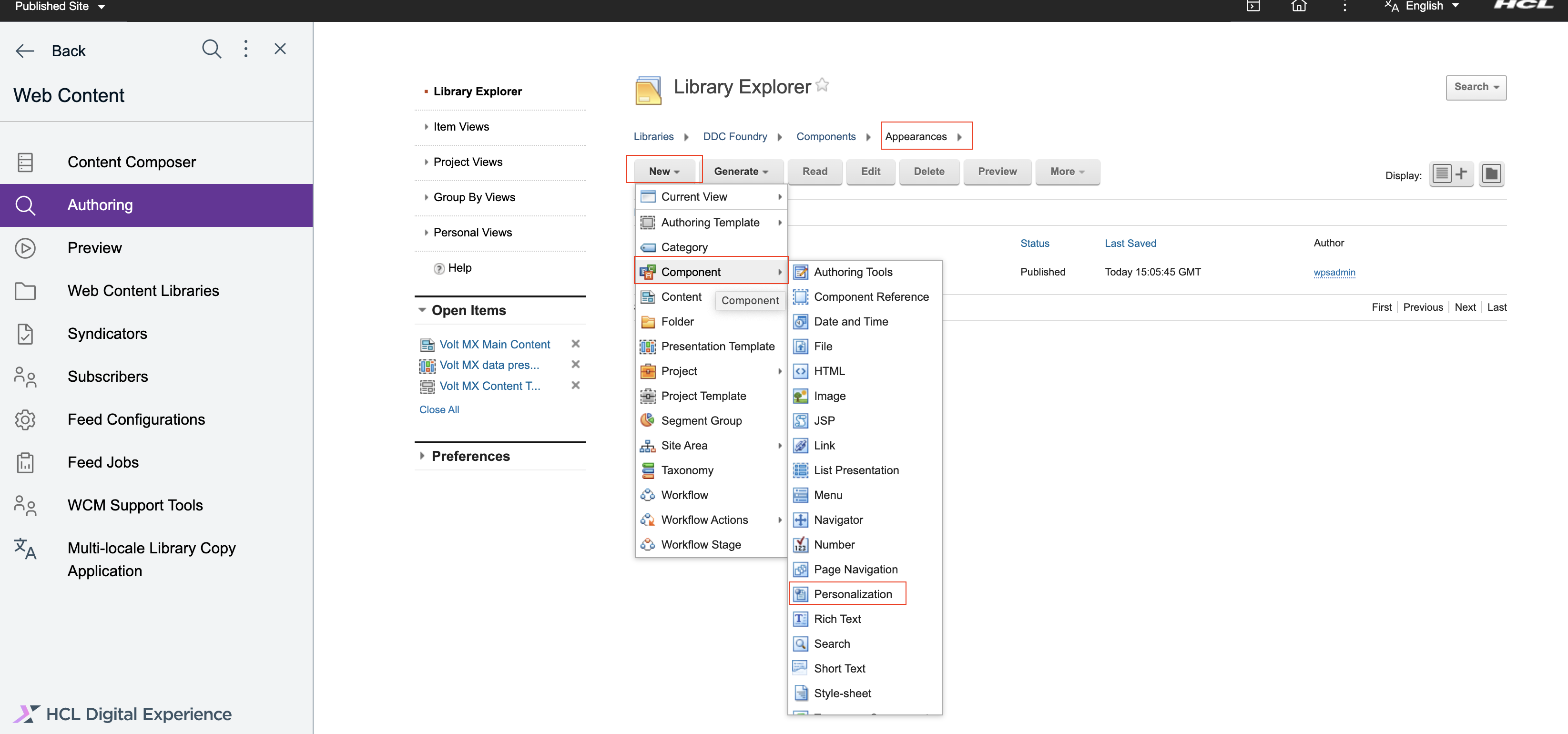

Creating a List Appearance

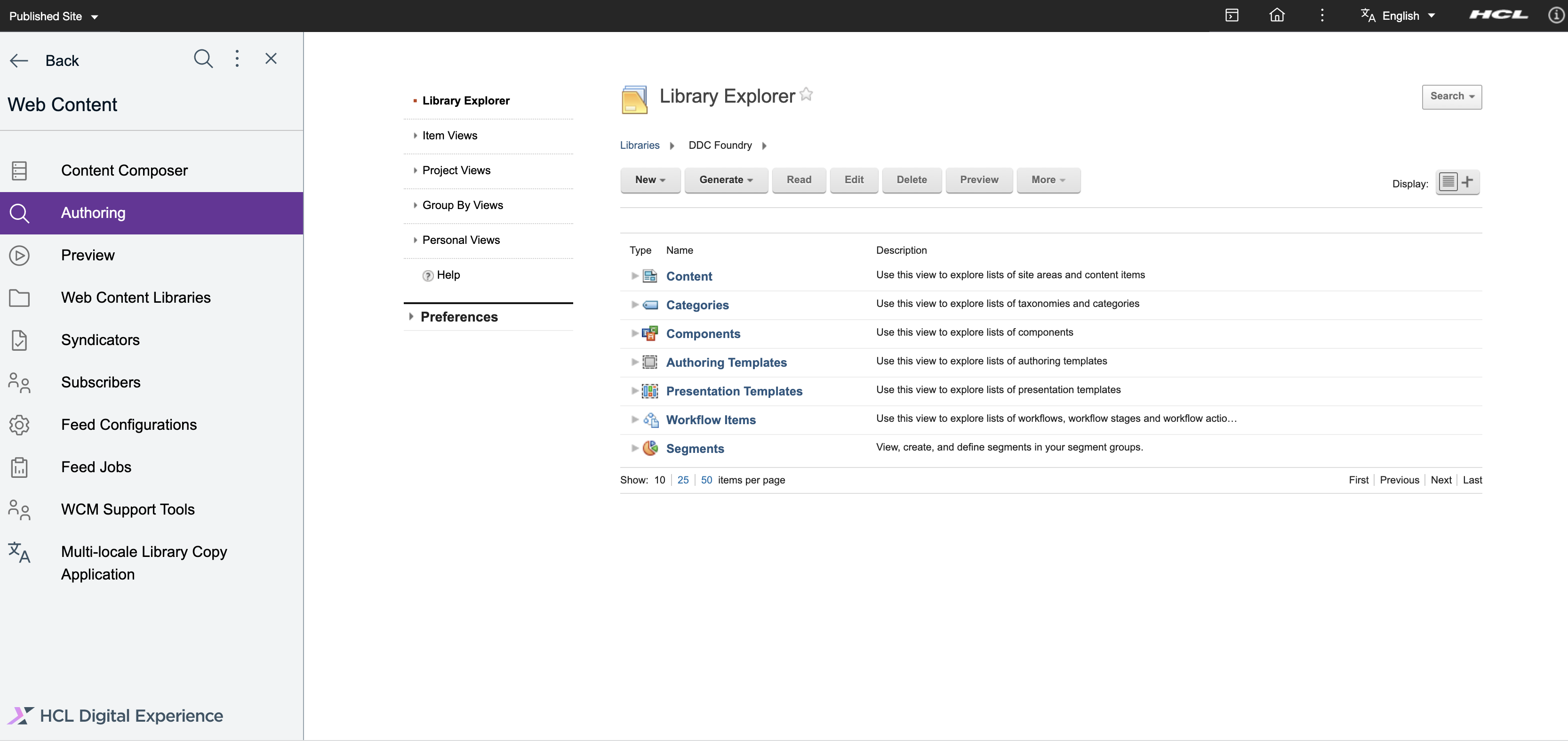

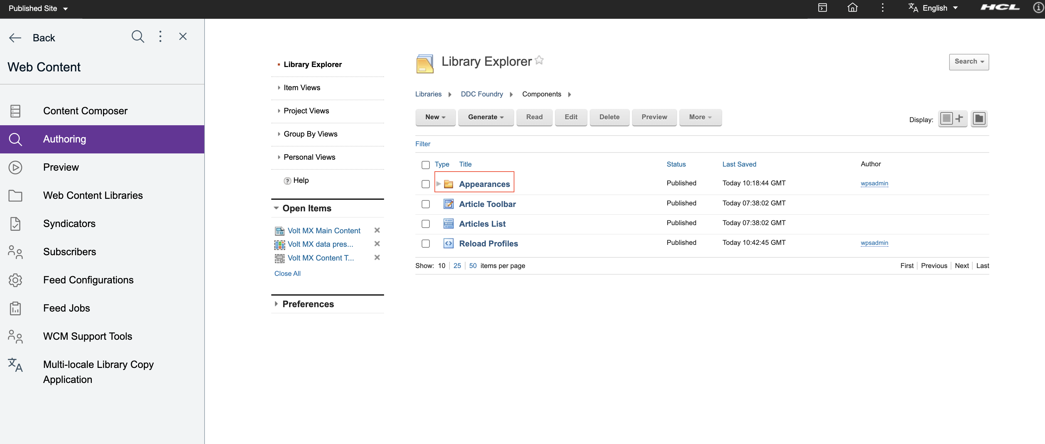

  1. Go to the Library Explorer. The following default items are available: Content, Categories, Components, Authoring Templates, Presentation Templates, Workflow Items, and Segments.

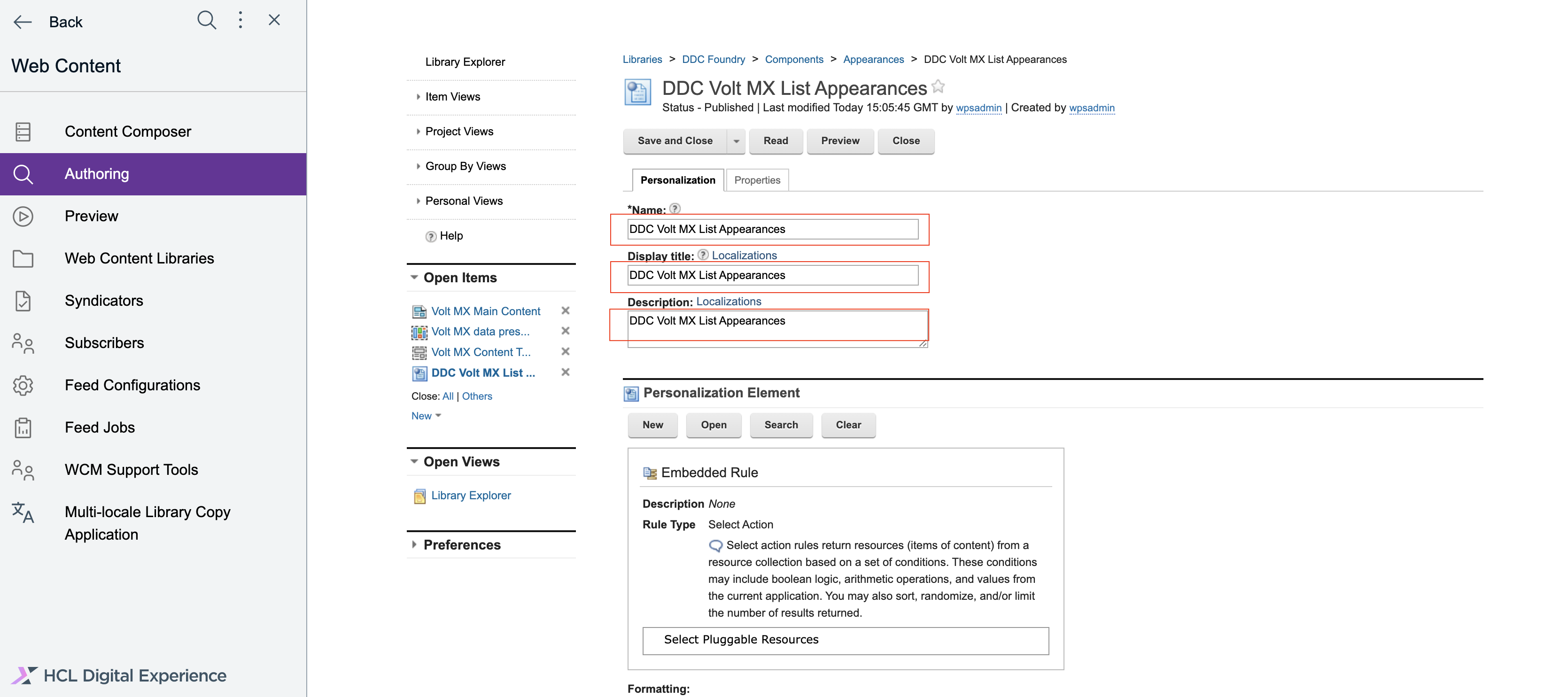

  2. Create an Appearances folder under Components. This is to ensure that your personalization components use the DDC selection rule. Select pluggable resources can be found easily in one place.
  3. Under the Appearances folder, create a new Personalization component.
    1. Click New > Component > Personalization.
    2. Enter the Name, Display title, and Description. The recommended name is DDC Volt MX List Appearances.

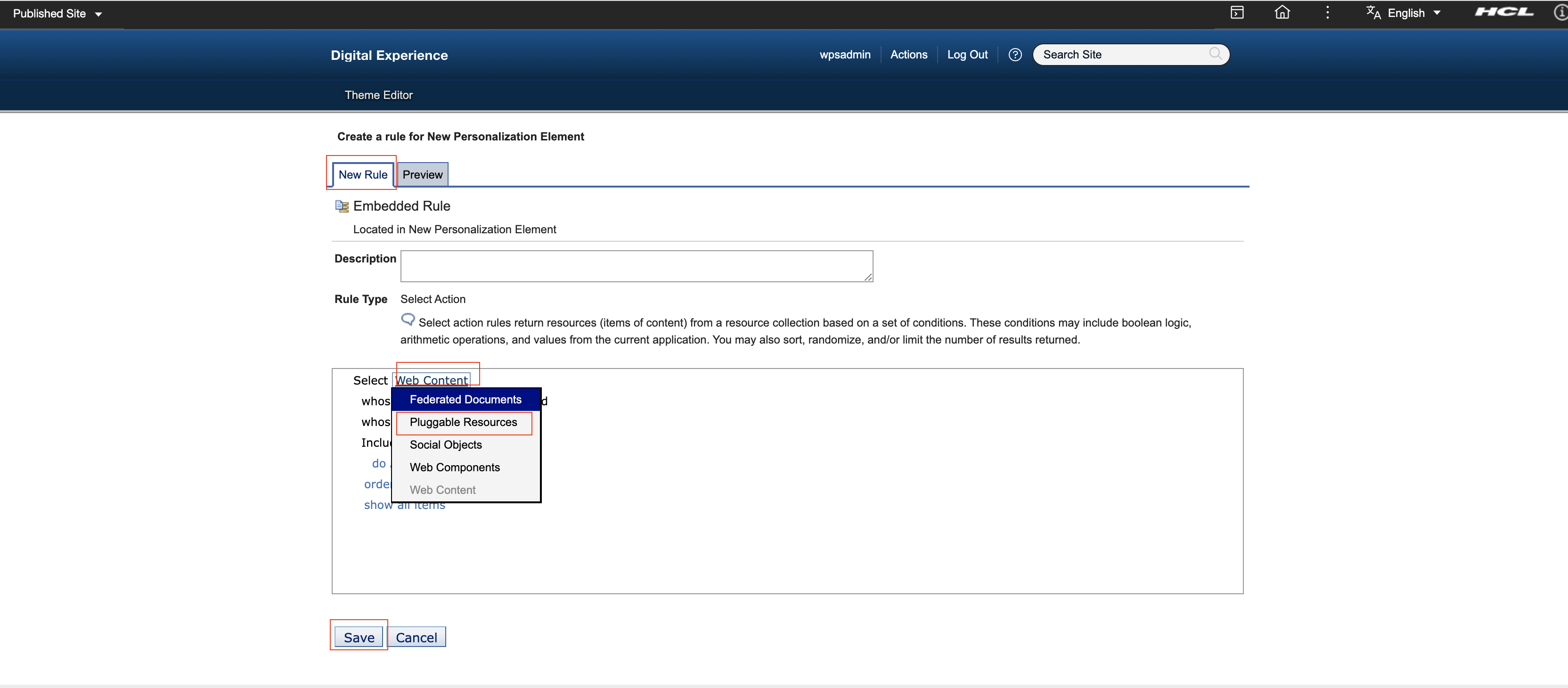

    3. Under Personalization Element, click New.
    4. Under New Rule, click Web Content and select Pluggable Resources. Click Save.

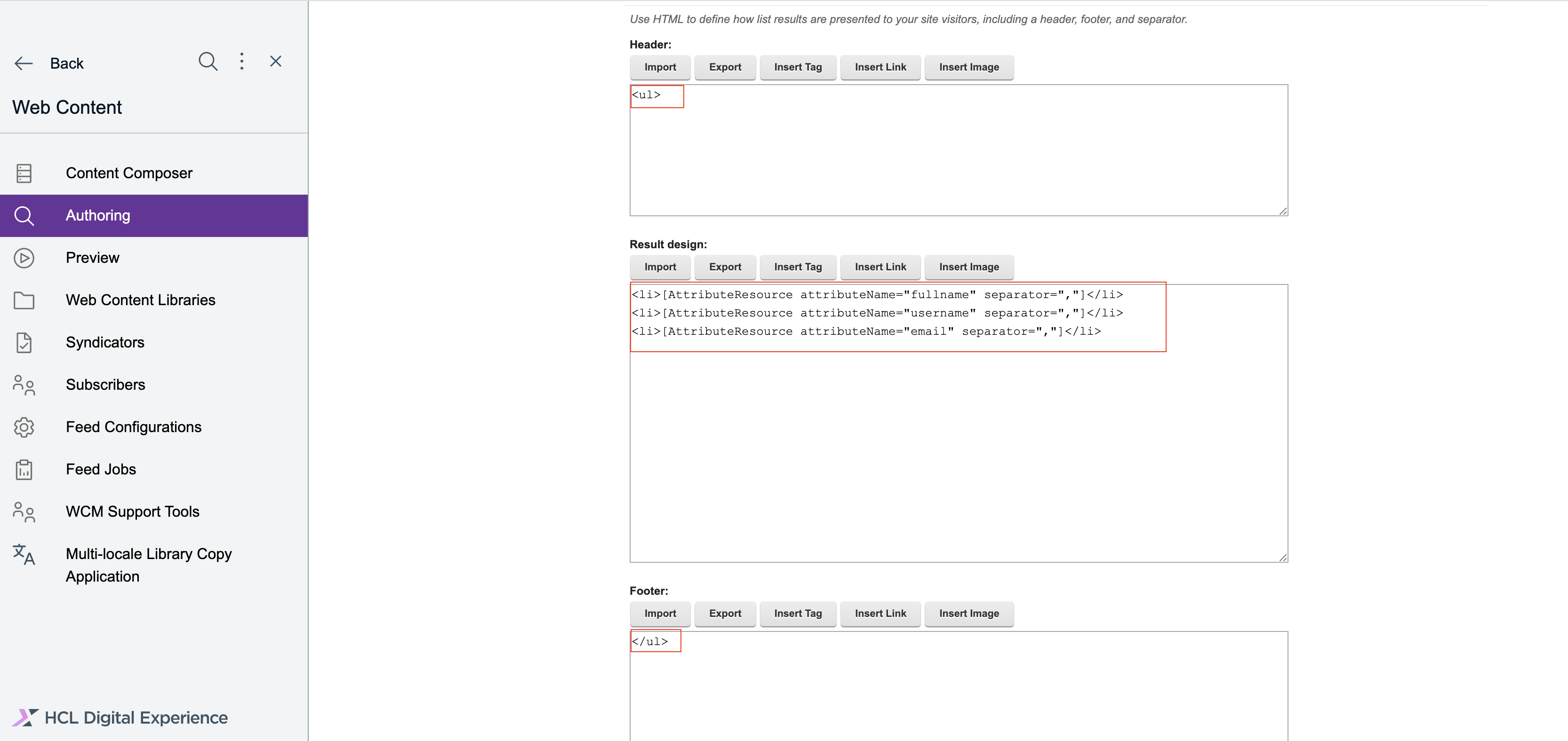

    5. In the List Presentation Markup, add the following:
      • Header: <ul>
      • Result design:
        <li>[AttributeResource attributeName="fullname" separator=","]</li>
        <li>[AttributeResource attributeName="username" separator=","]</li>
        <li>[AttributeResource attributeName="email" separator=","]</li>
      • Footer: </ul>
      Note
      The attributeName used here is the last part of the itemAttribute you have specified in your list-rendering profile. For example, ddcDemo.ItemAttribute.fullname.

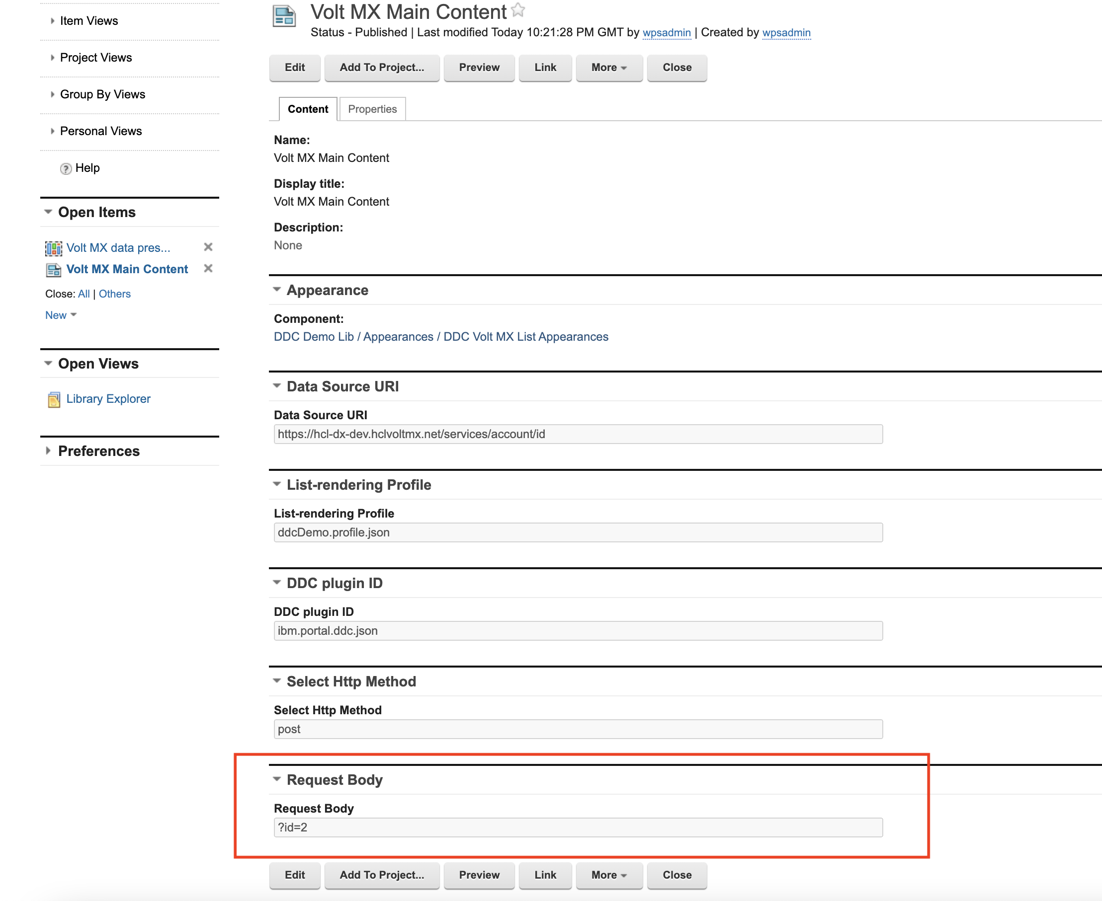

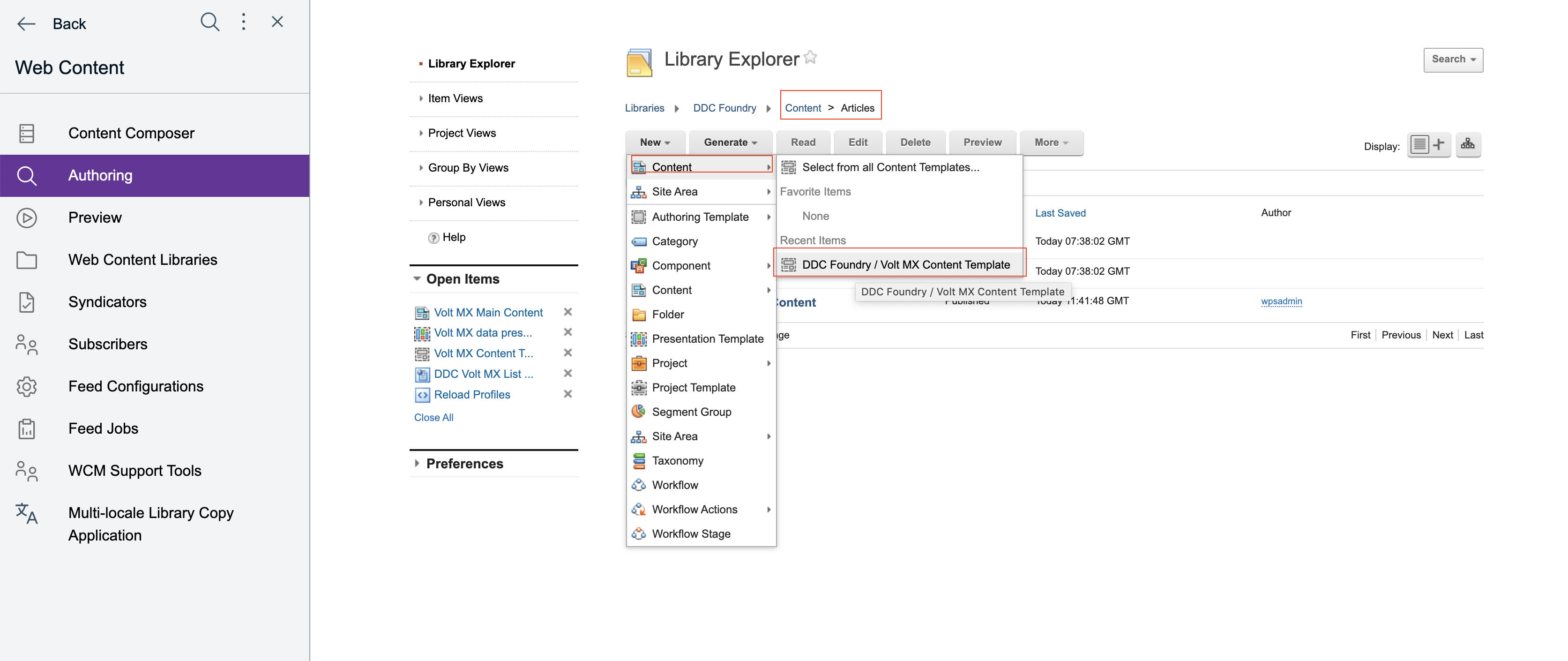

Creating a Content item
  1. Under your libraries, click Content > Articles.

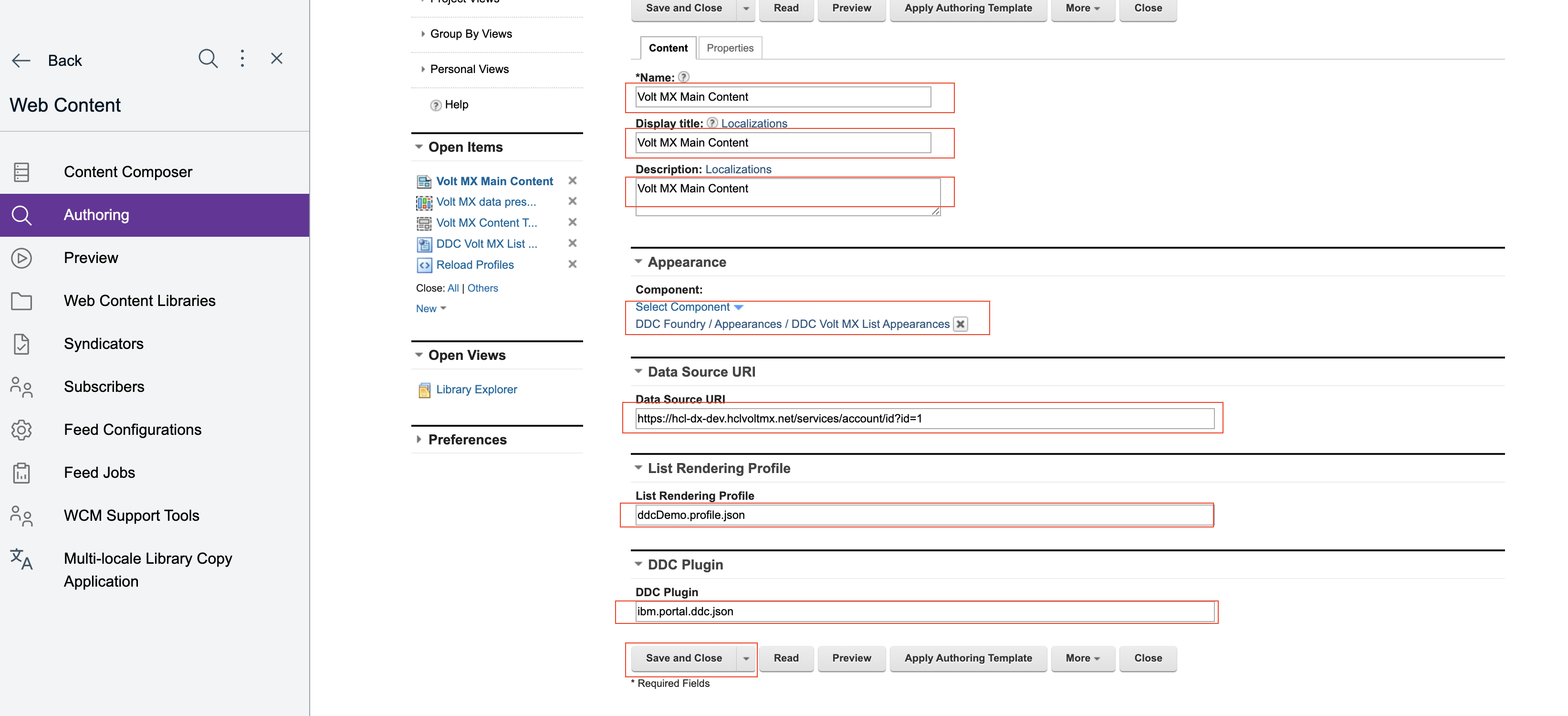

  2. Create a new Content item from the Content Template that you created in Creating a Content Template.

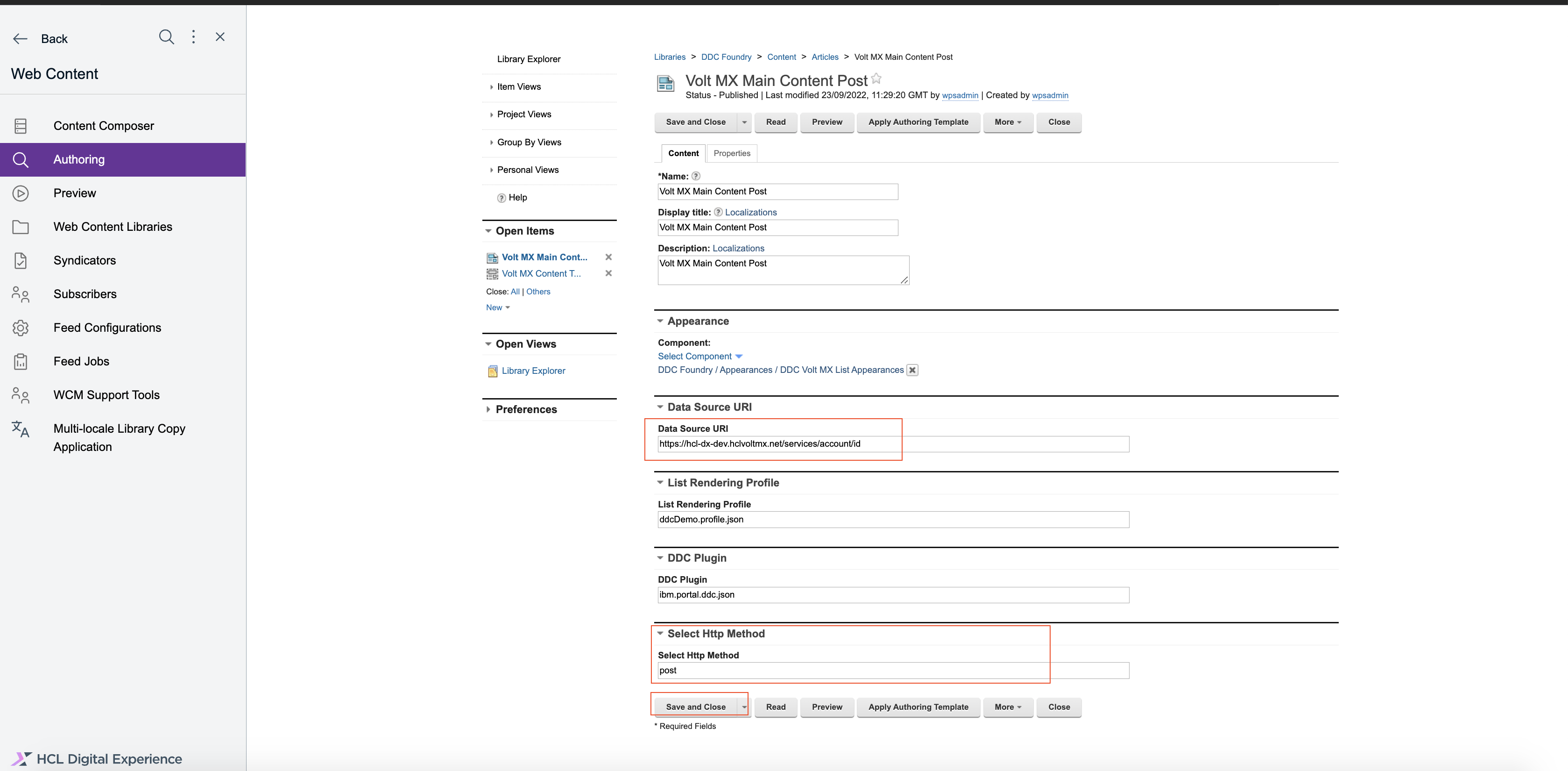

  3. Add the Name, Display title, and Description of the Content item. The recommended name is Volt MX Main Content, and in the content fields / elements, provide the following values:
    Content field title Value
    Appearance auto filled once you've chosen a component
    Data Source URI https://hcl-dx-dev.hclvoltmx.net/services/account/id?id=1
    List Rendering Profile ddcDemo.profile.json
    DDC Plugin ibm.portal.ddc.json
    Note
    If you selected any other Resource Method (for example - POST from Advanced > Front End API > Resource Method) while creating a new integration service with Volt MX Foundry then you need to provide value for httpmethod. Also, the value of Data Source URI would be the POST URL endpoint in this case.
    Select Http Method post
  4. Click Save and Close.
Note
If you selected any other Resource Method (for example, POST from Advanced > Front End API > Resource Method) while creating a new integration service with Volt MX Foundry, you might need the capability to submit data to the API which DDC will try to parse as sourceParams using the Presentation Template you created in a previous section. In that case, you must provide value for params in your Content item. You can pass many key-value pairs of data and it should have the format of a URL query string.
Request Body ?id=2

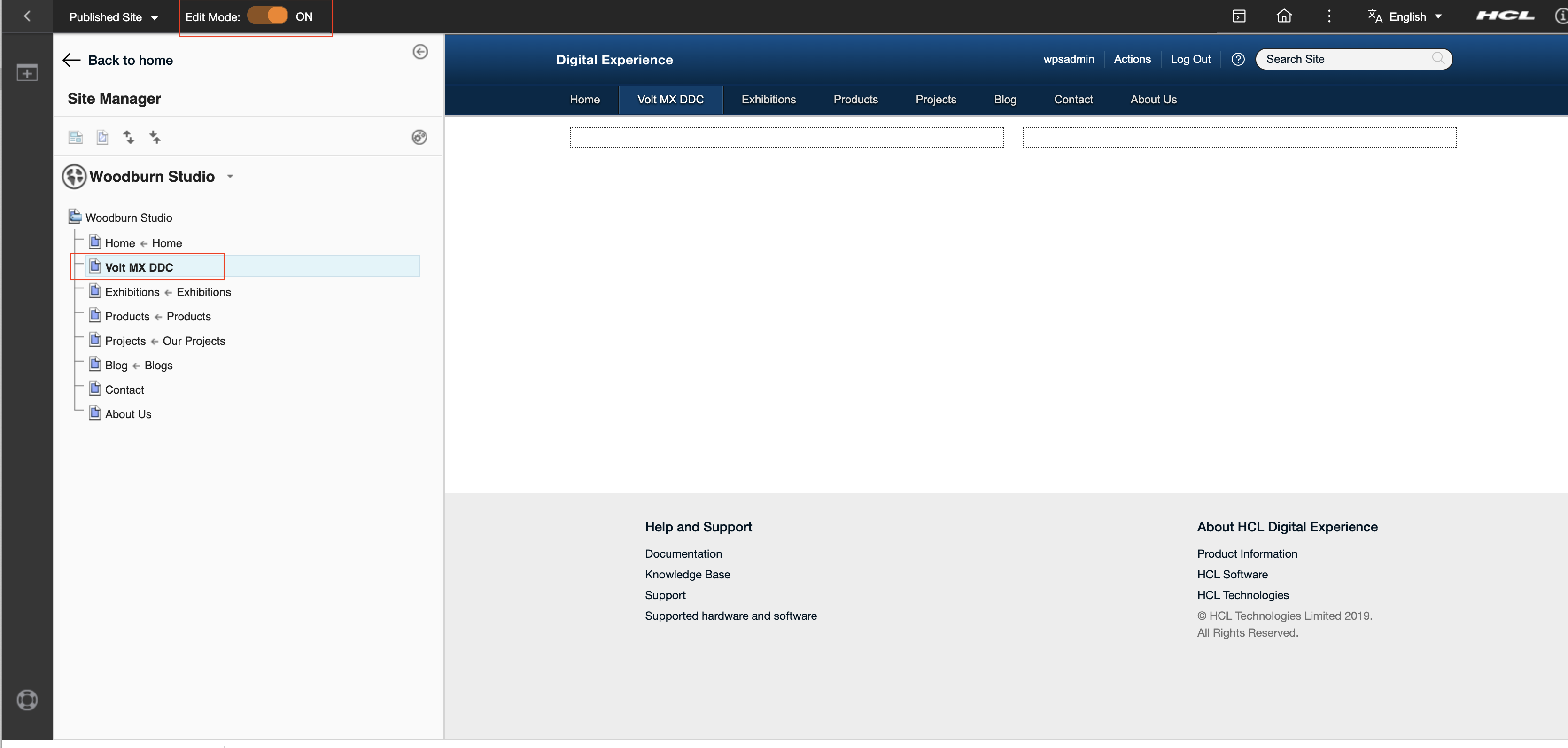

Using WCM artifacts on a DX Compose page
Now you can use all the WCM artifacts that you created on a DX Compose page.
Note
This guide uses an existing page but you can create a completely new Content Root or any child or sibling page on any site. Refer to Creating a page from the site toolbar for creating a page.

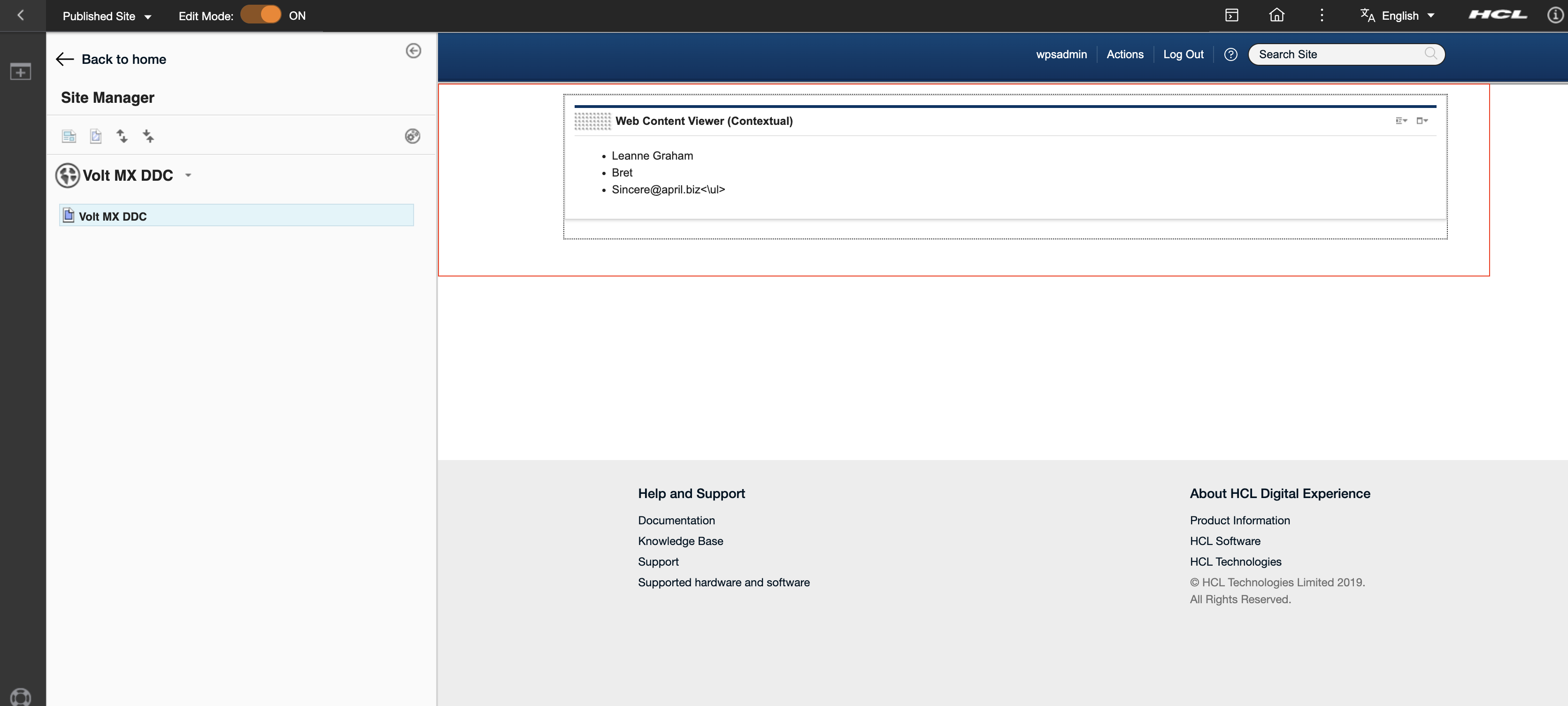

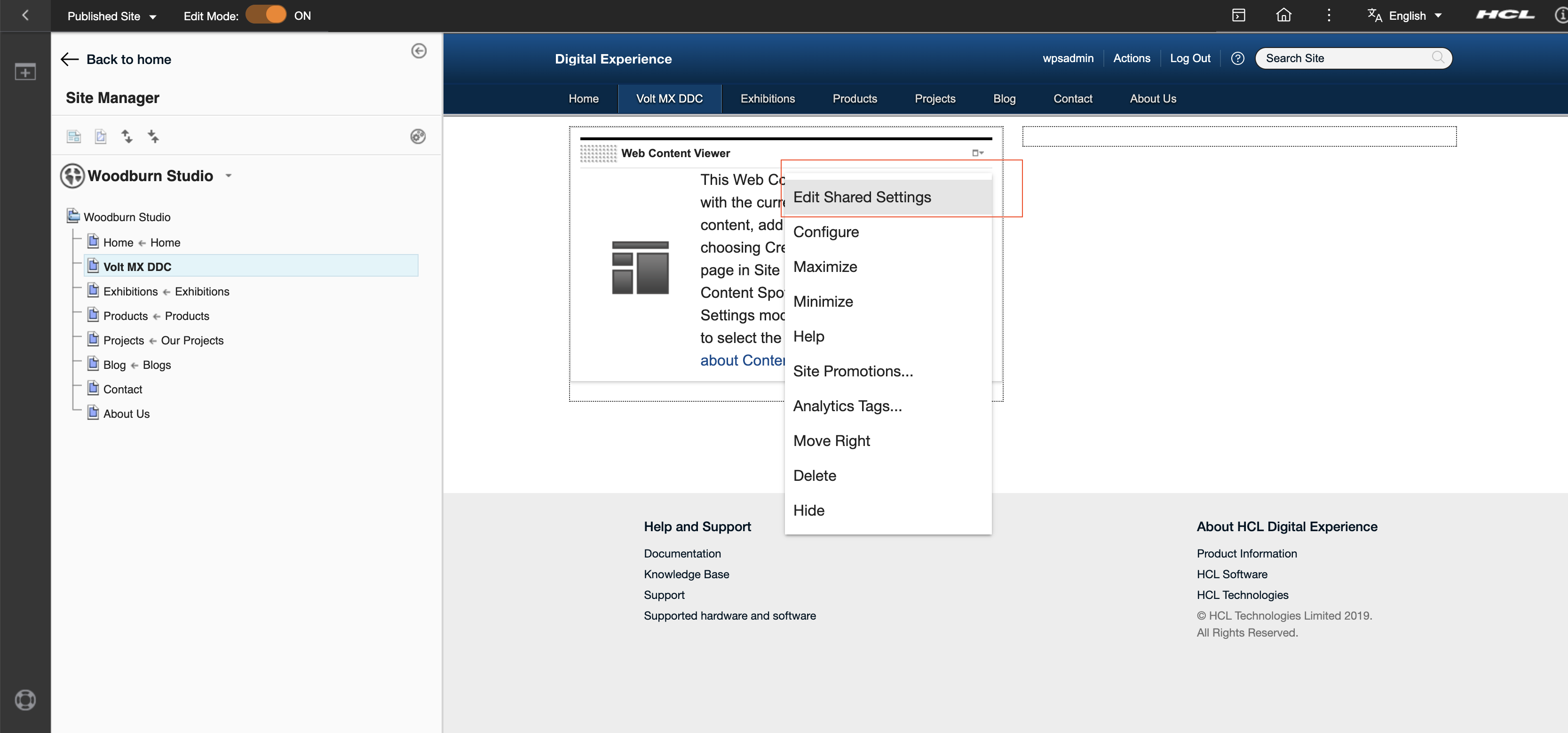

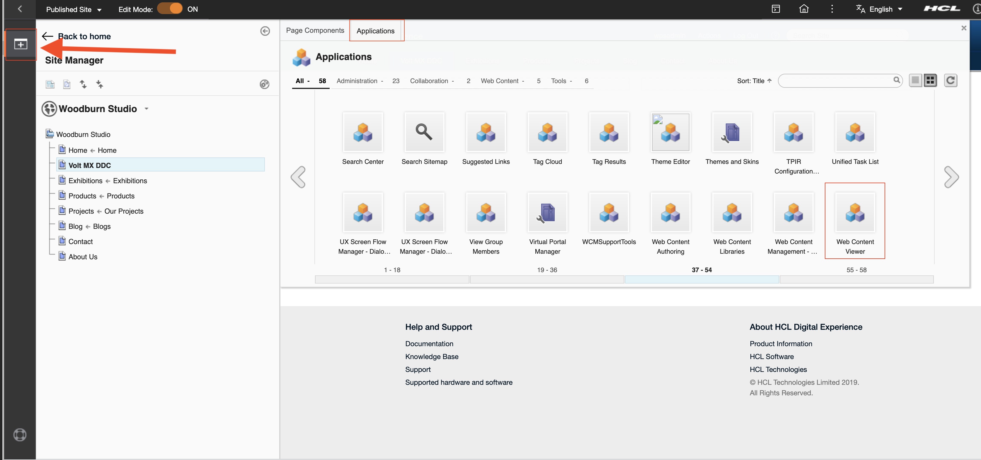

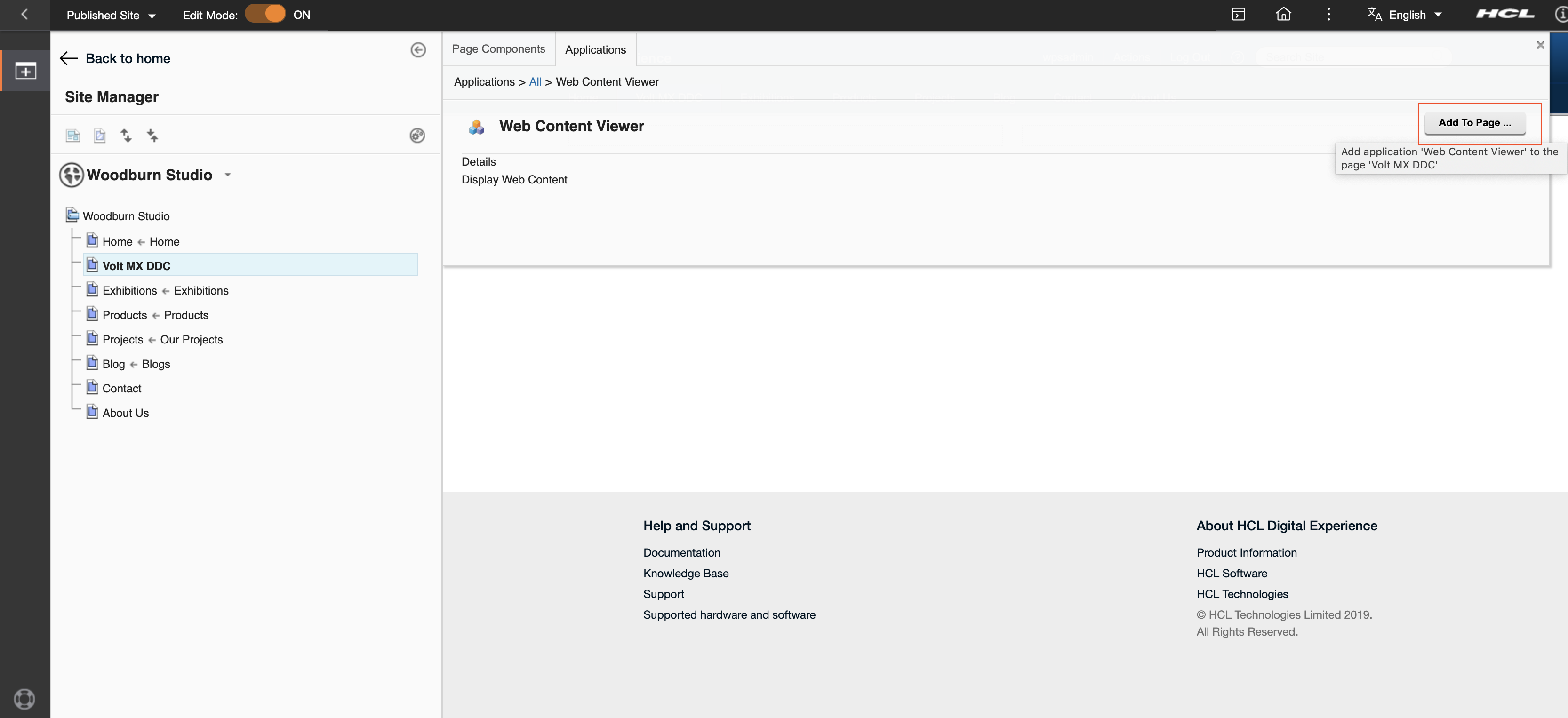

  1. Go to any page (for example, Volt MX DDC) and enable Edit Mode.
  2. In the site toolbar, click the Add page components and applications (plus) icon. Then click Applications and add a Web Content Viewer on the page.
  3. Click the Add To Page button.

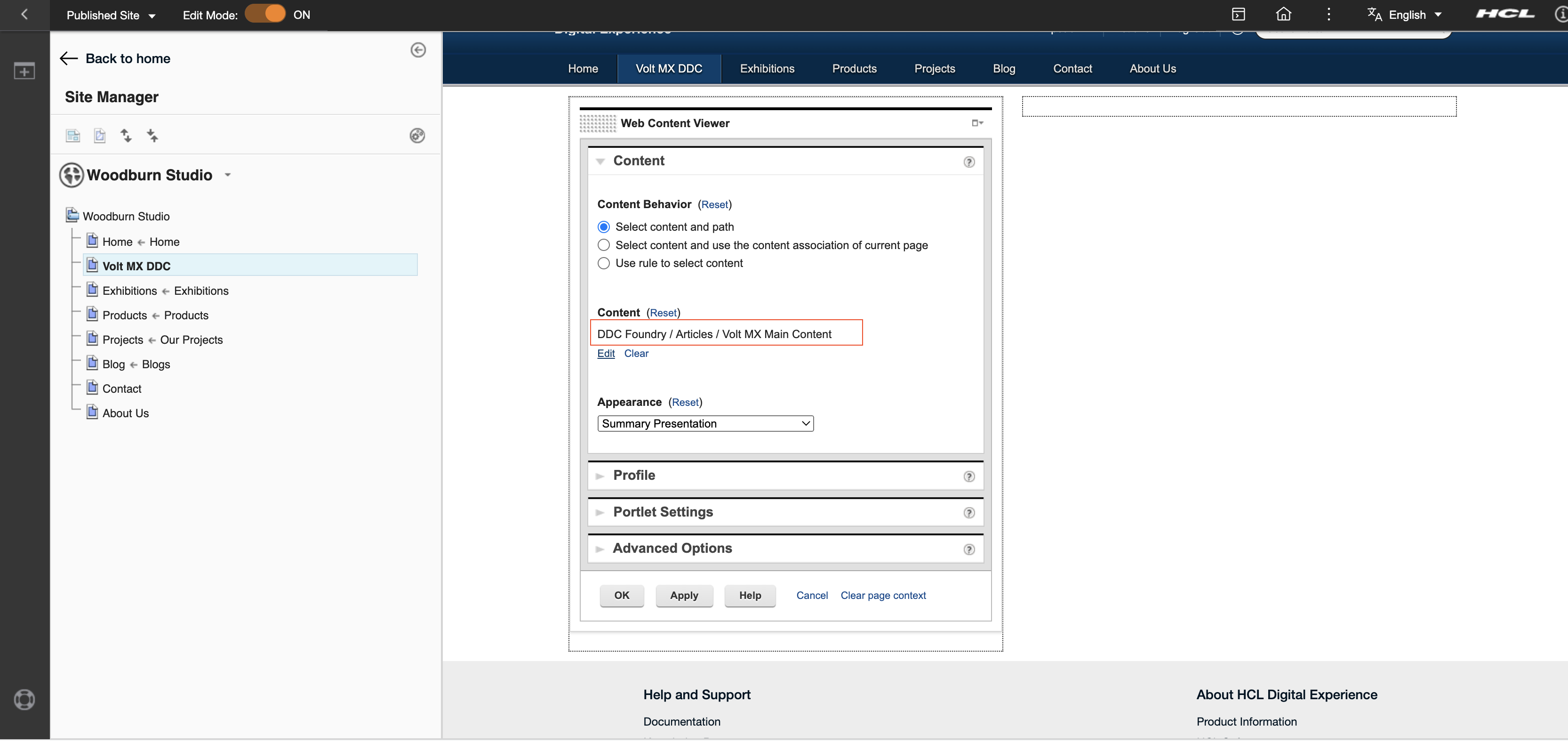

  4. Inside the Web Content Viewer, click on the upper right dropdown button and select Edit Shared Settings.
  5. Under Content, change the mapped content to the Content item you created in Creating a Content item.
  6. Click OK.
    The following output page is displayed.
