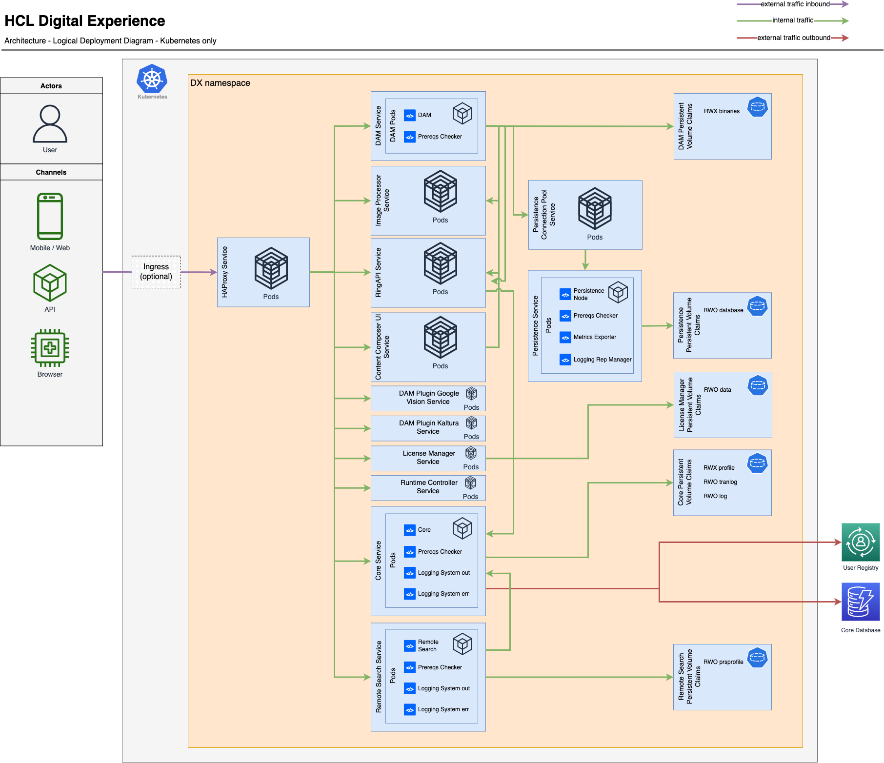

With HAProxy replacing Ambassador in HCL Digital Experience (DX) Compose deployments, it is easier to use a custom Access Layer in front of DX to handle advanced requirements for routing, proxying, and other similar use cases. This document explains how to leverage an external Access Layer alongside HAProxy as the internal reverse proxy and load balancer. Sample configurations for some Access Layer controllers and steps to implement them in a Kubernetes environment are also provided.
Note
  • HCL DX Compose does not ship any Ingress or Gateway Controllers to reduce its deployment footprint in any Kubernetes cluster.
  • Implementing an Ingress or Gateway API for use with a HCL DX Compose deployment in Kubernetes is optional. Consider its implementation based on the Kubernetes cluster’s requirements.
  • These configurations are not proposals, and HCL does not provide official support for them.
Access Layer Implementation
Access Layer for DX Compose
You have two options for implementing the Access Layer in the DX Compose deployment: Ingress and Gateway API. Choose the option that fits your specific needs and preferences.
Ingress implementation for DX Compose
Refer to the following steps to implement a generic Ingress on your Kubernetes cluster for use with HCL DX Compose. The actual implementation might vary depending on the cluster's setup and configuration.

  3. You can configure the connection between Ingress and HAProxy to use either http or https for the internal traffic. For more information, refer to Configure HAProxy networking.
  4. Define an Ingress resource that is used to configure the routing rules that point to the existing deployment of HAProxy as the internal service. You can configure a host in the Ingress resource to ensure all of the requests received by the host are handled by <helm release name>-haproxy. A secretName is passed in the tls section to allow the Ingress controller to serve https traffic.
    The following configuration maps the root path (/) to the HAProxy of DX Compose. If there are other applications in the cluster handled by the same Ingress controller, their paths must be specified explicitly. All other requests are then handled by DX Compose.
